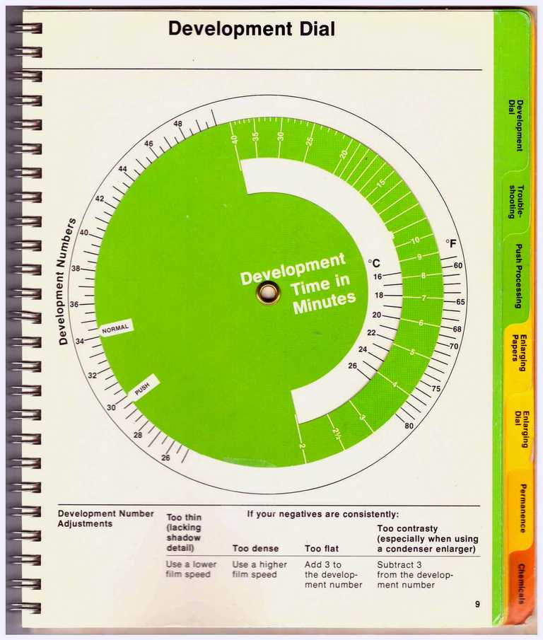

I use the Development Dial in the Kodk Darkroom Dataguide, and it has always served me well.
Could you check few times with that so we could see if there is difference to Ilford method?
For example 6 minutes 20degC -> 21degC and 20 degC -> 24 degC ?
I'll do this tomorrow morning.
I've been using the developing dial calculator in the Kodak Darkroom Dataguide since my uncle gave me one when I was about 14, and I'm sure it is less variable / more accurate than other parts of my developing process. I live in a place where the tap water temp changes a lot over the year, so it's very helpful.
For 6 min at 20 deg C -> the Kodak dial says 5.5 min at 21 deg C, and 4.5 min at 24 deg C.
Bear in mind that timing development accurately so as to worry about the difference between 5:30 and 5:46 as mentioned above in post #36, would require strict control of matters like your pour-in and pour-out times. I develop in daylight tanks and don't think I can control this to 15 seconds, plus frankly I just don't care to. I prefer dev times over 6 minutes so I don't have to get stressed about matters like this and how long it takes to get the stop bath into the tank.
(I have about four Darkroom Dataguides now - some people collect Leicas, I collect Dataguides. The developing calculators are all the same AFAIK, but the stock photos on the delightful examples of long-discontinued paper surfaces are different.)

Nothing like a photo...
Timeless and useful tool. Take care of it. Now I gotta look for one on Ebay. :wink:
Warning - many of them are in editions that include a whole bunch of different Kodak printing paper samples. Looking at them may make you weep!
Does it come with instructions? I have to admit that I don't understand that at all :smile:
It's very simple in practice. Understand that the dial - the green part in Matt's photo - rotates with respect to the white page. You look up a development index in a table, such as 40 for Tri-X in D-76 1:1, or 33 for Panatomic-X in Polydol. Then set the "normal" arrow to the development index on the left, and read off time vs temperature on the right. If you don't know the development index but have a manufacturer's recommendation or a time for 68F/20C from the Massive Dev Chart or whatever, you can set that time+temp on the right and infer the development index, and read off different time/temp combinations.
There are some extra tables with numbers to add to the index to adjust time (basically, adjust contrast) for condenser / diffusion enlargers, paper grades, and so on, but I mostly use it for the time/temp adjustment.
