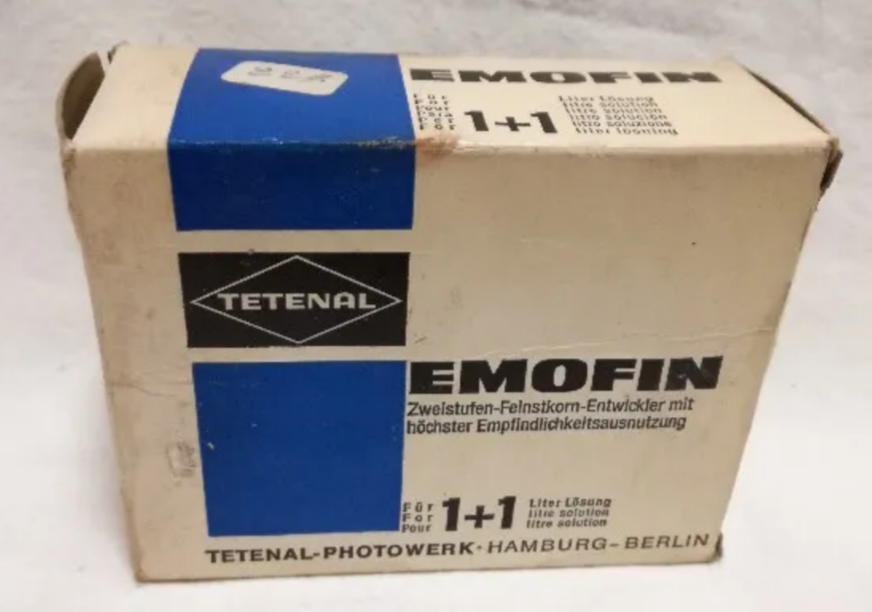

That's a very old package! I don't even remember them looking like that, so it must be pre-1980s because that's when I discovered the stuff.

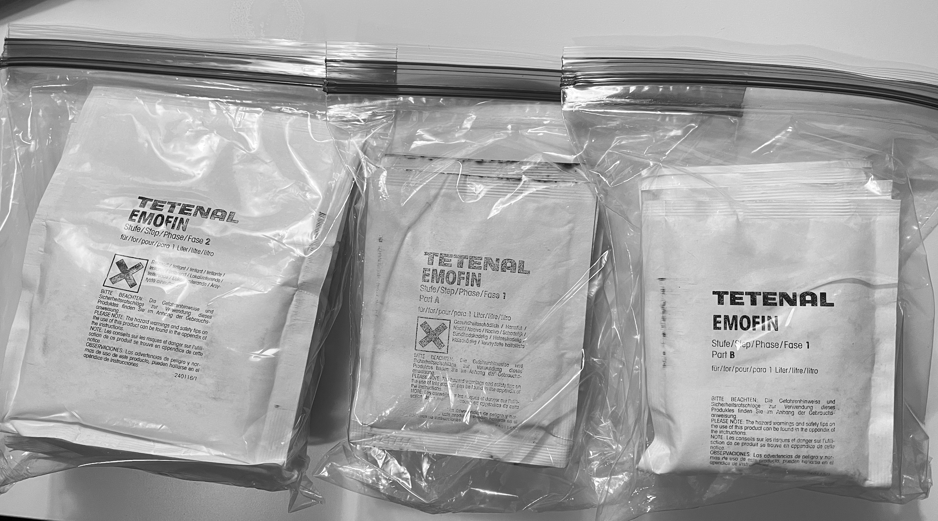

What's inside the box -- three separate packets. An Emofin-developed photo (Original 35mm Across pushed to 160). Excellent developer.
