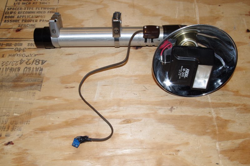

The basis of this mod to an old Graflite was to remove the flash socket and machine a brass slug to replace it
The slug is mounted in the head using the original fasteners and has a claw to replicate the hotshoe for a small old electronic flash.
The batteries in the Graflite are no longer required and are removed and jumpered.

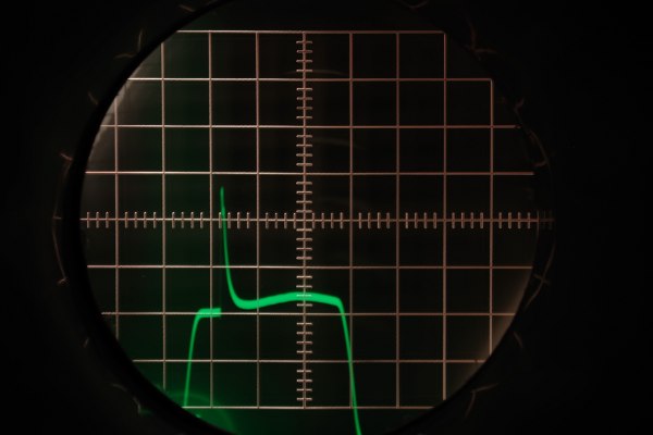

The oscilloscope trace shows the flash firing about 1 millisecond after the shutter is open. ( the background illumination was from a tungsten lamp to show the shutter opening).
