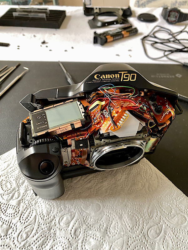

I've had a number of electronic cameras on my workbench over the last two years.
Devices from the 1970s to the 1990s, i.e. from the „cult generation“ that is still well known today and is highly regarded by users and collectors.
Nikon F3 and F4, Canon T90, Minolta X, plus winders and motor drives and the associated lenses, including autofocus.
Simply cleaning electronic contacts can be the solution to the problem.

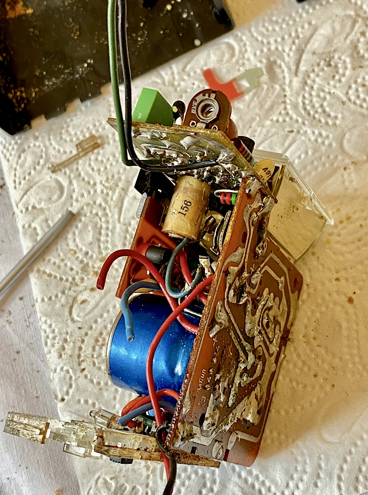

The most recent example for me is the Minolta Autowinder G for the Minolta X cameras, whose electrolytic capacitors fail over time.
Defective electrolytic capacitors are often the culprits behind strange electronic malfunctions or failures. They are available new and are significantly cheaper than their shipping costs.
I have researched this problem extensively on the web and have only found the usual - good - advice to try and solve it, i.e. insert new batteries, clean the battery contacts and clean/lubricate the mechanics.
But nothing about the electronic circuit and its components, that is probably the most unpopular part.
Therefore, these winders are usually sold cheaply because they have a reputation for being unreliable and stubborn.
In reality, they are solid electromechanical devices in which nothing can actually break on its own except their electrolytic capacitors.
Replacing the capacitors is possible and costs next to nothing in terms of materials. And you have a device that will probably work for further decades.

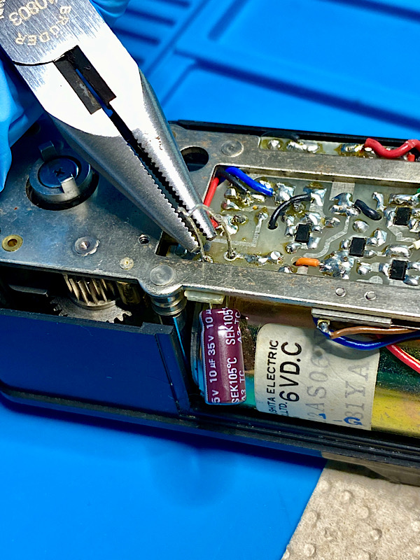

Recently got a Pentax Espio 115G of which the flash didn't work, it kept charging but never became full. Since it's an auto everything camera, I had to disable the flash every time I switched the camera on before it would allow me to take a photo, even without flash (which I seldomly use)
Opened the camera several times to try and solve the issue, starting with replacing the electrolytic capacitor. When that didn't work I started looking and measuring deeper inside the camera. Eventually I found a SOT23 transistor or mosfet to have one pin floating on the edge of a flex pcb. Soldered it back in place and now it's fully functional again.
I removed the battery and measured the voltage across the capacitor with my multimeter and waited until the voltage was safe enough to handle and to prevent causing damage with my soldering tools (below 10 volts or so is perfectly safe to touch, but I waited until below 2V or so). That took a minute or two every time, but safety first...

So what was the reason you didn't replace the elcap with tantalum in your winder repair? Was it because client didn't t want to bear the extra cost?
I am always my own customer 😉
The new electrolytic capacitors should last a long time, I hope they are made with more reliable materials.
Therefore, I saw no reason to use tantalum capacitors.

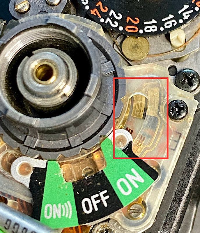

This may not be the right thread to ask in, but would anyone happen to know if a Minolta Maxxum/Dynax getting stuck in Program mode is a common issue? I've got a Maxxum 400si that has a mode dial that doesn't do anything, and it's always been stuck in P mode. The lens I had for it eventually broke, because whoever designed it decided that making the mounting portion of the lens of of thin ABS plastic was a good idea. I never got a new lens because I figured why waste the money on what is essentially a giant point-and-shoot.
But if the problem is just corroded contacts, then I'd be able to get it to work again and then it'd be worth buying a new lens for.
The wisdom to make plastic mount is also shared with Cannon. There are few cheap kit EF lenses with polycarbonate mount
Maybe a dash of electronic cleaner will help if the switch is not sealed against moisture.
Otherwise, the repair manual should show how the switch is constructed/reachable.
