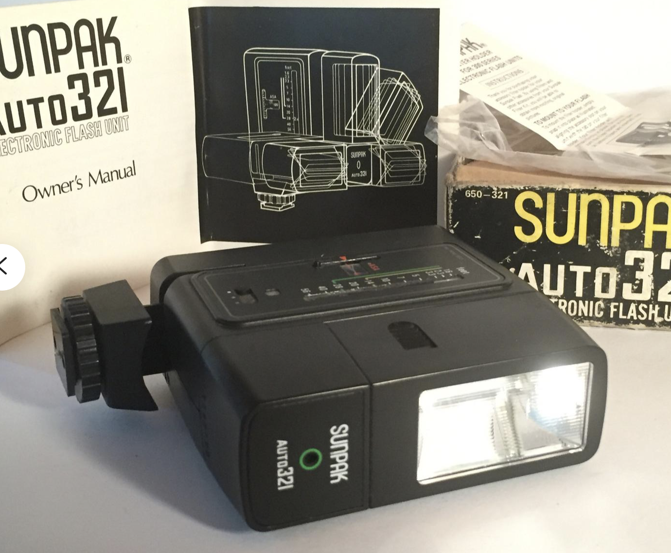

I got a Sunpak flash like this in the 1970s when I got my Yashica 124g and it still is working fine. The rotating shoe lets it stand upright on the side of the camera. I had to trim the shoe so it slides on from the front.
Otherwise just about any pre-digital flash with a sensor on it should work with film cameras. I have a small collection of Rollei, Nikon, Sunpak and Metz units for my film cameras.
Non-TTL Auto flashes are pretty inexpensive these days, so I almost never try to fix them...just buy new ones as needed.
I am now always using Eneloop batteries in all my flashes. Those batteries don't discharge when they sit, so the flash is always ready to go without charging.
That’s exactly the style of flash I’ve been looking for the same reason as you, mounting on a TLR, in my case Mamiya c33 which has the flash mount pointing out to the side. I’d like to be able to rotate the flash head so that it points up. Do most of this style of flash allow you swivel the mount to either side of the flash?
I want the flash to have a built in pc cord, be a thyristor style and have adjustable output (full, 1/2, 1/4...etc). I think the Sunpak Auto 322 fits the bill.
A relatively small subset of these type of flashes work this way. You will find more flashes that are either fixed or swivel about their centre.
I use a left hand grip with my TLR, and can therefore put the flashes there.
