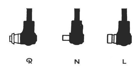

Here a sketch out of the manual of an earlier Rollei flash, indicating the plugs which that locking socket accepts (they only differ in the shape of their outer tube):
from left to right:
Rollei - PC - Leica
The only people that supply these cord today are Paramount-as far as I know nobody else makes them anymore.
As said I only remotely remember to once have come across in the 70s something like the type Rollei plug and having filed off that rim to use it in a standard PC socket.
However I meanwhile own several Rollei flashes with that plug-lock.
Yes, Paramount still offers it.
Though the Rollei flashes are "downward" compatible and most other appliances with PC-connectors worked without such lock anyway. Otherwise a rubber ribbon or a tape would work too.
Paramount also offer a "Honeywell" designated plug. It is similar to the Rollei one, but the rim is further back. Thus this plug in contrast will likely couple to standard PC-plugs too.
