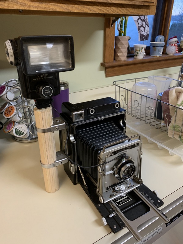

Whipped this up today, but needs to be refined a little. It's not the best but it's lighter than my Metz 45 CL3. I am considering getting the graflite jr and removing the flash part and inserting this but the wood is 1 1/2 inch which is too thick so I would have to sand it down. I also had to put some Moleskin padding so the clamps were tight enough.

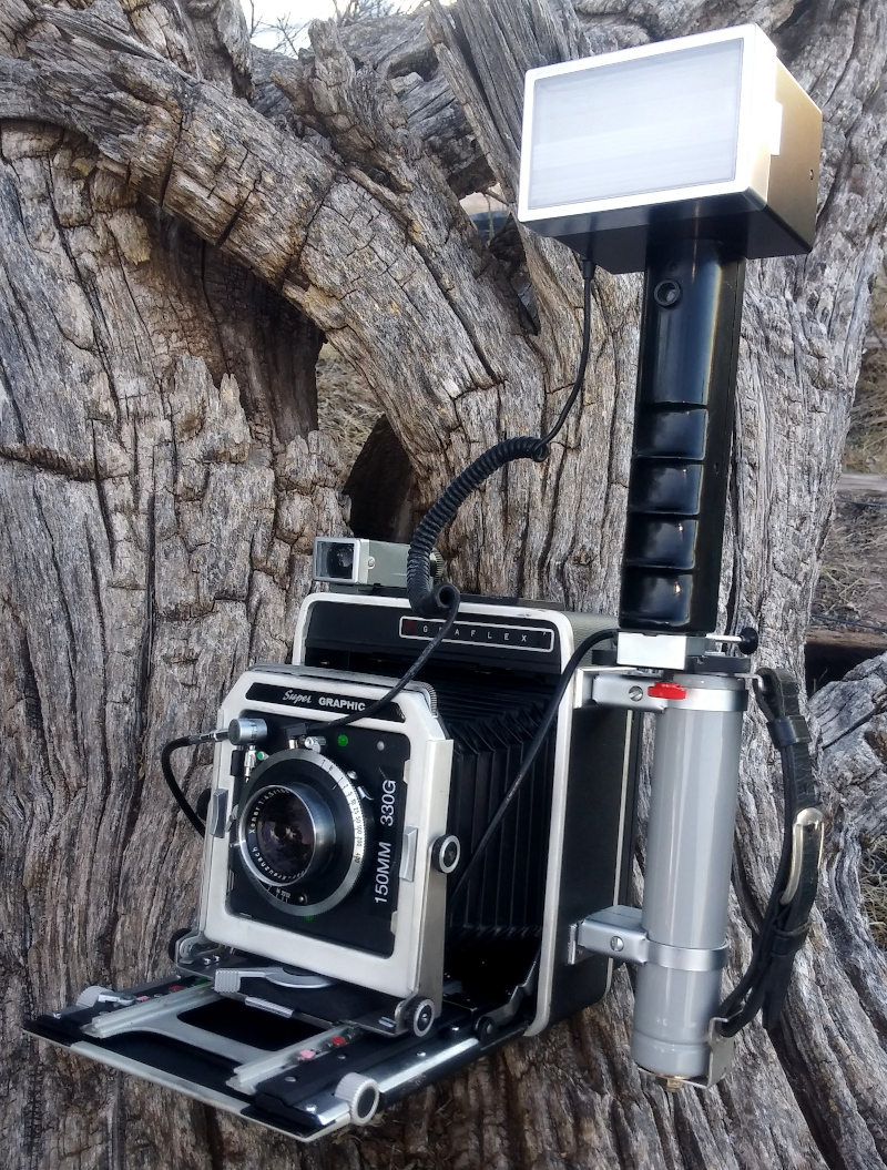

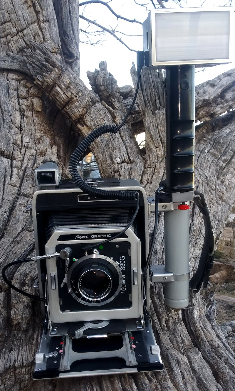

Waaaay back, when I was Photography Editor of my high school newspaper, we used a Speed Graphic to shoot night football games on ASA 1250 4x5 film, and we used that camera with a Stroboframe electronic flash unit like this one (which was powered with 450V battery pack)...
The head just screwed on top of the handle, so you could simply screw a more modern flash on top using the same 1/4" thread that held the Stroboflash head on top. Like the Quantum Q-Flash unit.
Yoiu can still find Graflex flash components, like this one...

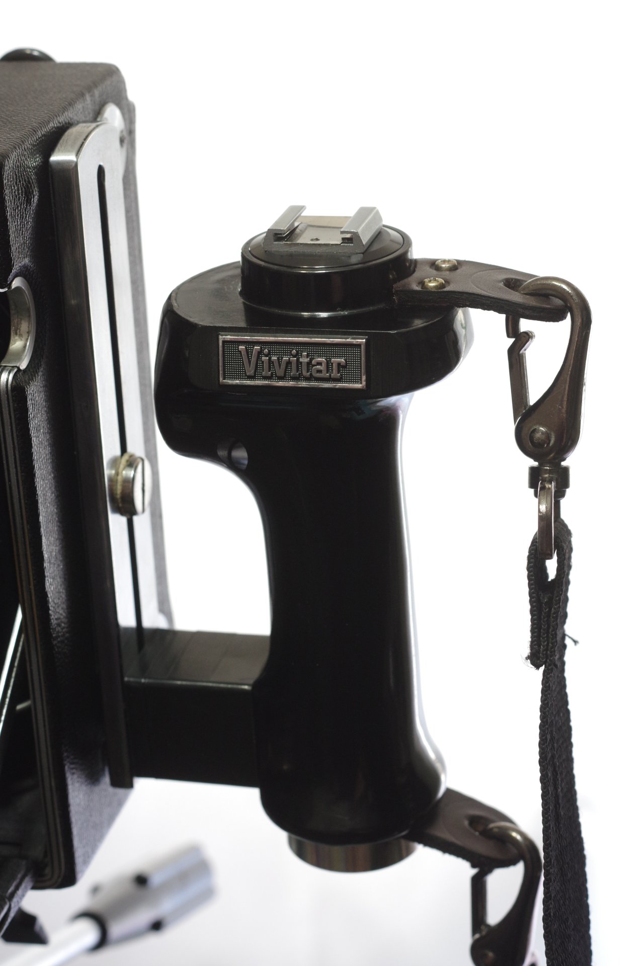

@campy51 You have got the right idea. I did the same with my metz 402. Yes it's still working. I'll try to remember to get mine out and shoot a picture.
Here you are 😉

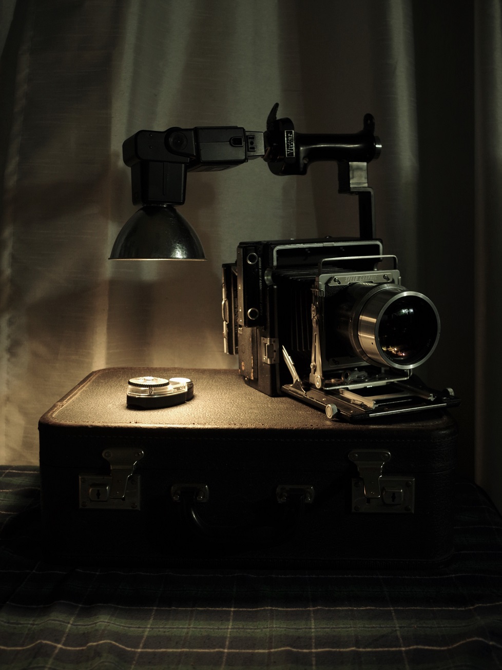

Here I bolted a cold shoe onto the top of an aluminum cap which fits tightly on the battery tube of a graflite. I think the cap might be for plumbing, or perhaps scaffolding.
Frankenflash by Howard Sandler, on Flickr
I will look for a cap and try it. I prefer the graflex handle over the wood.
@hsandler. That looks real nice. And having the flash up high like that helps with red eye and shadows.

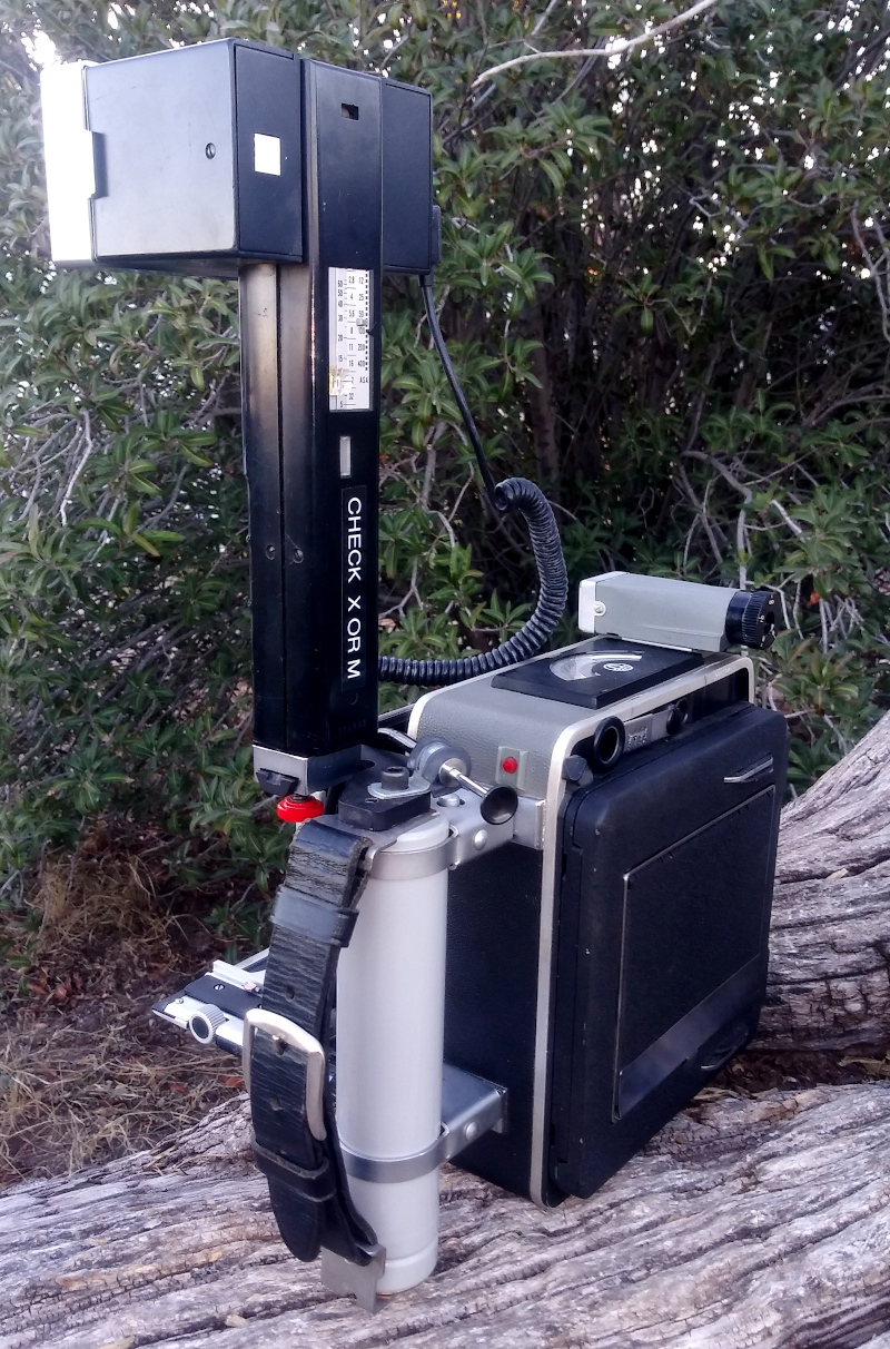

My latest attempt to address this common goal actually was what you suggest, a more circular reflector. I bought a 1956-era strobe, Heiland Strobonar 62-A, but it's going to take a lot of restoration to get it working. Capacitors seeem shot and the vibrator may be also. Nothing happens with DC and with AC there is buzzing and hot capacitors. Although the ready light illuminates... no flash, so I'm wondering if the flash tube is faulty. Round strobe that was designed to fit on the Heiland/Graflex flash handle; Seemed like a good thing to try. I might not have the knowlege to actually accomplish that, though. Perhaps that was a bad choice but at least it was extremely inexpensive.

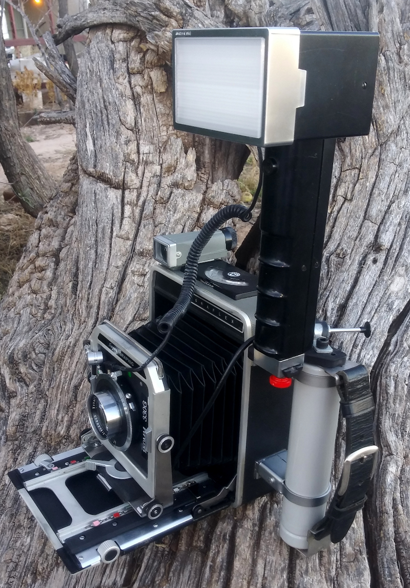

The grey tube is a honeywell part for mounting a flash that came with a 1/4-20 female brass insert pressed into the plastic. I removed it and drilled a hole and used a bolt and nut. The bolt and nut holds a stroboframe metz adapter, part of a graflex flash bracket and a P-clamp that holds my cable release. The bottom is one of those rubber freeze plugs that you should never use except in an emergency. It holds the other half of the Graflex flash bracket bent at a right angle to install the Graflex side strap. I use the diffuser for short distance and remove it for longer distance. This is also compatible with the Metz 60 and 45 potato mashers. The 402 is very light as is the 60 ct.

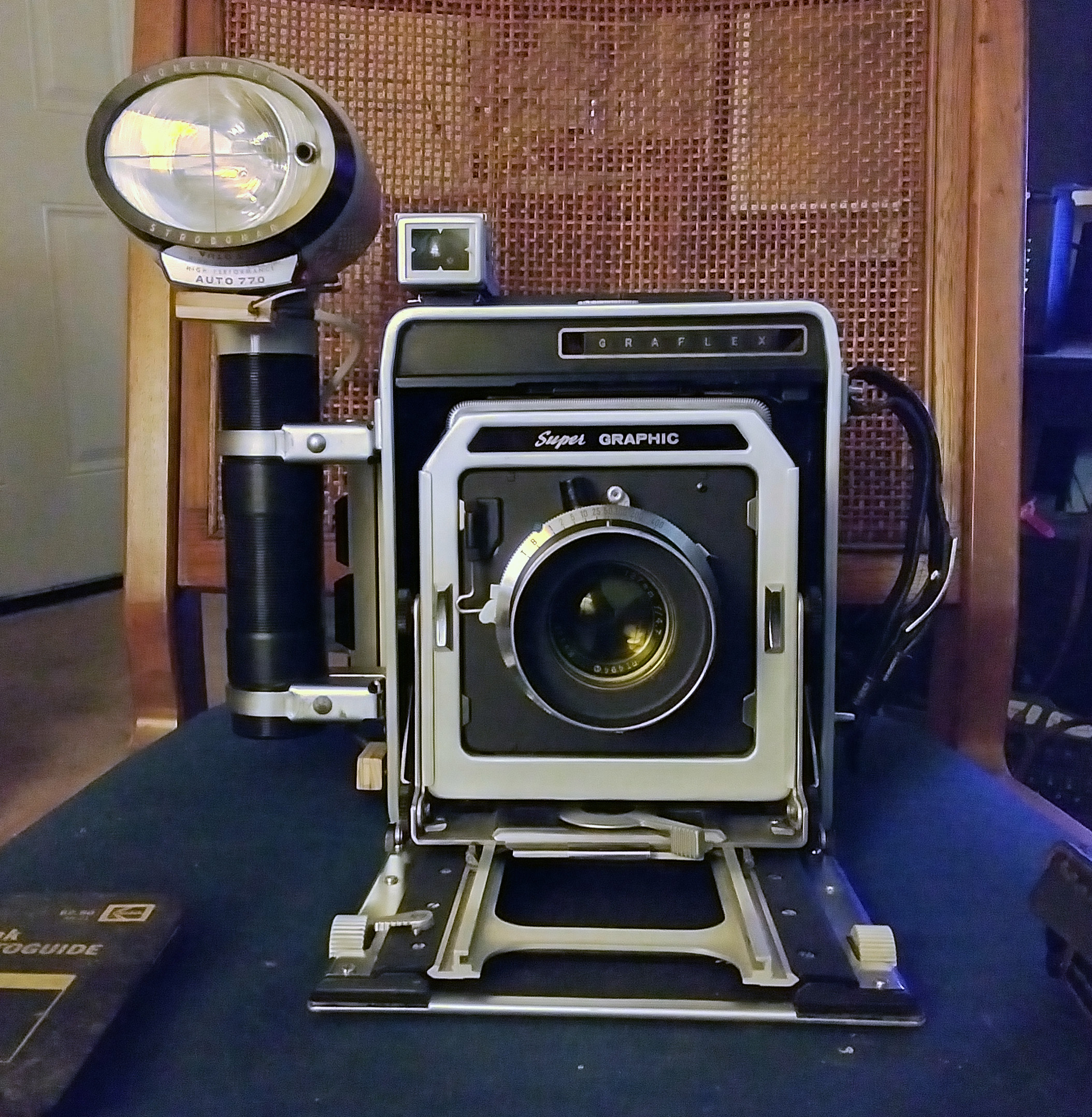

Like this. It is a Honeywell Auto Strobonar 700 I picked up inexpensively and rebuilt the battery pack with sub-C NiCad cells, easily available. Recalling the context of the period when Honeywell was marketing these models, Graflexes were still being used regularly. The Strobonars were a drop-in replacement on those cameras, as long as they had more modern shutters with a X sync. The Graflite mounting rings work perfectly for them.
