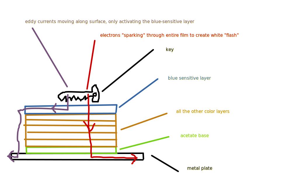

Draw a cross-section of the film with the object on top, then draw lines on possible pathways of the electrons. Take into account eddy currents along the surface. Maybe it'll dawn on you then why the gradient goes from white to blue.

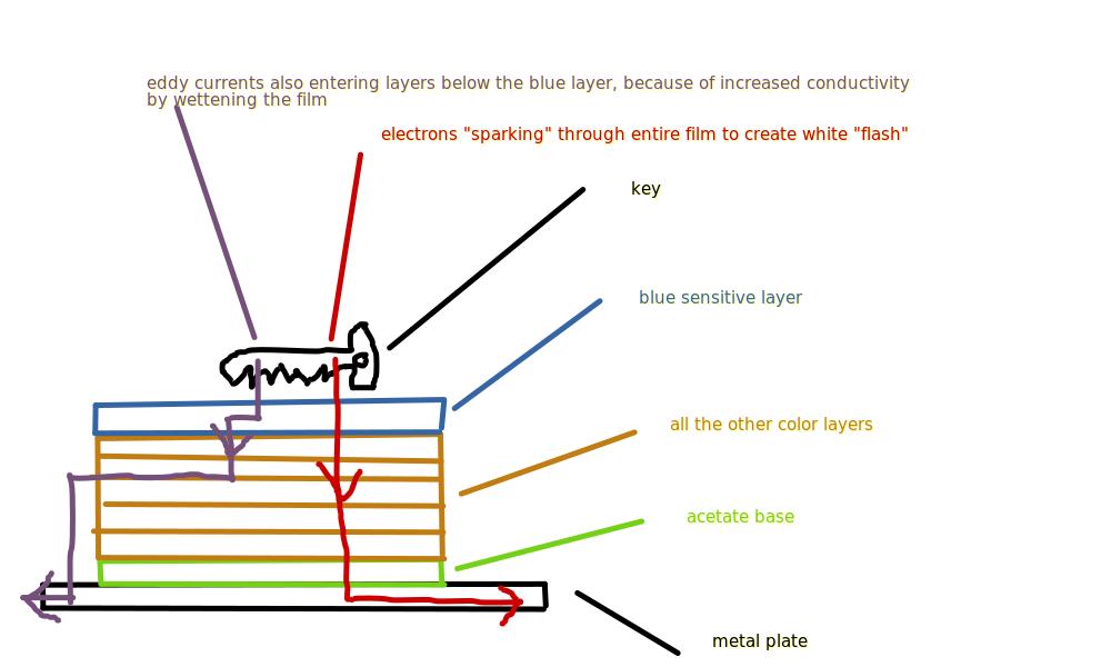

If you want other colors, flip over the film.
Give it a try, see what happens; have fun.
There you go:
The key of course does make contact to the film surface, but i drew it hovering for better visibility.
Right, so now explain the gradient from white to blue in the image in post #1. Then relate that to your hypothesis of the alleged isolation offered by the yellow filter layer. If that hypothesis and your drawing above would be correct, there would be no cyan tinge in the midtones between deep blue and white, nor would there be a slightly magenta tinge on the edge of the pure white parts. These color artefacts suggest that your diagram is inaccurate, in particular with regard to the implied binary distinction between the red and the purple pathway.
Another issue with your diagram is that it assumes that the eddy currents travel across the surface of the film and then somehow jump the entire emulsion stack at a random distance from the contact point. That isn't very plausible. I suspect this error is due to the false assumption that the metal plate alone forms the other electrode. In reality, with high-voltage discharges, pretty much anything will become an electrode.
In reality, the current fans out in all directions from the contact point. If your diagram would be correct, the image would be a duotone existing of a sharply defined pure white form surrounded by blue artefacts, with no midtones. Yet, the midtones are there, and they suggest that there's no insulating effect of any of the filter layers.

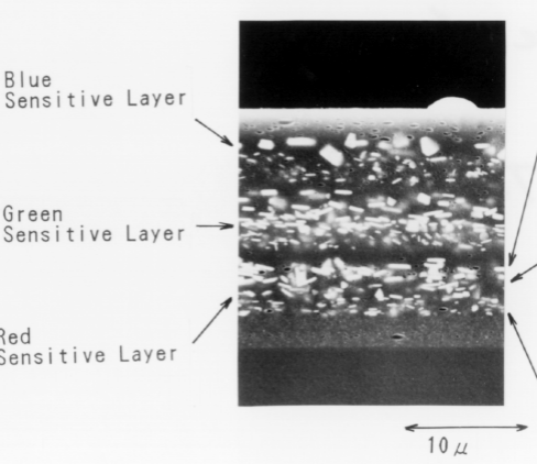

Again, this supposed insulating effect makes little sense if you look at the actual emulsion stack and the actual geometries involved. Here's an example:
(source)
As you can see, it's exceedingly unlikely that this filter 'layer' (which is in reality a poorly articulated zone, rather than a discrete layer) would constitute any significant impedance in relation to the remainder of the film stack.
The gradient from white to blue does imply that the electrons spread in the blue sensitive layer first, "searching" for a "gap" to spark through the entire film. Once this "gap" is found they move vertically through the film without spreading much into the other color layers horizontally.
Because of that every white "flash" is surrounded by a larger blue area, but (nearly) no other color.
For better visibility i did not draw the electrons spreading on the blue layer around the vertical "spark through"; in reality both pathways, red and purple, should also overlay. In my diagram i wanted to separate both effects, "spark through" and eddy currents from each other - as there are two different effects occuring.

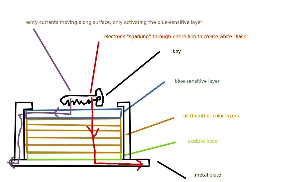

I still do assume that the film is held flat by a metal plate similar to the film-insert for a glass plate holder, see post #19. I assume the metal plate to have metal slots that go over the film surface at the edges of the film.
For simplicity i left out these, in reality the electrons of the eddy current do not have to jump through the air but just move to the end of the film to make contact to the metal film holder.

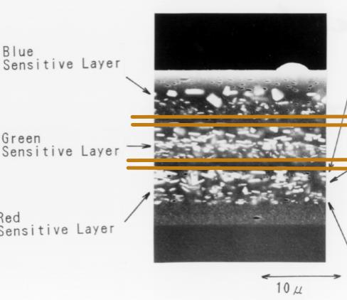

There are spaces between the layers where basically no silver grain is placed:
The space is small, and it is narrower between the blue and the green layer, but it is there - and that`s where i see fewer conductivity.

That`s how i assume the film is being held flat, but it makes the diagram more confusing:
The spaces between the color layers is small, but there are no silver crystals. It`s easier for the electrons to move along crystals than gelatin, therefor these small spaces between the color layers must be harder to pass for the electrons.

1: There's the top coat on the film that is much thicker than the color filter 'layers' (zones), but it apparently still allows for activation of the blue layer. If your hypothesis would be correct, then the blue exposure would not happen either because it would be blocked by the top coat.
2: The blue-filtering interlayer as you've drawn it into the SEM image in #29 is wishful thinking in terms of the thickness your simplified superimposed drawing implies. The distance between the pictured silver halide crystals all the way at the top of the blue layer is comparable or even greater than the distance between silver halide crystals at the bottom resp. the top of the blue- and the green-sensitive layers.

1: Indeed. I did not pay attention to the top coat in the cross-section. You mentioned the top coat before, but i forgot to also consider this when looking at the cross section.
2: Yes, i did put the brown lines over some silver crystals to make the silver-free area better visible. It is small, but i wanted to show that it does exist.
Yes, there is bigger distance between crystals in the blue layer, than the crystal-free area between the blue and the green layer. But this cross-section only is two dimensional. We don`t know what the distance to the next grain was this cross-section was cut from.
Also this is a cross-section of a three-layer film. As far as i know that`s a very simple kind of color film. A "real" color film should have about 20 layers or so. Was it possible that with a "real" color film, silver layers are thinner than here?
The term 'layer' as I've said before is a bit misleading. A color film is a package of different emulsions that are coated (usually) in a single pass; how many different physical layers you end up, depends on how the emulsions are distributed over actual coating layers and the degree to which the layers mix during the coating process. The SEM image I posted is representative of a typical, modern-style color film.
