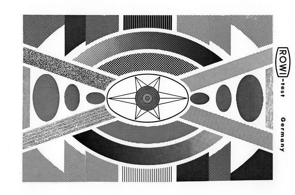

I've used it for 35mm over the last year. It's sharper than any of the EL Nikkor, Componon or Rodagon 50mm lenses I have access to. I don't have the most exacting of tests; I have a 35mm Rowi test negative that I use to compare lenses and apertures. You can really notice the differences in the "chevron" and "grit" (for lack of better terms) areas of the print. I use a glass carrier and the Versalab alignment tool to keep things in line as best as I can.
It's not a great lens at f3.5, but at f4.0 and f5.6 it's quite amazing. Besides the test negative, I'll make comparison prints with different lenses, and it came out on top every time when I did blind tests. I trust my eyes with this sort of thing. As you'd expect, there's very little vignetting because of the focal length. On my Durst 138s I have to use a very recessed lens board (Latub) to use a 50mm lens, and I suspect that contributes to the vignetting I get when using a 50mm lens. So it's a nice tool in the shed for sure.
