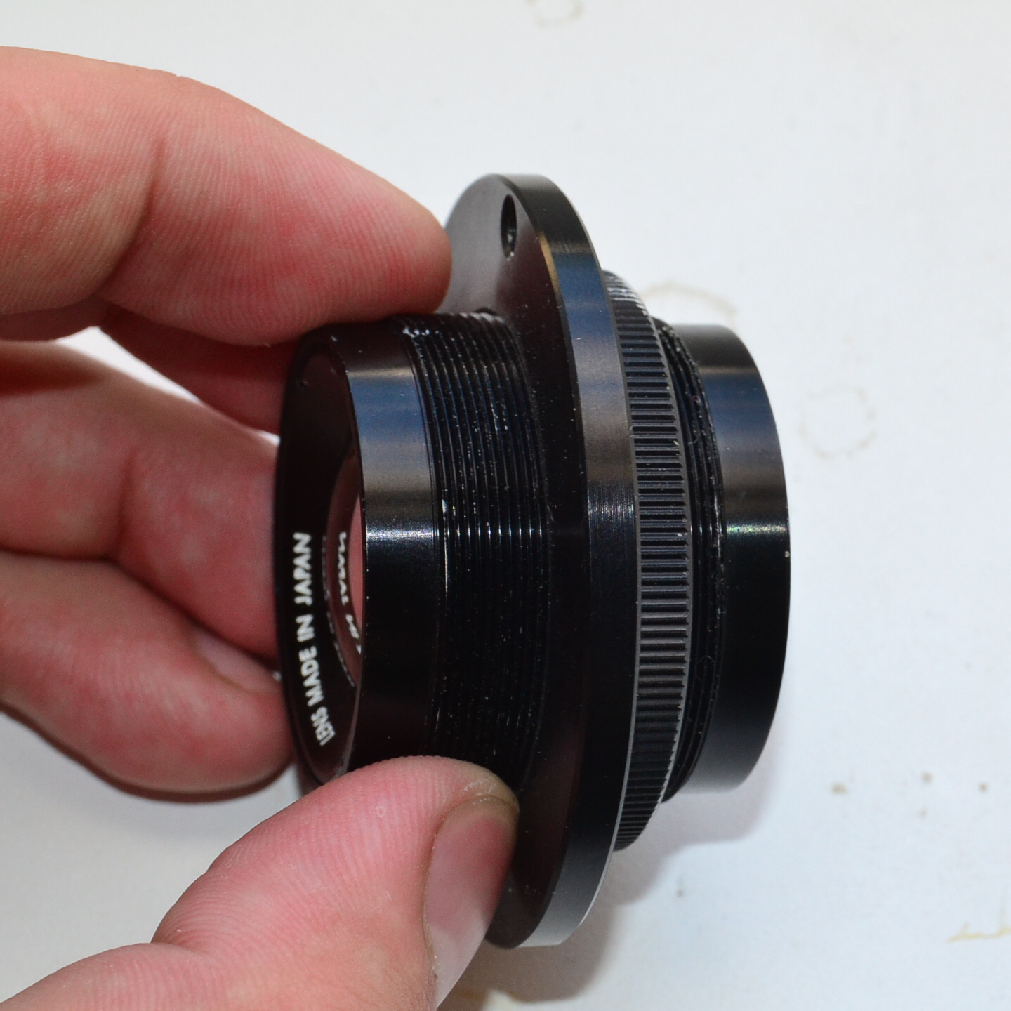

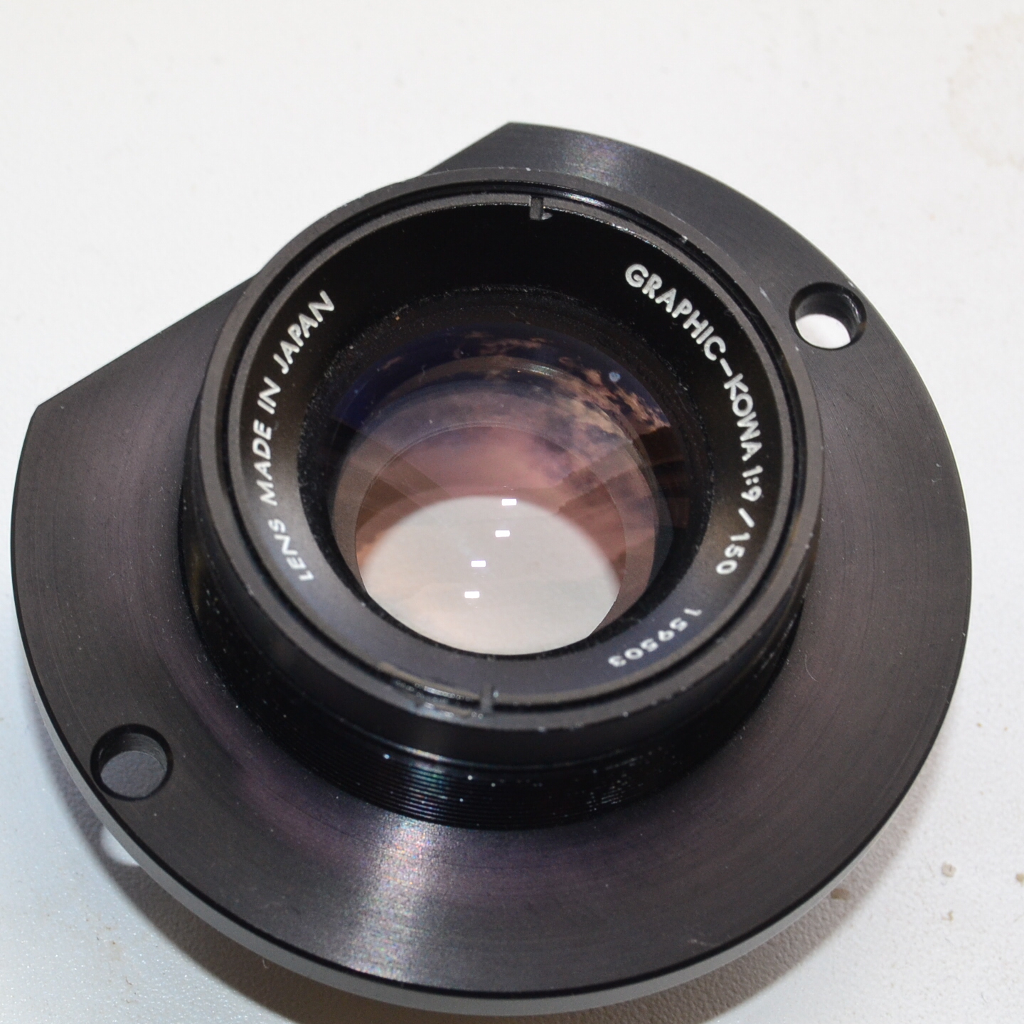

I attached some pictures of the actual lens. The barrel measures 38mm measured from the threaded part for us metric folk. The "screwable" part that looks like a cell to me measures some 33mm. Ignore the wide metal mounting piece, that comes off if I were to apply enough force.
There also seems to be a fixed iris right in the middle, so my guess is that if it really consists of cells, it could gain a stop in a shutter?

EDIT: I managed to disassemble the bastard, it unfortunately is purely a barrel lens, no separate cells :/ just a 38mm thread
Graphic Kowas are a real mixed bag. Some can be completely unscrewed from the barrel mounts, these (in 150mm) are direct fits to a Copal 1 (not 0) shutter. I have one. Others can't be removed at all, and I've seen some where the front cell could be unscrewed but not the rear cell, or maybe it was the other way around.
