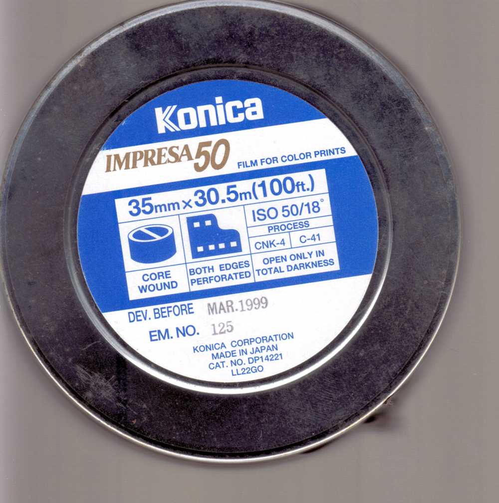

Let's not forget about Impesa 50 -- no problem with freezing.

I have used Impressa before and have a few rolls of this in 120 in my freezer. That said, it was problem prone to getting off colors with this film, even when scanning. It was hard to get colors right. Because of that, I stopped shooting more of it. I may try it again some day, but I wont ever use it for important pictures.
