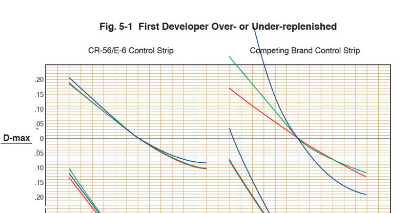

Possibly using Fuji hunt vs Kodak chemicals makes a difference? Here is the over/under replenished spread for D-max
Here is a link to the online Fuji E-6 Manual as a PDF for any interested party.
http://www.fujihunt.com/fuji/fhvip.nsf/files/Manuals/$file/E6manual.pdf
Just take a look at those RGB spreads Fuji vs 'competing brand' In my experience the Kodak test strips were much more sensitive to change (in fujihunt chems) than CR56 or AP44 process control (we ran them all)
Mark

Mark;
The article pretty much showed the opposite but using Kodak chemistry. How interesting.
It is also interesting that they show the data as E6 in the link when they have a competing name for their own proprietary process.
