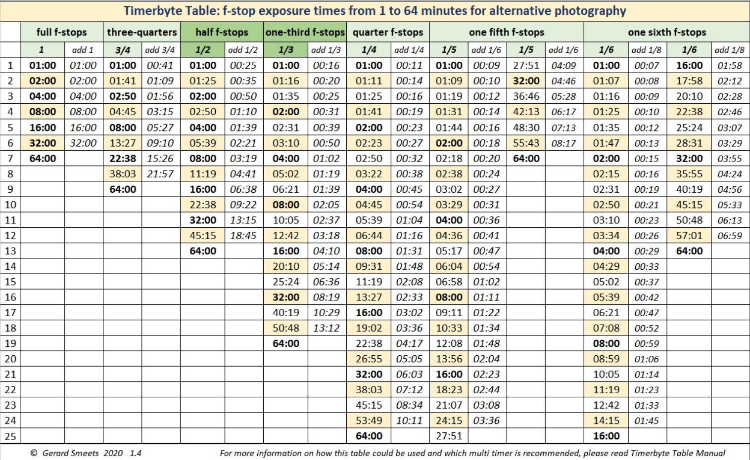

Quick question: does this table look accurate?
In my opinion there's much too much digital manipulation in modern photography. There's nothing wrong with it intrinsically, but people just don't know where to stop, it's like holding a magic wand and apparently it's so hard to just say "enough" and put it down.
You've gone just about as far as you can go with digital manipulation by scanning your slide, you have all the information and you aren't adding anything to it by post processing, just reorganising it so what you see on a screen or print matches your original. If I put your test shot into Photoshop (I don't use Lightroom but it does a similar job) all I have to do is adjust the brightness then press 'Auto Colour' and it comes out pretty much perfect, hardly extreme manipulation or hard work, five seconds in total.
