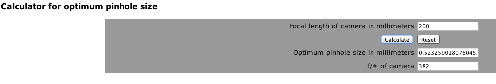

Check that your pinhole is the "optimum" size (should that really be f344?) and then base your exposure on that value, a light reading and the Ilford-Harman pinhole exposure slide-rule.
Pinhole size
This is what I find if it is still relative. Screen Shot 2014-07-09 at 20.20.57.png
