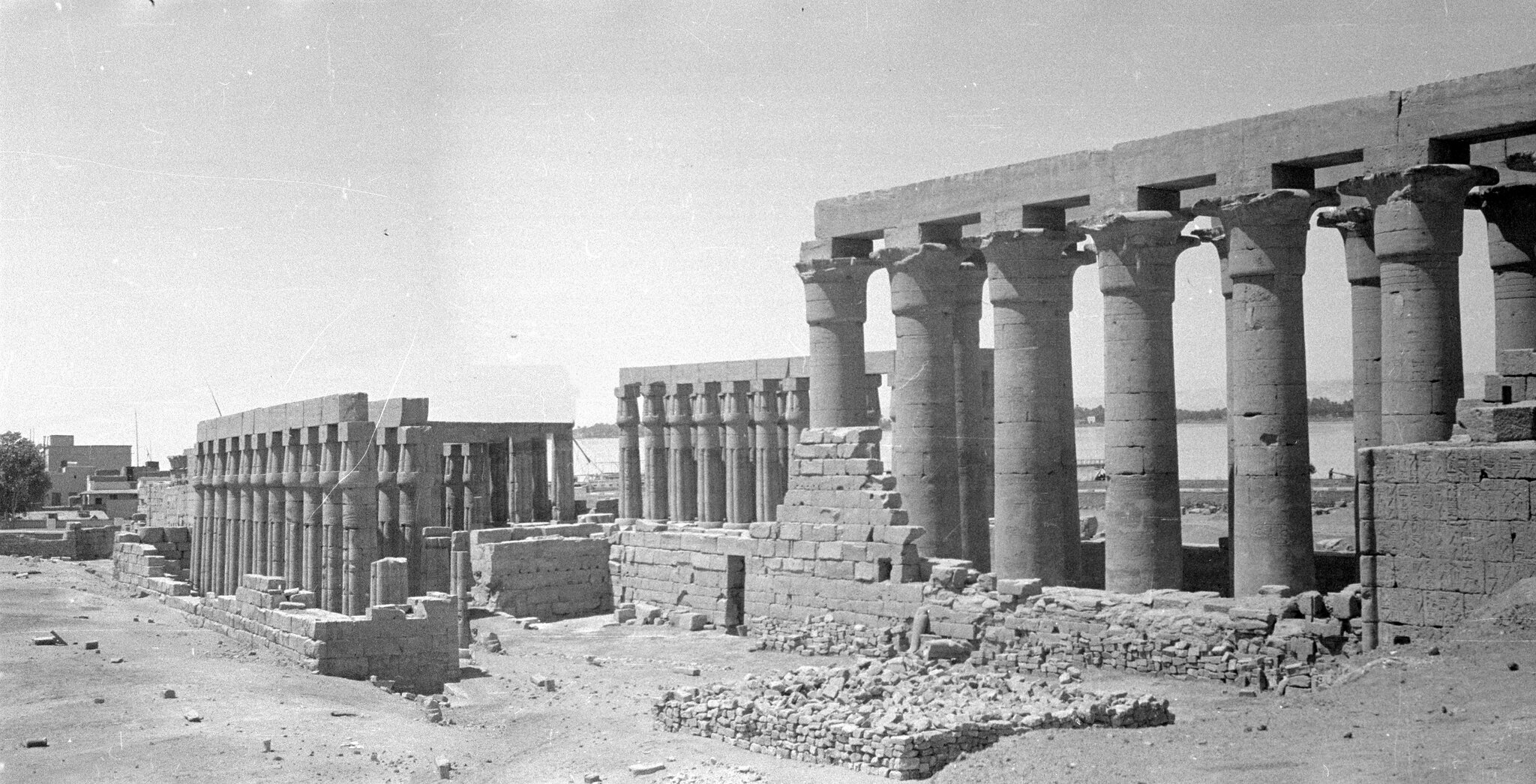

In panorama #3, there are rack drip marks. I see these ALL the time in camera original motion picture negatives in the silent era.
This suggests to me it was processed on in a rack and tank processing system; probably just stapled onto some motion picture film. Bet they were shooting the short ends from a 35mm camera shooting the expedition; very common.
