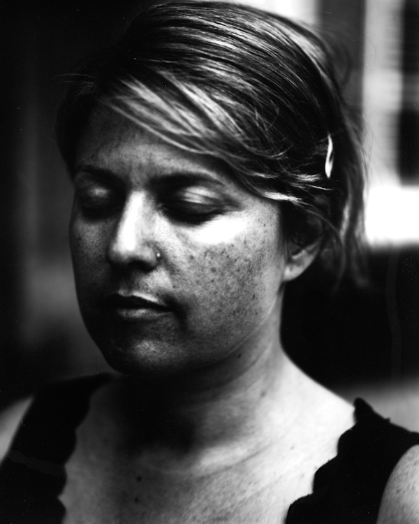

I bought some as well in 4x5, and I'm tempting an entire portrait series done on it, my testing stages are over with it, and it is indeed best rated at 1.5. Another interesting note is this stuff polarizes when attempting to shoot with flash, will post some results of that unique characteristic...
But... It really brings out all the imperfections of skin.
