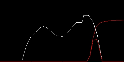

OK - I'm home now, with data sheets, and I've run a couple of simulations!
Here's the response of efke 25, multiplied by a #25 filter.
attachment.php
Thats not good. The simulation doesn't take into account the lighting, or the subject (I don't have data for those), but if you measure the area of these curves, we've reduced the sensitivity by a factor of 12.

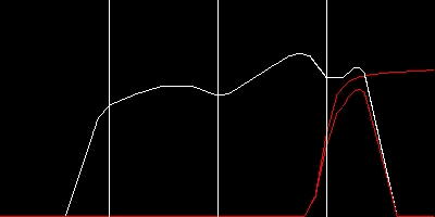

By comparason here's the same filter on hp5:
attachment.php
Here the sensitivity is resuced by about 6 - hp5's red resonse isn't that great, but it's still needs only half compensation that the efke.

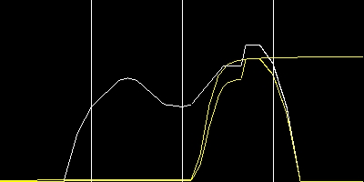

As sugguested by others I tried a #15 yellow:
attachment.php
Now senisitivity is only reduced by a factor of 2.4 - pretty manable.
Of course of theres a lot of light in JUST the right bit of the spectrum, then these factors will change dramatically.
The Filter data I used for these is pretty accurate (and easy to obtain), but film data is much more rough - I had to measure the curves from the Efke and Illford data sheets. If anyone has numeric data, they can share that would be really usefull to me.

Hi Mr. "127" (btw, whatever happened to 000-126? We all know about 007)
I'm not that tecnhical that I could plot this, so I need help intrepreting the graphs. Are you saying that for the first scan with EFKE 25 that the only light passed thru the filter is the small area under the red curve that crosses over the 3rd and 4th section of the graph? All other light is either blocked by the filter or is not rendered by the film?
Well 126 died a horrible death sealed in a little plastic cartidge...
Basically yes.
The white curves are the response of the film vs frequency. The vertical lines mark 400,500,600nm - the approximate divisions between uv,blue, green and red. Efke 25 doesn't respond to much above 600 (ie in the 4th section), as it's basically insensitive to red.
A 25 filter is the top red line, so if "white" (thats a whole other ball game!) light where to hit the filter, only the stuff under the curve would reach the film.
Combine those two lines and you get the lower red curve. That is the effective light which reaches the film and then actually has some effect on it. The area under the final curve is what matters, but for this combination it's not very big.
I compared the area under the original film curve, with the final curves area to estimate an exposure compensation.
However to do this properly you need to take into account the original light, which isn't exactly "white". Ideally you'd have a spectrum for the light, multiply that by the spectrum of the subject, multiply that by the filter, then by the film to give a final spectrum. Compare that with and without the filter, and you have a totally accurate exposure compensation.
Ian
