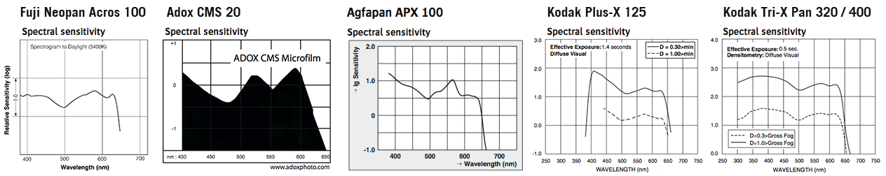

I have never heard of "Orthopanchromatic." I assume it means that you have only slightly darker "reds?"
In the case of Adox CMS 20 Reds are darker since the sensitivity drops after ~ 610nm. You have spectral sensitivity punch in the deep Violet (~400nm), true Green (~530nm) and Yellow-Orange (~590nm).. on top of that, its kind of blind for Blue (~460nm) & blue-cyan (~480nm).

Georg;
Please explain ortho-panchromatic.
Thanks.
PE
ortho-panchromatic is telling us that the manufacturer ran out of red sensitizing dye :D
Typical examples of ortho-panchromatic are Fuji Neopan Acros 100, Adox CMS 20 and whoever join :wink:
Let the attached spectral sensitivity curves comparison do rest of the talk :smile:
