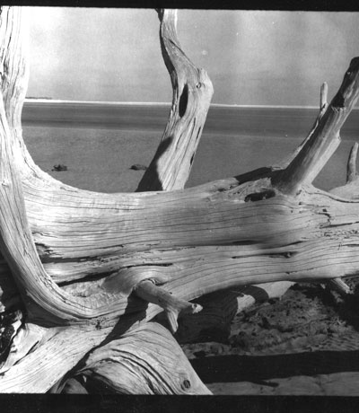

Haven't had any major problem with Efke film till I started using 7X17 format. No matter how I process the Efke PL100 film, I get density bands especially noticeable in even-toned areas such as sky. I may be able to salvage the film for "busy" scenes; but I'm now using J&C 400 for 7X17 format. Its a shame that they are having QA problems, because I really liked the negs I get in 4X5 format with Efke films.

Ron,
This is scan of section of contact print from Efke 100 film. Does this look like a film issue?

Comparing it to my sheets, I would say YES as the defect I see is present in the raw film but similar to yours. The peaks are about 2 - 4" apart, are evenly spaced, they are parallel, and they are at exact right angles to the long edge of the film.
This is typical of a manufacturing defect that I was taught to look for. It is all too common to see when a part is malfunctioning.
