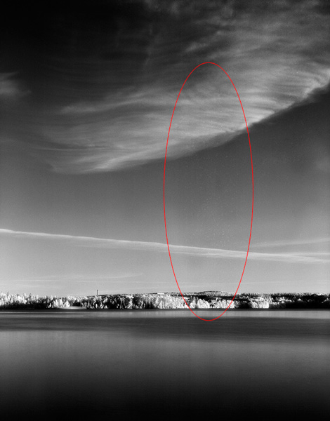

I had to pay out $240 to get these cleaned up by a willing photoshop guru, it just kills me, this film rocks for IR, but this the specks are out of control.

And this one...

Emulsion Number 710635 also exhibits this problem. However it is not on every sheet and in my example it is only in a band. This is 4x5in developed in a Jobo using Barry Thornton divided dev with no pre wash. I have seen the same problem with this batch when using D76 with and without pre wash.

Had you ever considered that it might be a coating defect?
PE
I considered that after the second roll. I guess I could call around to try to find a new emulsion number. Freestyle has given me the same in two orders.
Photo Engineer
Apr 19, 2005
29,018
Rochester, NY
Well, what I have seen so far posted here looks a lot like coating defects. Look at a sheet of film with this problem, from the base and emulsion side, using incident light. Look at an angle for bumps or craters on the surface. Bumps is a positive indicator of coating defects, craters maybe....
