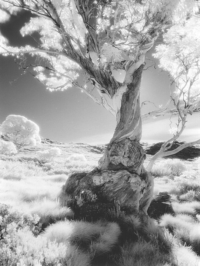

Lone Snow Gum, Kangaroo Ridge
Gelatin-silver photograph on Fomabrom Variant 111 VC FB, image area 21.4cm X 16.3cm, from an Efke IR820 negative exposed in a Mamiya RB67 camera with a 50mm f4.5 lens and a IR680 filter.
The Chinese IR680 filter, 77mm diameter, A$21.28 in hand, 11 days delivery, did not compromise sharpness or flare in this photograph. Of course hiding the sun behind the tree does make a difference!

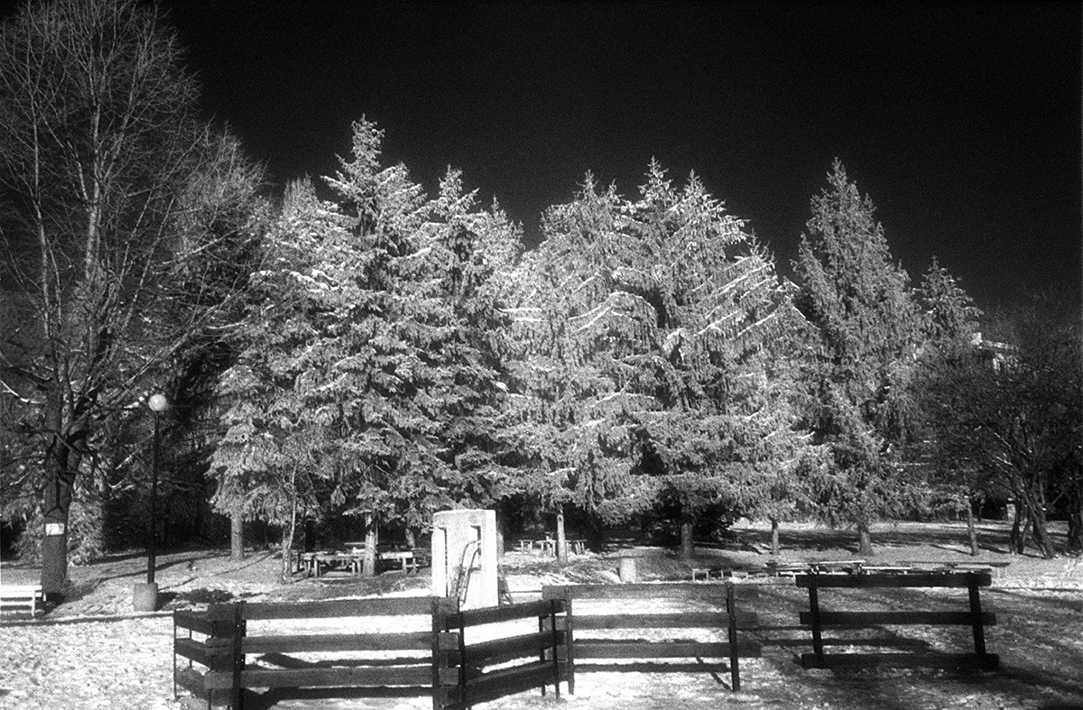

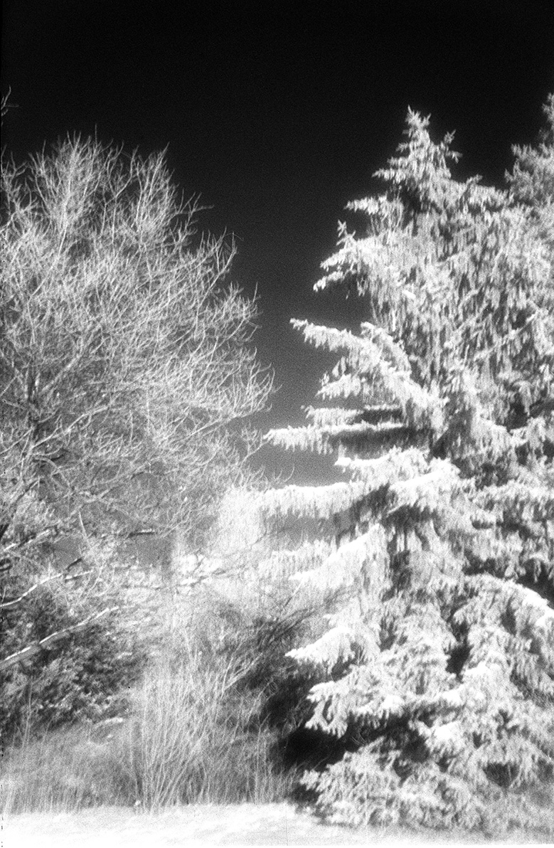

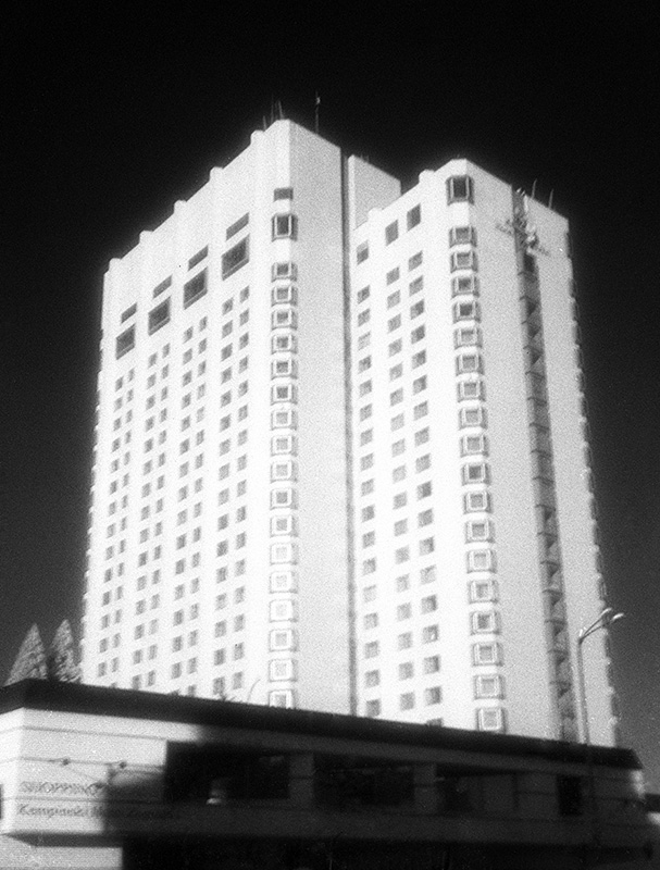

I am attaching a few shots from today, in the snow. Zorki 1, Jupiter 12, Heliopan RG715, handheld, exposure between 1 and 2 seconds
developed in Rodinal 1:100 for 17 min - 1 min agitation, then 1 inversion each 30 seconds for the 1st 9 minutes then 1 inv each 1 min.

If you are hand holding at 1 and 2 sec., it would certainly explain why you are getting more "halos" than at '30. What you are seeing is camera shake, IMO, not haloing.
A wider aperture will give more broad haloing. Narrower apertures will "tighten" the halos.
Peter sounded to me like he was not getting the IR tonality in general, not haloing specifically. My guess would be that he shot the film in overcast weather, shade, or some other situation that is low in IR.
You are right about the overcast weather, lets see what Peter will share
:D I have a very firm arms, the halos are not due to shake or something..
However, You might be right about the apertures. I am just sharing what I have observed as a 35mm RF user.
I would beg to differ. I see more camera shake than haloing in those pictures. In fact, I see very little IR haloing. Though they are very stable looking for exposures that long, nothing in any of them is really tack sharp. "Very firm arms" or not, you are not going to have tack sharp images hand holding at those shutter speeds.
Now, if you had used a wider aperture, you might have more haloing, and sharper pictures. :D
P.S. Did you remember to shift focus for each shot?
