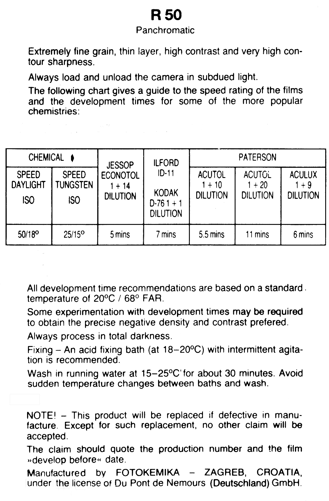

Yes, at one point in the UK these EFKE films were packaged as Jessops own house brand B&W films and sold as 50, 100 & 200 EI emulsions
Jessops 50 = EFKE 25 (old 14)
Jessops 100 = EFKE 50 (old 17)
Jessops 200 = EFKE 100 (old 21)
This is the data for Jessops R50 (EFKE 25):
So as you can see EFKE recommended 100 ASA (EI) in FR24 developer with KB/R14 (now called KB/R25), however FR E24 was a speed enhancing developer like ID68/Microphen, and the lower speed 40 ASA (EI) was in FR 5 a fine grain metol based developer which gave a slight drop in film speed compared to ID-11/D76. So taking that into consideration it's no coincidence that Jessops were selling EFKE 25 packaged as a 50 EI emulsion.
I did my own speed tests back in the 1970's with KB14 and although I've switched to Pyrocat HD I still expose at the same EI, I mainly use PL25 in my Agfa Ansco 10x8.
