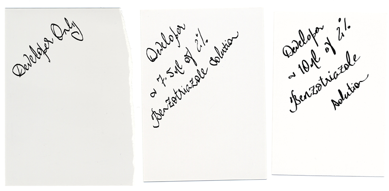

Admittedly the attached file gives no indication of the paper's contrast decline through aging, nor does it tell anyone how much, if any, exposure and/or development increase may be required, but I hope it gives a practical example of the reduction in fog possible through the use of Benzotriazole:
Benzotriazole and Agfa MCP 310 RC Glossy 5x7 Fog Test Part I and IV and V.jpg

My apologies for not getting back to this far sooner to decipher my scribble for you. Yes, that's 7.5ml of a 2% Solution of Benzotriazole per litre of developer used on the middle strip and 10ml of the 2% Solution used on the right hand strip. I usually start with just a couple of millilitres and add more in small increments.
