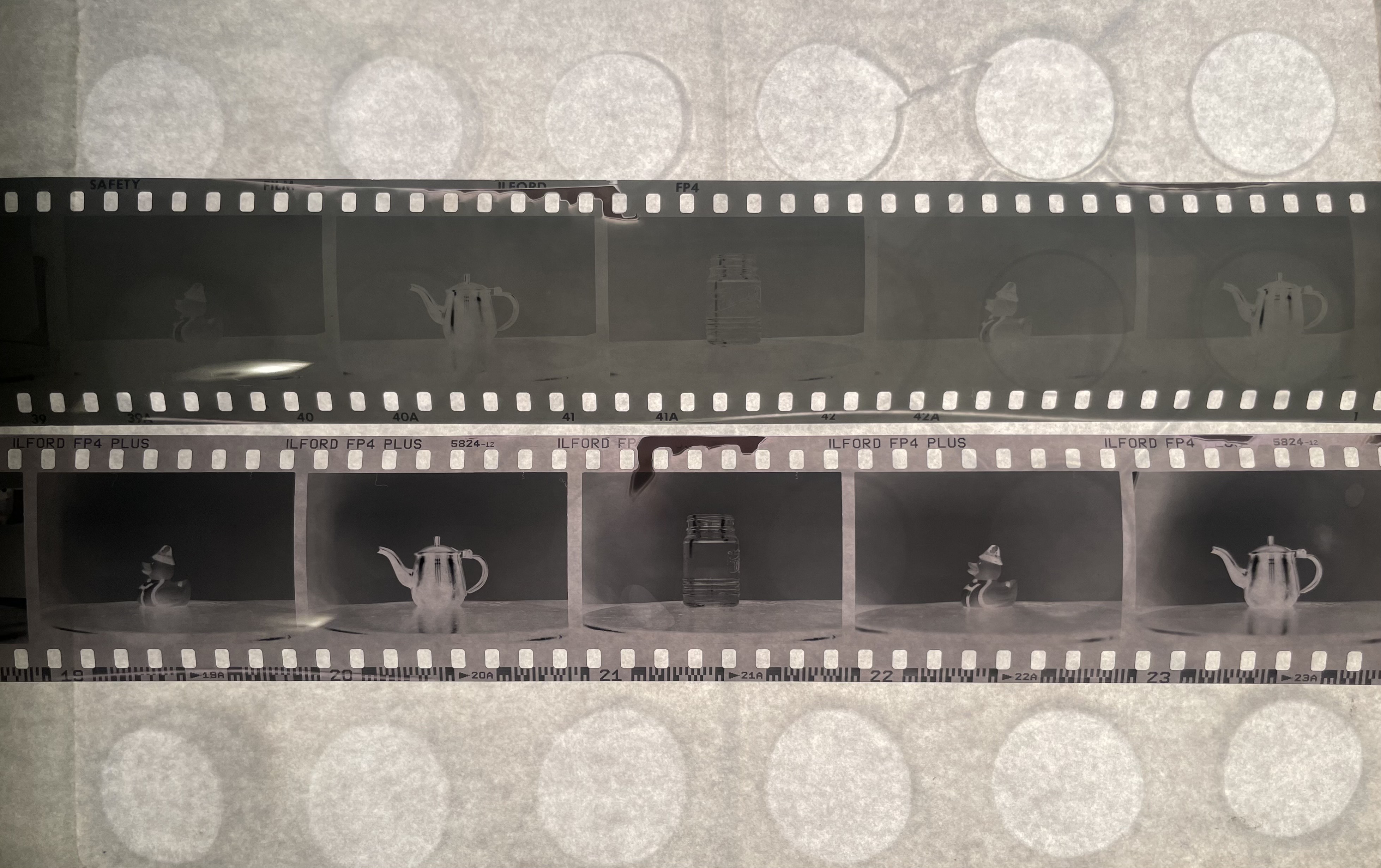

Hi everyone,

Its the previous fp4, for a shoot to properly understand what I was working with I got some modern FP4+ to shoot the same pictures with the same lighting and settings. It was the first time I really paid attention to that stuff. And right now when that would actually be important, I am embarrassed to admit this but I misplaced said card I took my notes on. I will continue to search for it in hopes I kept it, and didn't absentmindedly banish it to the recycling.
Anywho forgive the makeshift Backlight set up, here are the negs. they have some splotching because I hadn't quite mastered loading my reels yet. They aren't perfect copies because there was time in-between and whatnot but I hope it helps. They were developed at the same time in the same tank as well

Your film is fogged-overexpose by some amount, and you'll have to deal with that extra density in your scans/prints. You could try a restrainer in development but I would try overexposing first.
Instead of shooting it at 125ISO, I'd start at 80ISO, and may try 64ISO.

There is a lot of base fog there, that may not be salvageable.
It's not just that, though. The fog will also compress anything happening in the toe of the curve, which is now of course shifted upward by several stops. What remains is a very non-linear film with a low dynamic range.
@Homebrewmess that film is toast; you're wasting your time with it IMO.
It’s fog for sure, may even need more exposure than that, 25 might work. Develop longer. Expect wildly grainy results. @koraks is not wrong. But if you want wild results you’ll get it.

That is an unfortunately high level of fog, especially for FP4+ which is usually very robust.
I have to say I'd relegate this film to testing cameras. Or for teaching people how to load cameras and developing reels. It's not likely to give consistent images.

I was worried this was the case, its a part of why I was asking. Not to be a downer but finances are tight so I wanted to get the most out of that film if I could. But its pretty unanimous that its cooked, When I have the time i'll shoot a cassette of like 12 at 25 and show the results, that might help with the verdict.
I imagine that its hard to improve as a photography when your film is old and foggy like this, and its probably a better use of chemical to get new film. so I understand it being a waste

Just for fun and a bit of useful comparison, develop a roll of film that hasn't been through the camera, using a developer and a time appropriate for FP4 - not FP4+ (assuming that there are differences). Then share the results here.

In real terms dev times for FP3, FP4, and FP4+, are the same, for professional use most shoot/shot FP4 at 100 or 80 EI developed in ID-11.
With film with a high base fog, increase exposure and maybe 20% extra development. It's worked for me with some HP5

And consider adding some benzotriazole to the developer to restrain the fog. You'll have to increase development time by 20% or more to compensate.
Although I have no personal experience with the technique, I know some have had success with hours long development in a refrigerator, to suppress the fog. The technique has undoubtedly been documented somewhere online.

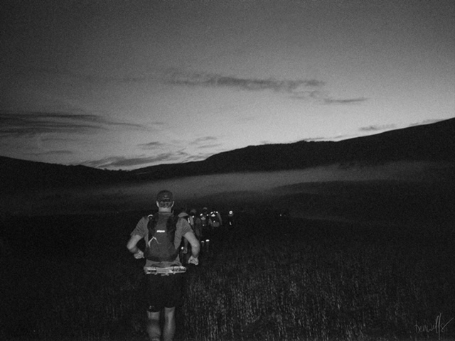

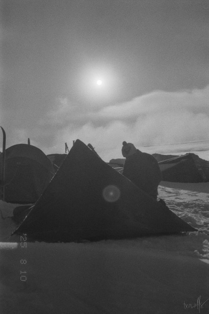

That film isn't too far gone.
This is 1991 Plus X Pan, shot at 80ISO, and developed for the standard developing time in D76. Next to it are some fresh FP4+ unexposed leaders to show how it compares to the cleared base of FP4+...that's just the film I had handy to compare to.
Now, here are my favorite images from that roll of film:
So, just because it has a lot of base fog, doesn't mean you can't get good images.
Overexpose. Start at 80, if that doesn't get you where you want, go to 64 or 40. If you can't get an image that you like by the time you get down to 25, then I'd consider junking it.
