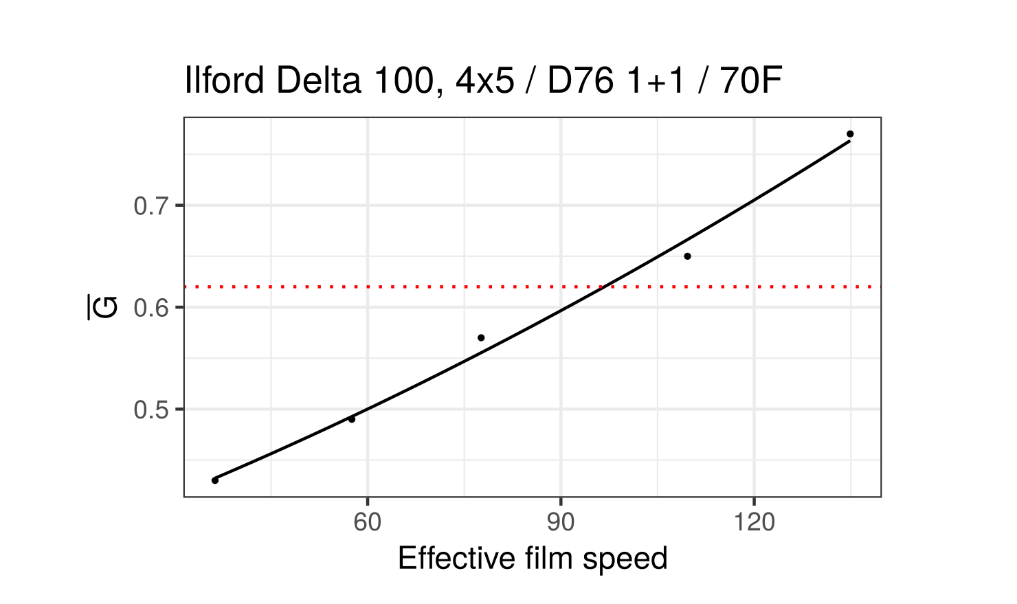

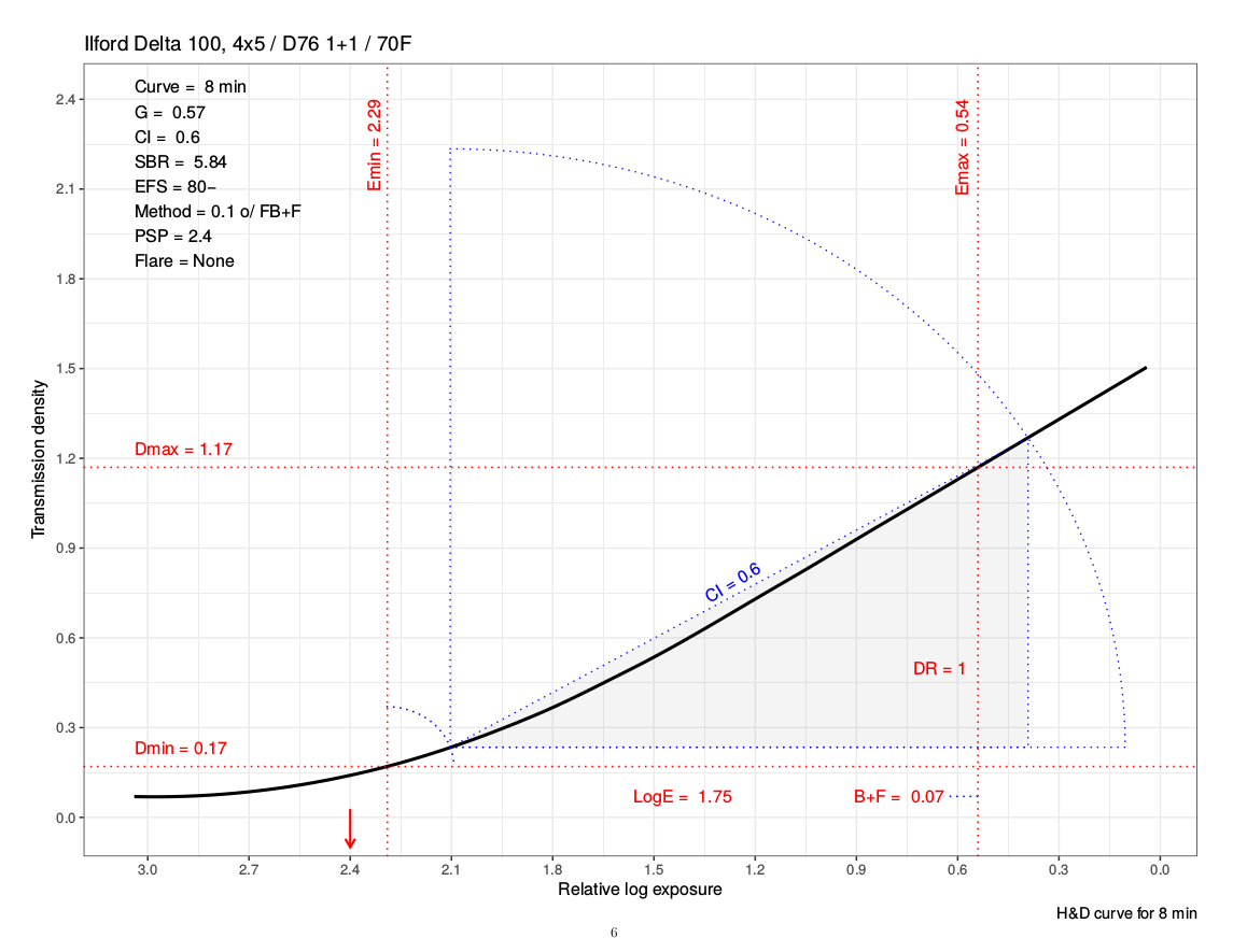

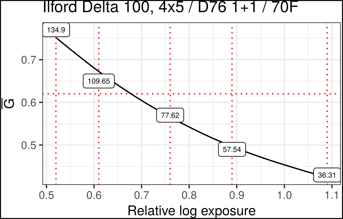

Knowing your EI, you can then make a few related plots, to help you make exposure and development decisions. I attached an example of such a plot. Hope this helps.

Thanks, aparat. That clears up a few things. But what about these effective film speeds? Adams first tested for EI, i.e., one film speed, which wouid be used for all exposures, whether for N-1, N+2, whatever. Lambrecht has a series of film speeds, each associated with a corresponding N development time. What do I do with these? What is their purpose?
Yes, you are right. They took a very different approach. They studied the characteristic curves first, exposing at box speed. The problem with doing a film speed test first is that, ideally, you'd need a well-calibrated exposure system, or sensitometer, so you can comply with the ISO standard and compare your speeds to the box speed. But that's difficult for most photographers to achieve, so they suggested a different, more "fluid," approach. Yes, you have multiple film speeds (EFF), but that makes sense only in terms of selecting the most appropriate combination of factors for any given scene. These EFF speeds are an interpretation of the data. Film (and paper) can be characterized by multiple speeds, it's just that the ISO standard chooses to pick one specific speed point (0.1 over BF).
The idea is that once you determined your nominal film speed (for them, it is at 0.17 over BF), you can then reinterpret the curves. A lot of photographers are motivated by a specific Average Gradient (G) or Contrast Index (CI), and you can get that from the data very nicely. I am attaching another plot that shows you just one of the many possible interpretations of the data. For 8 minutes, the EFF is 80-, CI is about 0.6, etc., and from such a plot, you can derive a lot of useful information to meet the demands of your vision and the scene. So, if the Subject Brightness Range is about 6, and I want to develop for CI 0.6, I would set 80- into my light meter, expose, and process for 8 minutes. That's one example of how you can interpret the data. Different photographers would do it differently. But you have the raw data at your fingertips, so to speak.

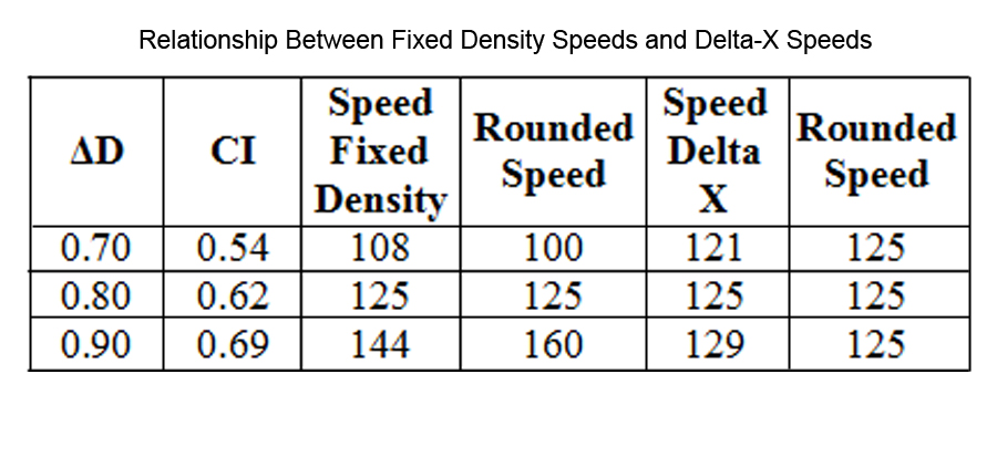

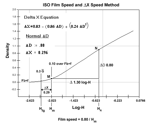

One shortcoming of this type of EI test (fixed density criterion) is that it overestimates the change in speed with changes in gradient.

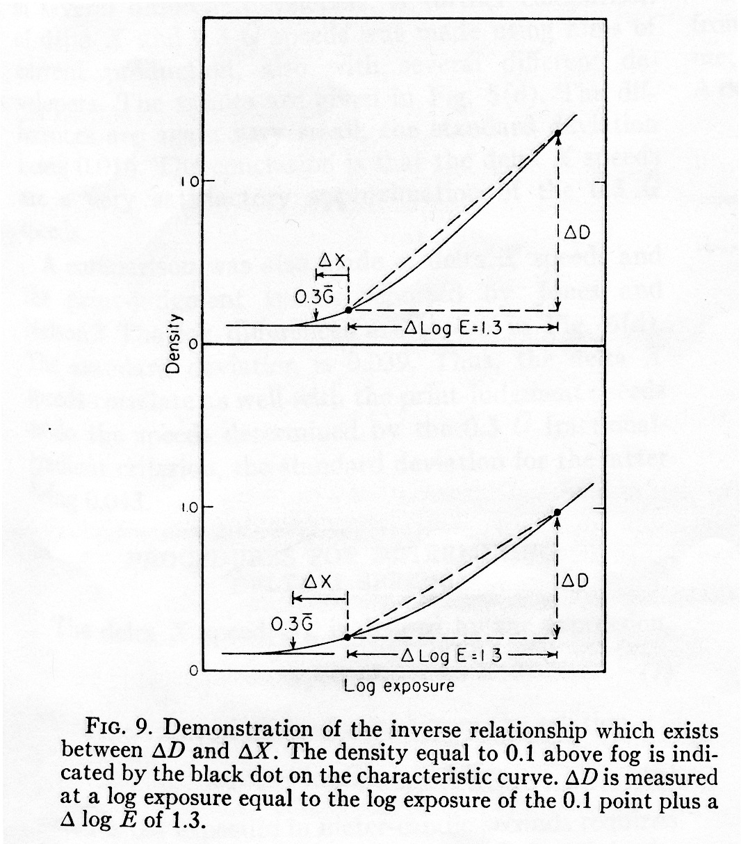

Michael has packed a lot into a single sentence. What he is referring to is the methodology of film speed determination. Accurate film speed has to do with the toe gradient in comparison with the average gradient. The ISO's fixed density of 0.01 over Fb+f is only accurate when adhering to the contrast parameters specified. If the film is developed outside those parameters, using only the fixed density point is no longer accurate. The ISO uses the Delta-X Criterion. While it uses a fixed density method to determine film speed, it is only part of a larger equation. When using the ISO's contrast parameters, the Delta-X equation is built into the method and brings into agreement the fixed density method of 0.10 over Fb+f with the fractional gradient speed point. Delta-X can be regarded as a simplified way of determining the fractional gradient method.
Given that only a small portion of people realize this and have made the necessary adjustments, yet still obtain quality results that seeming support their testing method brings into question the necessary accuracy required in any methodology. Adams developed the Zone System speed method when ASA film speeds averaged 2/3 to 1 stop slower than what they would test at today only do to using a different methodology prior to 1960. Adams never m ade changes post 1960 to adjust for the ASA speed method, and no one noticed. In effect, the difference in the relationship between the meter's exposure point and the b&w speed point with the Zone System and the ISO standard for the fixed density point of 0.10 is 2/3 stop. Zone System stops down four stops from the metered point. The relationship between the fixed density point of 0.10 and the metered exposure point is 3 1/3 stops. So even if a given film is tested perfectly using each method, eliminating all variables, the resulting speed values will differ by 2/3 stops.
Many common testing methods start with the ISO to determine the individual's working speed. For most general purpose developers, any discrepancy from the ISO speed is more likely the result of testing errors or the methodology used. Speeds outside the ISO contrast parameters as Michael states overestimate the changes in film speed resulting from changes in processing. According to the Delta-X Criterion, there is an inverse relationship between the average gradient and the Delta-X speed point. This is caused by changes in the toe's gradient in relationship to the average gradient. While the density of the fixed density point will increase or decrease in direct proportion to processing, the change of the toe's gradient to the average gradient with processing tends to dampen changes to the resulting film speed compared to a strict fixed density point.
Choice of methodology determines results. The question is if the all the varying results resulting from the different common methods used apparently aren't enough of a factor to be obvious to the average tester or affects quality enough to be noticeable, is there a need for the average person to test for speed?

Doc W, getting to your original question about varying effective speeds at different contrast gradients...
The fixed 0.1 density "criterion" is just one way of many to determine film speed. It's easy to calculate and Ralph Lambrecht used it in his spreadsheet.
When you take the fixed 0.1 density criterion literally, effective film speed changes exactly as you observed, at different contrast gradients.
What I see in the following graph is that you will tend to get 1/3 to 1 1/3 stop additional exposure above minimum required exposure for an excellent print... when you use 0.1 density criterion.
There are other criteria you could use, and get closer to the correct exposure indication, for example Delta-X which is +/- 1/3 stop of the minimum exposure for an excellent print.

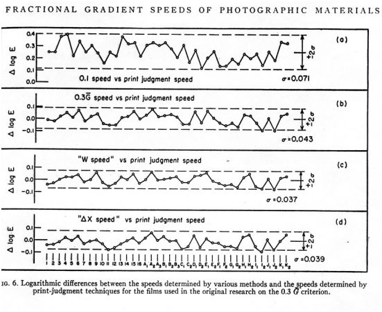

The best way to determine the conditions that will produce a quality print is by psychophysical methods. The print judgement speed is based on the prints a group of viewers thought had the highest quality and then working backwards to determine how the negatives were produced. The task is then to find a sensitometric speed method that most closely agrees with the print judgement speed in the majority of situations with the majority of film / developer combinations. The smaller the differences, the better the speed method, as Bill has shown with the spread function graphs. Something else to keep in mind, speed point isn't necessarily where the shadow of the photographic exposure should fall. The speed point may only be a point that is sensitometrically determinable from which the exposure can be derived. One idea is to find the minimum useful point of exposure. Anything below this point returns prints of reduced levels of quality. This isn't necessarily the ideal point to place exposure. The minimum useful point of exposure defines the limits of the film, any exposure above it, within a definable range, will produce quality prints. It's easy enough to take the minimum useful point and add an adjustment of one stop for example. So instead of a speed of 200, the film has a speed of 100 which has the exposure point fall 0.30 log-H to the right of the speed point.
The Fractional Gradient Method has a range of densities for the exposure point depending on the film's toe and average gradient. This means that something like a true proof is based on a false assumption. Ralph's 0.17 is about what the shadow exposure point was with the Fractional Gradient Method and in reality, the Zone System. It will produce excellent prints and probably slightly higher quality results than with 0.10 as the exposure point. The main problem with 0.17 is when using it as a speed point. Because it is higher on the curve, changes in processing will affect it to a greater extent than a speed point at a lower density. Resulting film speeds for higher or lower gradients will tend to fall further from the ideal print judgement speed for the same gradient, but as most people only use one or two films, they will not notice the discrepancies. Does that then make the point academic? Maybe, but as the ISO film speed already has an accurately defined speed and exposure point, if you like the idea of a little more exposure, why not use the ISO speed and open up 1/2 to 1 stop.
