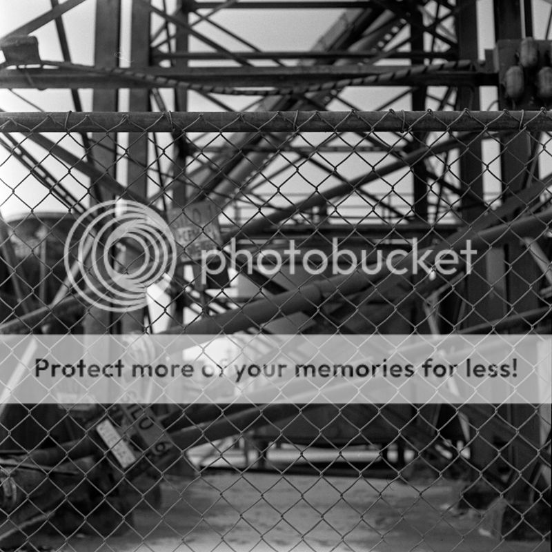

To be honest, patients is not one of my strong sites. I know that during the excitement of shooting my exposure can be 1 or 2 stops off....well, when shooting digital this is not a real problem...shooting film I can imaging this is an somewhat different story. That's the main reason I was interested in semi-stand. If you can develop different speed films in the same solution, you can also develop frames shot with different exposures on the same film without over- or under developing.
To show that my semi-stand developing is not a complete failure, some shots from this weekend:
More grain so underexposed?
On the left you see the uneven developing.
