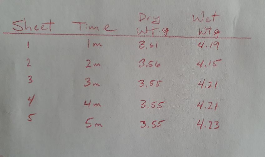

Just a quick note related to the amount of emulsion swelling - if someone wanted to compare, to see if there is a change between 1 vs 5 min presoak: the poor man's method might be to weigh some wet film. Preferably strip off the surface water with a squeegee immediately before weighing. The assumption is, loosely, that the swollen gelatin is very nearly filled with water, so that extra weight would correlate to an increase in thickness.
Through stupid errors with film holders over some time I have accumulated 5 sheets of ruined and undeveloped TMX. Since I had nothing else better to do.........for kicks and for what it may be worth, maybe none, I did this. I used fresh distilled water for each in a 5x7 tray, squeegeed both sides and immediately weighed them. Assuming it has any meaning at all, any differences do not seem very statistically significant.
that's interesting in it's own way to estimate the swelling of the emulsion.
from what I could find out the emulsion thickness of TMX when dry is around 0.01mm (possibly twice that at max).
so assuming those were 4x5 sheets, if they didn't swell they could soak up a max of 1.2mg of water (emulsion volume being 1.2 cubic mm).
the increase in weight in your test seems to be around 600mg, so assuming there are no water droplets on the outside of the film, that would mean the gelatin layer must have increased about 500 times in volume and therefore thickness (or 250times if the emulsion thicknes was 0.02 mm to start with).
seems like a lot, maybe I missed something in my logic or math?
edit: I just checked with three different AI models and they all said rougly 5.7times thicker, which makes a lot more sense. so there must be two factors of 10 wrong in my thinking above.

Nice experiment @Chuck_P - I think the numbers do illustrate one thing though: that after a minute, the film has pretty much soaked up as much liquid as it ever will.
Tha's exactly what I was thinking when I got to the third sheet.
4x5* = ca. 10x12.5cm = 125cm2. At a height of 10um this makes 1.25cc. The actual weight gain is around 0.6g, so that seems quite nicely in the order of magnitude where we'd expect it.
Maybe the water-saturated emulsion dilutes developer by-products enough to affect the inhibition properties caused?
I'm thinking along those lines, yes.
