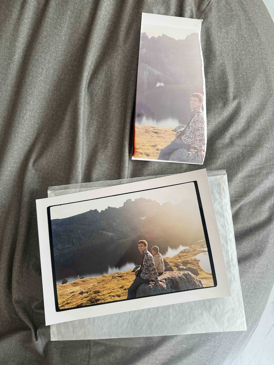

Hello! Yes I believe you are right that there is something strange about my need to add contrast. I’ve had good results with my prints thus far but I just tried to print an image that I already had hand printed at Carmencita film lab—the difference could not be more stark. The contrast is low because there is a lens flare over the image but the contrast I’m attaining is not even close to that from Carmencita. See the image below of my test strip next to their print. Any guesses? I’m using Bellini chemicals, they’re using Calbe Chemicals. I also haven’t replaced the bulb since I got the enlarger from a professor. Or could it be an enlarging lens difference? Appreciate anyone’s thoughts here!
Ok here's my test strip next to the final from carmencita. As far as development goes, I'm keeping things very consistent in terms of temperature (with a Cinestill TCS1000), and using one shot development, so the developer is always fresh.

Well, your test strip could do with a fair bit of additional print exposure time.
Yeah possibly so—only thing is the whites in the image are already lower in level than the reference print

I think solving the low contrast issue I’m having will replace the need for hydrogen peroxide. After the holidays , I’ll plan to try:
1. Resealing all the possible light sources
2. Changing the bulb
3. Changing the lens
4. Changing chemicals
Hopefully with all of those, somethings gotta give
I think that's a good plan.
If you constantly have the need to increase contrast in your RA-4 prints... there is probably something wrong in your setup. Unless you regularly overexpose your film by many stops...
You're right to put that on #1. Add to that "1a": also ensure there are no light leaks on/around the enlarger head. A real head-scratcher would be a small light leak around the lens mount/plate, which will basically fog the paper, decreasing contrast. The problem may come and go as you change lenses. Until you figure it out!
Fogging is the first thing to look into in cases of surprisingly low contrast. Since the fogging in your case appears to be close to neutral color balance, it would logically be fog from stray light emanating from below the negative carrier. Fog from white light produces yellow to red color casts. Blue status led on equipment in the darkroom LEDs produce a yellow cast, red LEDs fog cyan, etc.
In any case, something's definitely very much out of order for contrast to be so low in the test strip shown. The print below it looks normal and since it's from the same negative, it's a good indicator that the problem is in the workflow or environment.

It's not the bulb or the lens. I don't think it's the chemistry either since the fogged edge on the left side of the strip has developed normally. If the strip had been underdeveloped, that black corner/edge would have been navy blue instead of black if the rest of the print ended up so low in contrast.
In short, if it's not 1 or 1a as I mentioned above, skip to #5: an as of yet unidentified factor. But I'm fairly sure you'll find that it's a light leak on the enlarger.
Still, I'd first try getting some more density into the main subject to match the reference print. Once you have that, consider that it would be very easy for the lab operator to employ some dodging in the sky (less so in the bright reflections in the lake, but those are still less dense in your print than in the lab print).
Are you using the same paper type?
Makes sense, I’ll give it a shot. Yep, both DPII, in fact I got mine from them
