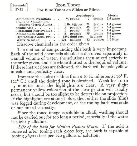

If I have time, I'll post Formula T-11 later in the day -- or scan the page.

Blue toner for film

Matt,
I thought BLUE was an iron blue toner. My understanding is that component of the toner reacts with silver in the image and turns into dye - in turn toning that location. So.... I thought it will affect the shadow and leave the highlight alone. Instructions say to wash long enough to clear the highlight.
I did that and everything washed off.... very very very vague hint of blue remained but it hardly left any color....
Note that the above formula warns against long washes in water that is alkaline. How's your water?

Thanks for the formula...120 gallons--wow--i don't think my bathtub is that big...lemme print this out and read it through....
although it looks like this would only be good for it's intended color--but may work out in the end if I need blue--I wanted to use red and green 2 color process, but if I can find no mordant process that works, then it'll be the straight toners like this--no reason why red/blue won't work.
what I'm looking for is one that will mordant the silver and allow me to use the dye of my choice to color it--apparently this worked though and 1lb ferricyanide per 120 gallons is like almost exactly 1g/l...way less concentration than what is NOT working for my mordant....hmmmm maybe the trick is to tone soltuion/rinse/tone solution/rinse and build it up like I've seen mentioned....i think I'm going to order the forumulary toners and see...it looks like the forumulary copper toner can also function as a mordant too from what else I'm reading...like the copper salts are better than the silver salts for holding the dye.
