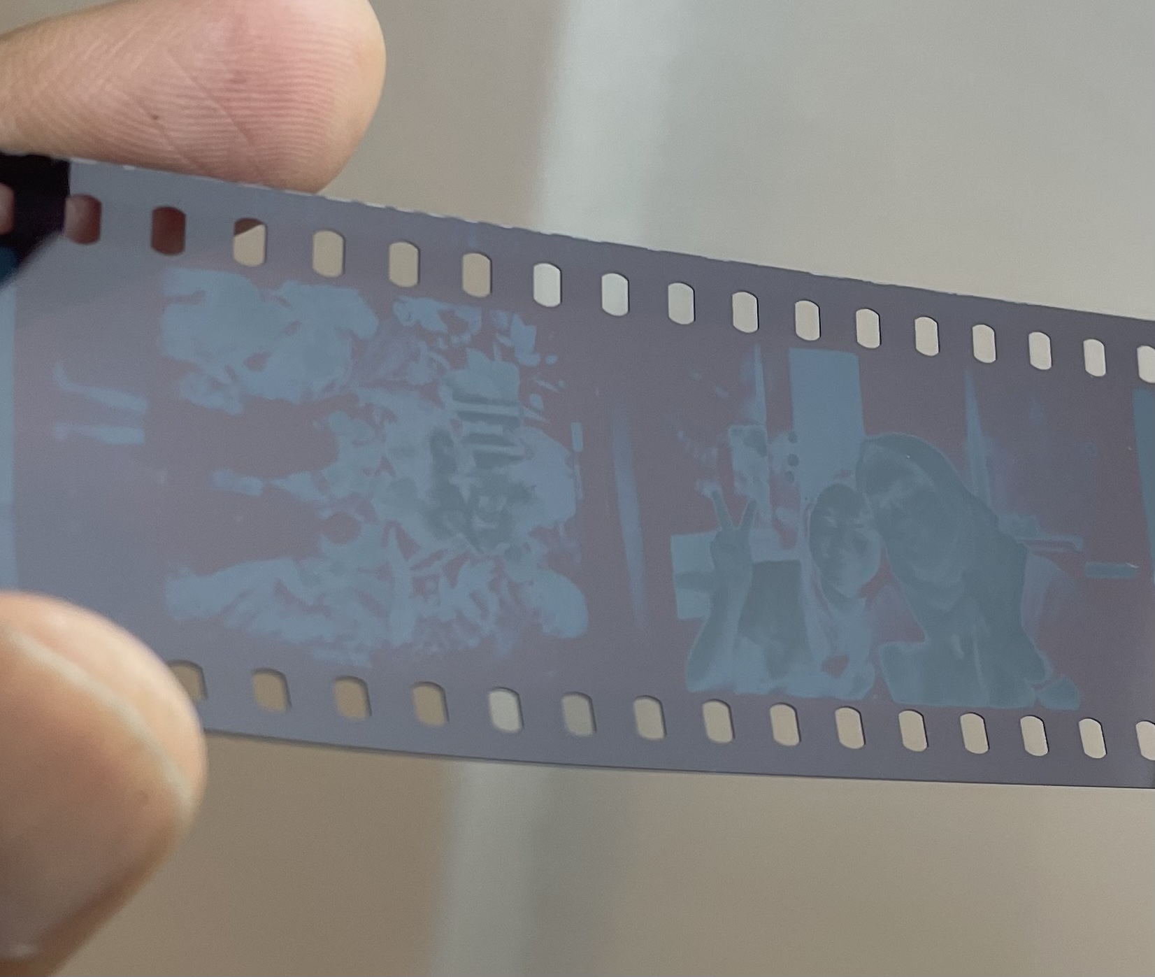

Im back here with my latest problem. I just developed a film with ECN2 processing using chemical brand CHAMPION. This chemical
I used also for c41 processing on noristsu machine v50. So far for c41 no problem on output. Means everthing perfect . Same goes on ecn no problem at all.

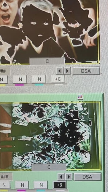

However today , i developed 5207/250D motion film through ECN processing . From the sacnner its look akward !

Looks like remaining remjet on the film is not playing well with ICE of the scanner.
Make sure that all of the remjet is removed or temporarily disable ICE in the scanner. I've scanned ECN-2 processed Vision3 films on Noritsu LS-600 and there were no such problems.
It seems that whatever has remained on the film is where the densest highlights are. I doubt it's remjet, perhaps incomplete bleaching?

RemJet leaves thick and rough marks. In the example shown, the problem areas are accentuated in the contours of the image... Whether it's silver retention or the scanner can't handle these films I don't know, but it might be a good idea to shoot the negative on the light pad.

Good point about problem areas being contained to highlights, so yes, I agree that retained silver is more likely the cause.

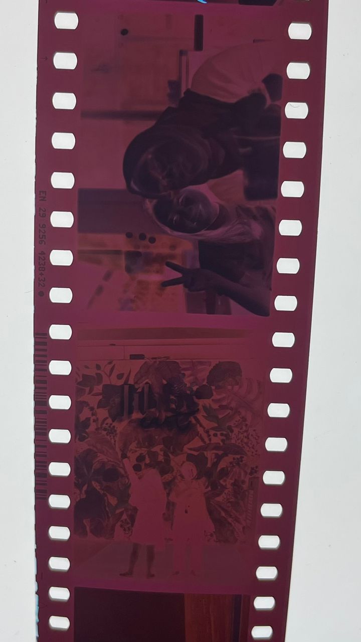

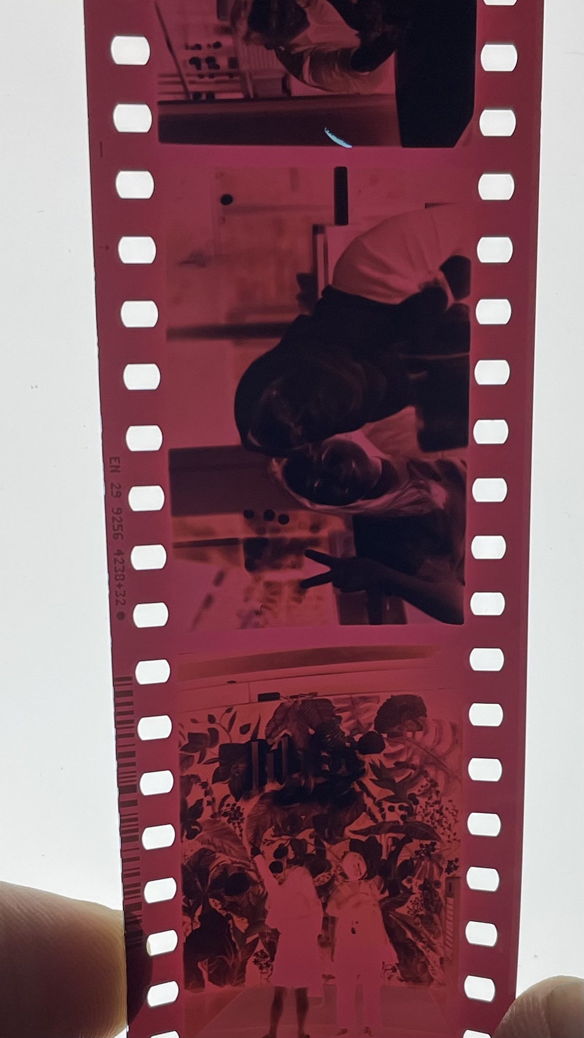

Yes, I second that question. Please post some (good) photos of the actual film strip. One photo of a strip against an even backlight, and one photo of the strip held at an oblique angle to the light, clearly showing the emulsion side. Retained silver (at least if there's lots of it) tends to show up in the second shot, mostly.
It won't hurt to manually re-bleach and re-fix the roll to see if this makes a difference. Using (fresh) C41 bleach and fixer at room temperature in a tray, bleach and fix the film for 10-15 minutes each. This should remove any remaining silver. If this clears up the problem, there's an issue with the Noritsu and/or the chemicals in it.

herewith i attached the negative for your kind reference and comment ..
Your feedback on this matter really appreciated

Excellent photos, @angah316 , thank you very much!
Yes, I agree with @Anon Ymous that these show a massive amount of retained silver. I also think they are significantly overdeveloped, but see how these negatives come out after a round of bleach and fix.

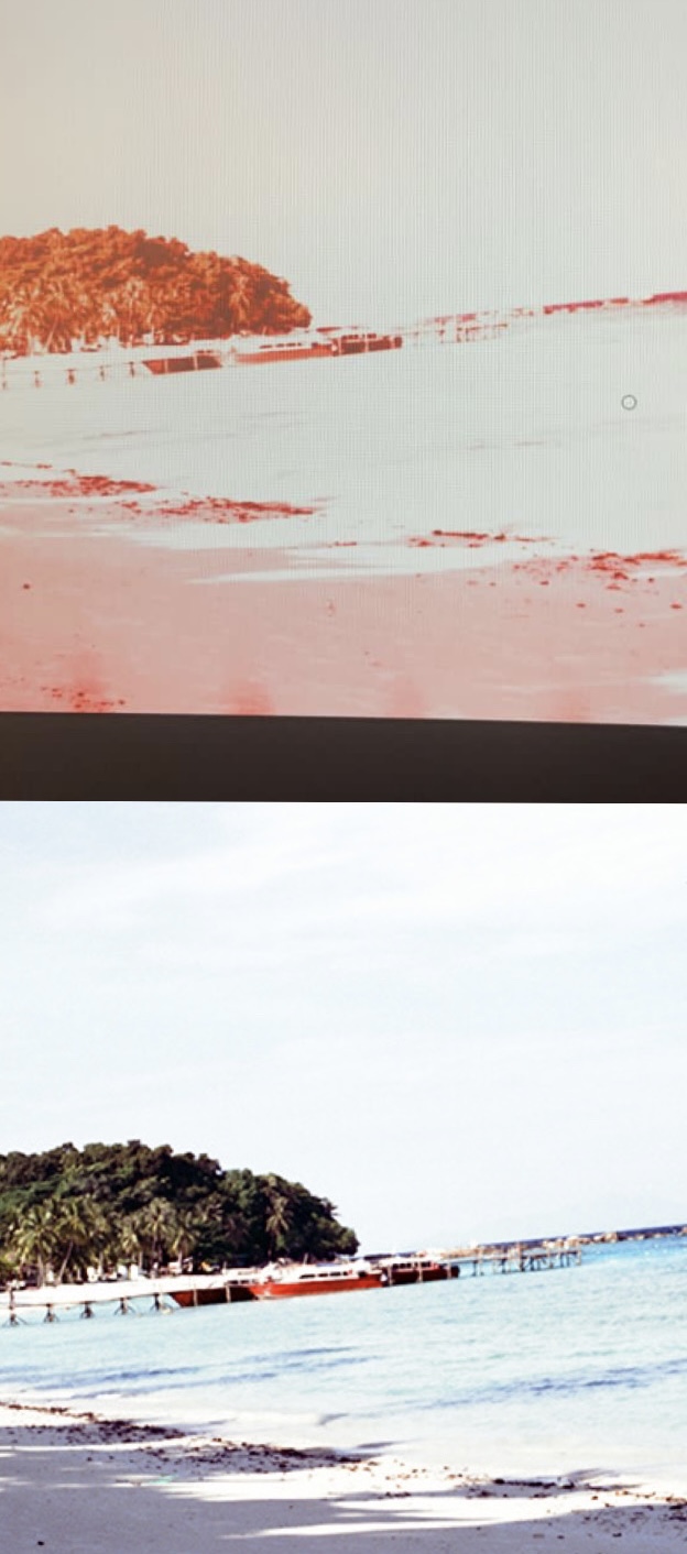

Guys .. tq very much ..
Its works and the pic perfectly developed .. colors n tone just nice .
Thanks guys for kind help ..
Just wondering, once we developed , didnt know we can redevelop to get the output . I thought once we finish the fixer process everything done. Cannot repair or fix it ..

Ok, great to hear you've managed to salvage the images.
To be honest, the base color still looks very far off to ECN2 film I develop in ECN2 developer. Gamma/contrast of the negatives also seems to be very, very high. And there's the puzzling question why the film didn't bleach properly in the first place.
I think some root cause analysis is in order to prevent more problems in the future.

I believe its mistake on bleaching process , either the temprature or timing not enough ..
My experience before , temprature too hot, it turn greeny on shadow area ..
As i mention before, i used c41 chemical not the specific ECN2 chemical ..
Ok, I misunderstood your first post where you spoke about 'ECN2 processing', which I interpreted as 'using ECN2 chemistry'. My bad. ECN2 film in C41 developer does funny things, so that will explain to a large extent the odd base color and high gamma. Too high temperature will shift things further into the same direction. Fortunately, scanning and digital correction tends to fix things regardless, so all is well.
