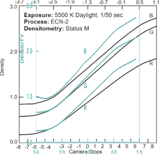

The gamma of ECN2 film developed in ECN2 developer is lower than for C41 film in C41 developer. Extending development time increases gamma. Look at the sensitometry plot in the datasheet:
The black plot is Vision3 250D. The cyan plot overlayed on top of it is Kodak Gold 200. Note how much steeper the Gold plot is (but otherwise very similar). Extending development time steepens the curve so it looks more like C41.

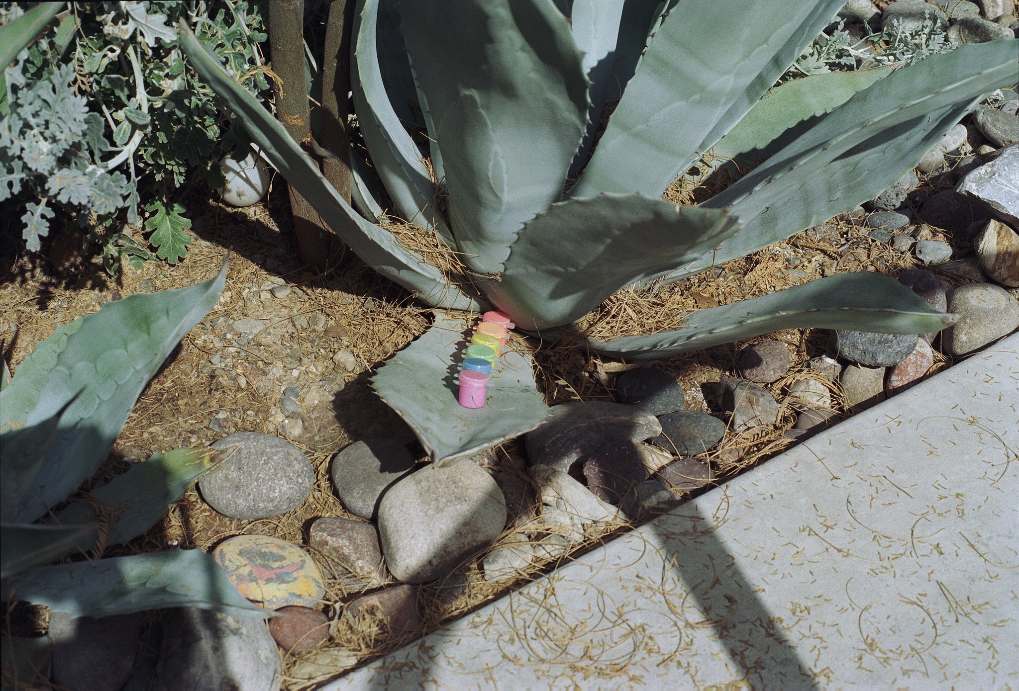

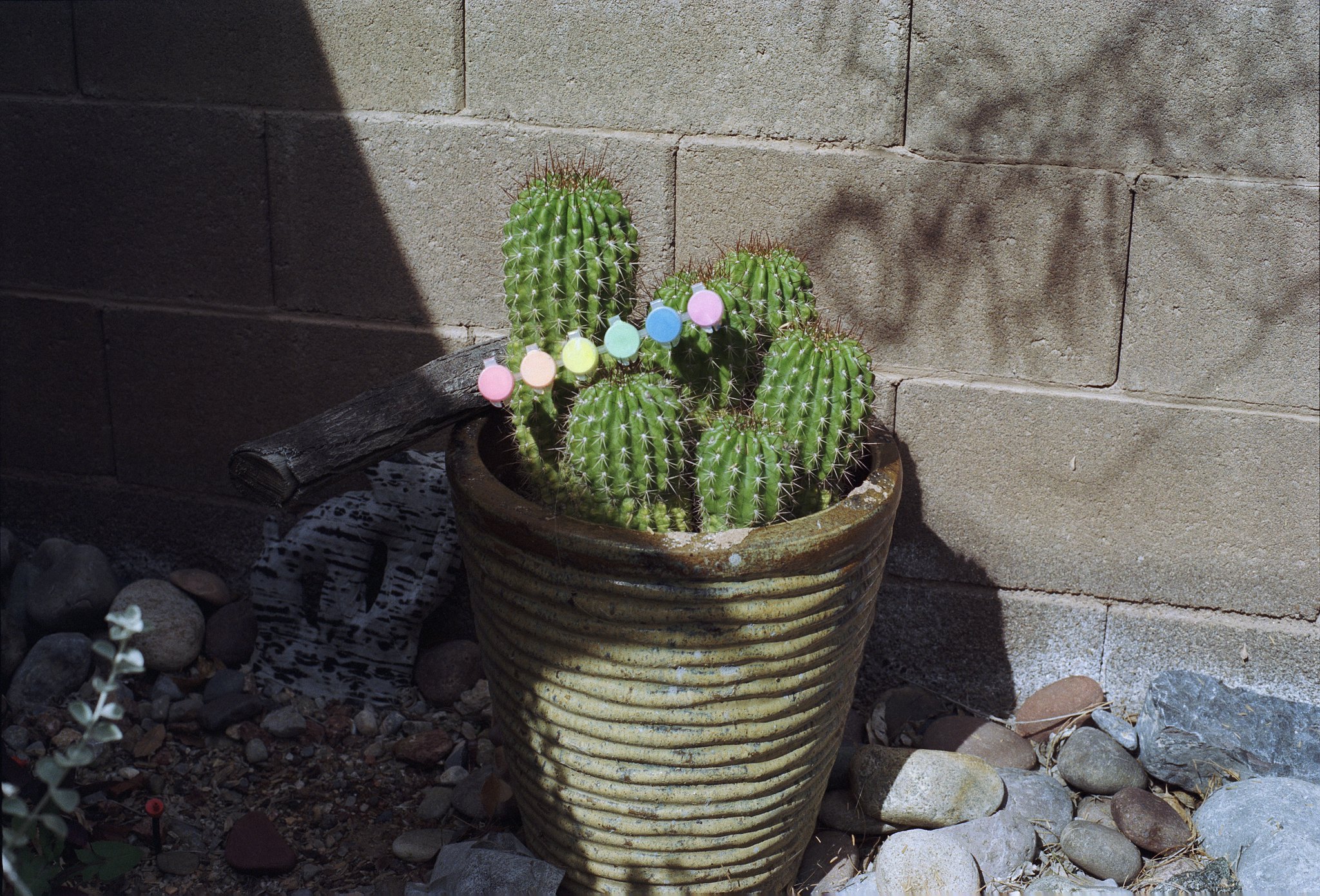

I approach film differently than most. I want the colors to be as close to reality as possible.
Here are my scans that looks very very close to reality. Even my portra scans “and older richard’s noritsu scans“ are not that that close.
I did not over expose in camera like i usually do for the increased development.
