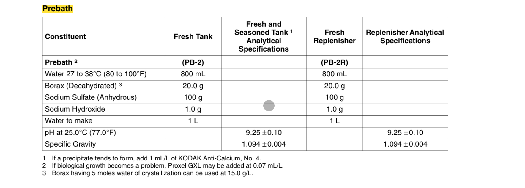

Another note. I do a pre bath per Kodak’s formula.
And it works great. 10 sec pre bath no agitation.
After that a good shake and everything comes out with the first water.
After that there is zero Remjet.
I also do a PB-2 pre-bath. It removes quite a bit of the remjet, but not all of it. Only with the Fuji films does all the remjet fall off, but with the Kodak I end up having to manually peel off the residue.
Which formula?
I use this one
Before when I used the other formula there was alway a little left.
With this one there is nothing left.’

Which formula?
I use this one
Same formula. This clears a very large part, but a very thin layer remains, which cannot be removed without mechanical action. Even in the description of the commercial equipment there is an explanation of how to remove the remjet - Module 2 (H2402) - Equipment and Procedures.
