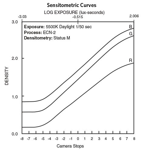

ECN-2 film is said to be a low(er) contrast film when developed in ECN-2 developer. My experience with it agrees with that.
This is what Kodak says about Vision3 5203 (50D):
Maybe my math is flawed, but I can't see that Portra 400 is significantly higher contrast:

Carefully read the horizontal axes. There's a rather massive difference in H/D response between those films.
As I said, maybe I need to refresh my math. When I convert the Portra X axis I get same 16 stops as on the 50D.
But let's say that I'm wrong (and I would really appreciate someone pointing out my error), can anyone of you people shooting ECN-2 produce a negative developed for 3min in ECN-2 developer with a density of 2.8 in blue channel?

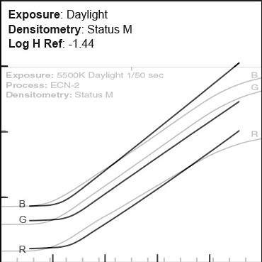

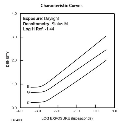

Maybe my math is flawed, but I can't see that Portra 400 is significantly higher contrast.
Well, you both got it wrong...
The horizontal (exposure) axes are with an error of 1/3 stop at same scale.
The gross difference though is at the vertical (density) axes. Corrected for that, the ECN graphs would be much more shallow.
The log exposure is conveniently included in the top part of the 50D graph, making them fairly easy to compare. Yes, the 50D is much more shallow.
Sorry for being overly dense, but I'm still not seeing it. The scale is shifted aprox. 3 stops (a difference in film speeds iso50 vs iso400), so not longer/shorter in either of them.

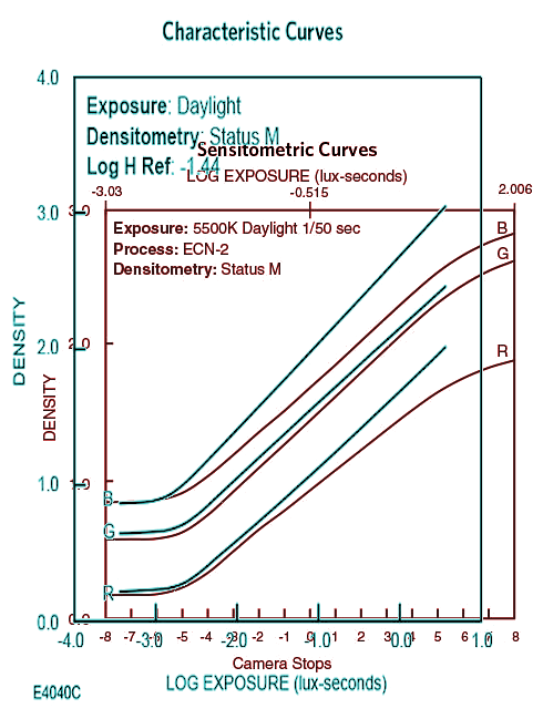

This is 50D curves squashed to the scale of Portra graph:
More or less, yeah. It's a bit finicky to merge them together; this is what I come up with:
Scaled the vertical axes to align on the same log density for both graphs. Then I tried to match them by overlaying the toe of each graph on top of each other. When doing so, it immediately becomes apparent that dmin is higher for Portra than for 50D, but that's of little concern. B & R channels (so Y & C dyes) show a significantly higher gamma for Portra, while interestingly the G (M dye) gammas are more or less the same. This illustrates the difference in color balance and linearity, and also explains why it's so damn hard (impossible) to get a good RA4 print from an ECN2 negative - crossover is guaranteed by the non-matching curves between 50D film and RA4 paper. Notice also how the 50D film already shows a distinct shoulder towards the right side of the graph, while the shoulder is not yet visible for Portra. Also notice the breakdown of tracking between the 3 color curves in the 50D graph at the shoulder, with red/cyan shift occurring at that point. Finally, notice the shorter toe of Portra, suggesting the layers track quite nicely if sufficient exposure is given, but with underexposure, the whole thing breaks down in a muddy mess, whereas with 50D there's some detail being preserved in the toe region although with poor color tracking.
