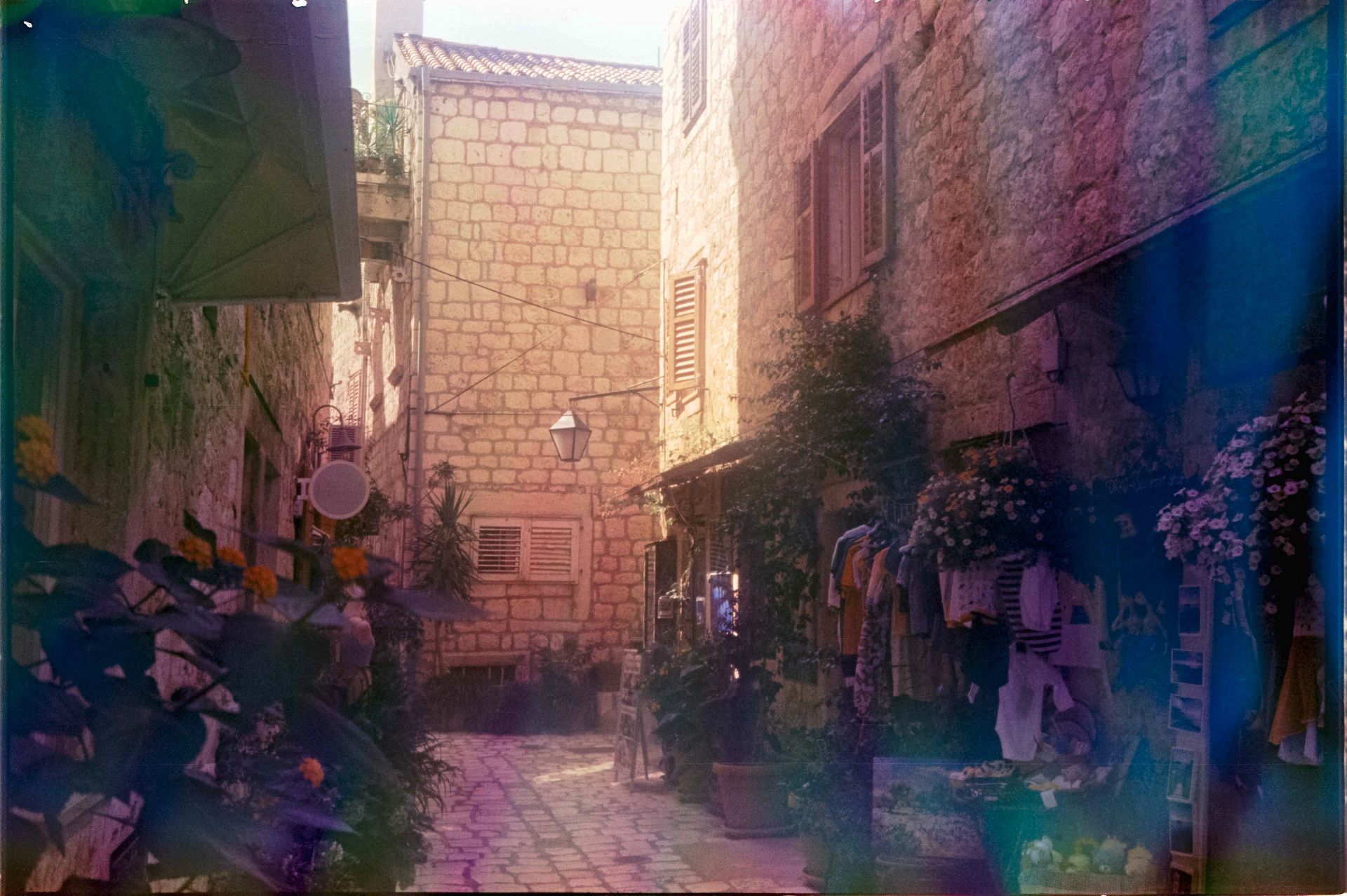

This's from a roll of reflx lab's respooled AHU 250D, and my ECN-2 developer was a half batch based on Kodak's recipe. So 1g sodium sulfite, 0.6g sodium bromide, 2g CD-3, 12.8g sodium carbonate, and 1.35g of sodium bicarb mixed in 500mL of water. Developer was mixed a few minutes before use, developed for 3 minutes at 106F, then discarded. Then just ran through some ferricyanide bleach and color fix.
I'm at a loss as to what's causing those color bands on the sides of the frame. I ran this roll in a patterson tank rotary processing with a Pira Darkroom Helper, so it shouldn't be an uneven agitation or temperature issue. I mix all the chemistry to 0.01g of precision on a scale, so I don't believe it's a mixing issue. Anyone here have any clue what I might've borked?

Have you ever before developed ECN-2 films using your own homemade chemicals?
You didn't mention a stop bath.
In my experience, when developing colors at home using Ferri Bleach (both C-41 and ECN-2) a stop bath is necessary.
This prevents stains resulting from Ferri Bleach interacting with developer residues on the film. This has been discussed many times here on the forum.
For example, see this link: https://www.photrio.com/forum/threads/color-cast-problem-with-diy-color-negative-chemistry.212253/
You don't have to use sulfuric acid. Glacial acetic acid or even white vinegar from the grocery store will work. Of course, you need to use the right concentration.
To this, add 10g-20g of sodium sulfite (I also add sodium acetate). After this bath, rinse the negative thoroughly with water before using Ferri Bleach.

Yeah, good advice. Most likely this is the issue.
@Flares, in addition to the above, you could try adding a pre-soak to your process to promote even wetting of the film with developer. But the stop bath & sulfite clearing are essential if you use a ferricyanide bleach.

You're using C41 bleach and fixer, so it's probably EDTA or PDTA-based. These results in the OP's case are due to the use of ferricyanide bleach and probably not using a cleani-stop bath after the developer and before the bleach.
Yeah, that seems plausible based on the thread thus far. I haven't every dealt with ferrocyanide bleach afaik.
The author of the thread I linked to in post #2 had the same problem.
Even if you're using EDTA/PDTA-based bleach/blix, also use the STOP bath (adding sodium sulfite wouldn't hurt).
After the STOP bath, rinse with water before applying bleach. This is mandatory for ferri bleach
The basic rule is to rinse thoroughly before each subsequent bath.

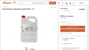

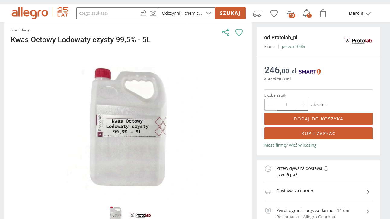

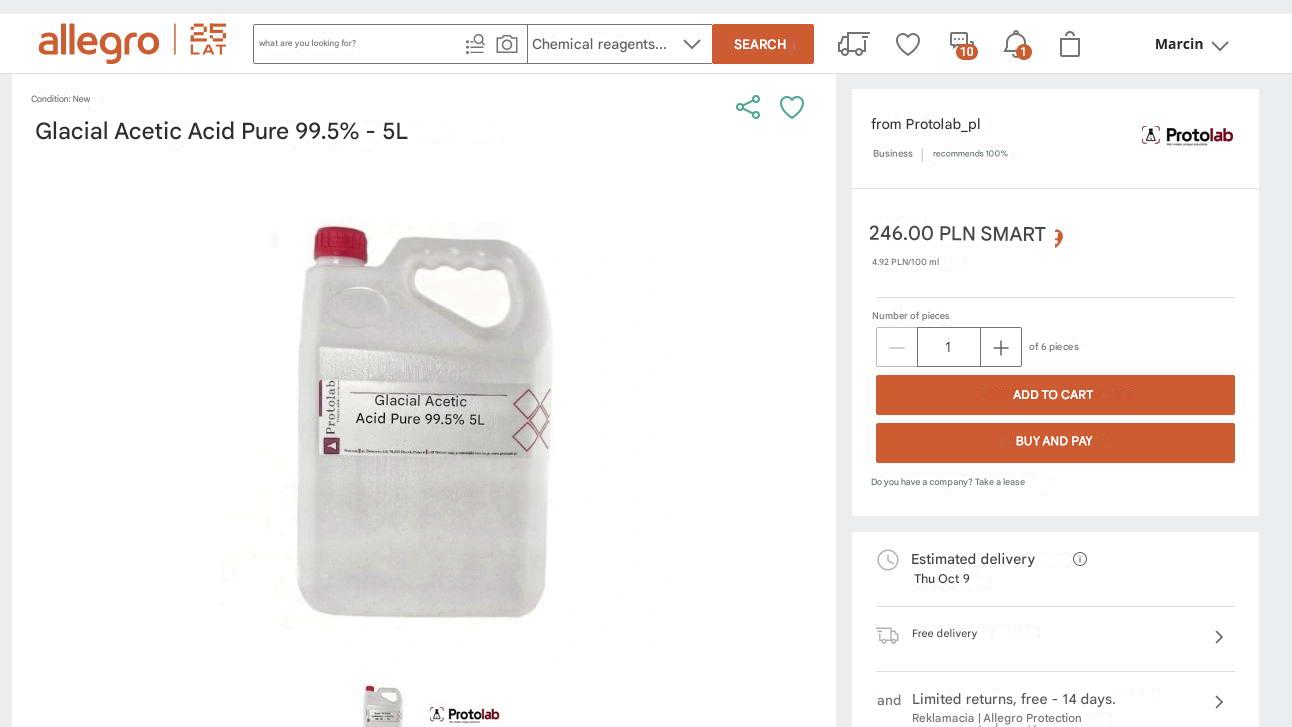

I am attaching a screenshot of the Allegro offer in the original Polish language and the same image translated.

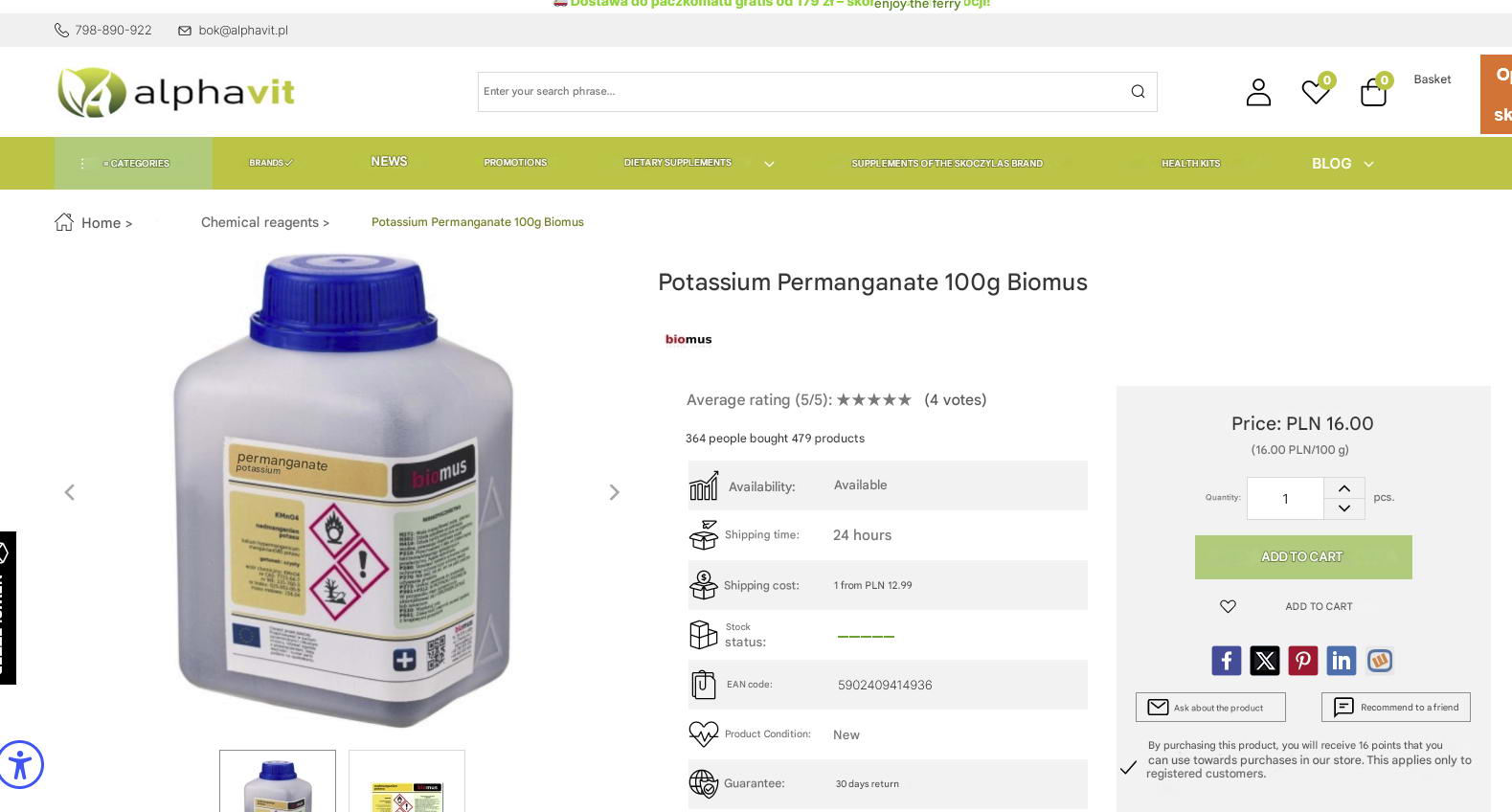

The ban on sulfuric acid, and restrictions for selling potassium permanganate cause more problems (bleach for black & white reversal process).
In Poland I can buy as much potassium permanganate as I want.

This was most likely it. I normally wash my film rather aggressively between dev & bleach but probably didn't do a good enough job this time and had some prussian blue forming because of it.
Should be easy enough to mix up some stop bath with household vinegar for future rolls. What's the point of adding sodium sulfite to the stop bath though?
Let me paste a link to a post written by the unfortunately deceased PE, who was an expert on photographic chemistry on this forum.
It's there to avoid instantaneous oxidation of the color developer in the bleach bath by means of the ferricyanide, which is quite aggressive. This oxidation can/will result in fogging of the film. It would be a perfect explanation for the problem shown in #1.

Before adding the developer, add plain water of the same temperature as the developer and soak for about 2 minutes before adding the developer.
