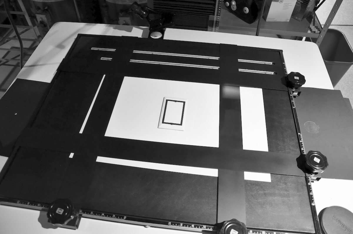

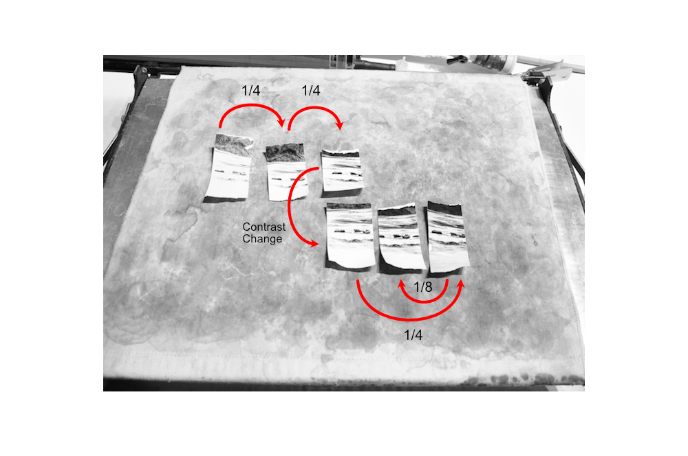

I like to get the print correct to either 1/4 stop or 1/3 stop. To do that I use this little test strip frame. I lets me put the test strip in the same location each time. It never made any sense to me to make random exposures on a full sheet of paper because there is no way to know what the next exposure in the sequence will be without processing and drying the first strip, and so on.

Yeah, thought of that
Do you use your device by placing the strip on it such that it perfectly covers the black frame around its perimeter? If so, the purpose of the frame is to let you place each strip in exactly the same location. In essence, that would make it an easel-within-the-easel. Unless I misunderstood.
Mark Overton
Yes, it is just a frame outline. My enlarger easels are essentially in the dark, little or no safelight falls on them, so the white with black border shows up so I know where to put the test strip each time. It is slightly weighted and has a foam rubber base so it does not either move around or damage the easel surface.

Many years ago I did make a device like the Op shows. To get a ballpark exposure for the main test print, I'd use a little piece of paper and do a small test exposure first. However, it turns out many times that would be pretty close and I could just make a second and third and so on little test exposure to zero in. I just started working that way and stopped using the device to make the big combined test print.
