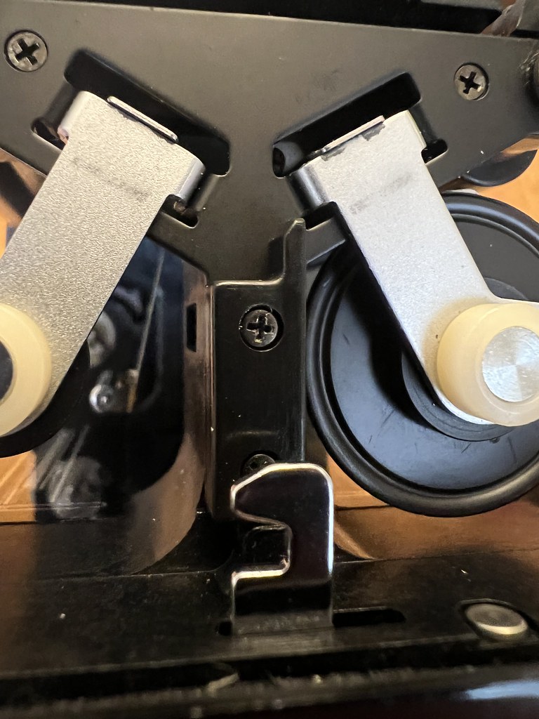

On a pentax 220 back, the pressure plate has two machined flats on each side, where the pressure plate makes contact with the rails inside the camera body.
The 120 backs do not have the machined flats, the pressure plate is flat. By adding the foil tape shims onto the 220 pressure plate, you can set the two pressure plates into the same location in the camera body, eliminating any worries about overloading the in-body motor. Make sure you apply the tape only to the machined flat, and trim carefully to make sure no sticky bits of conductive foil could get dragged into the camera body.
The silver is where the foil tape is applied.
