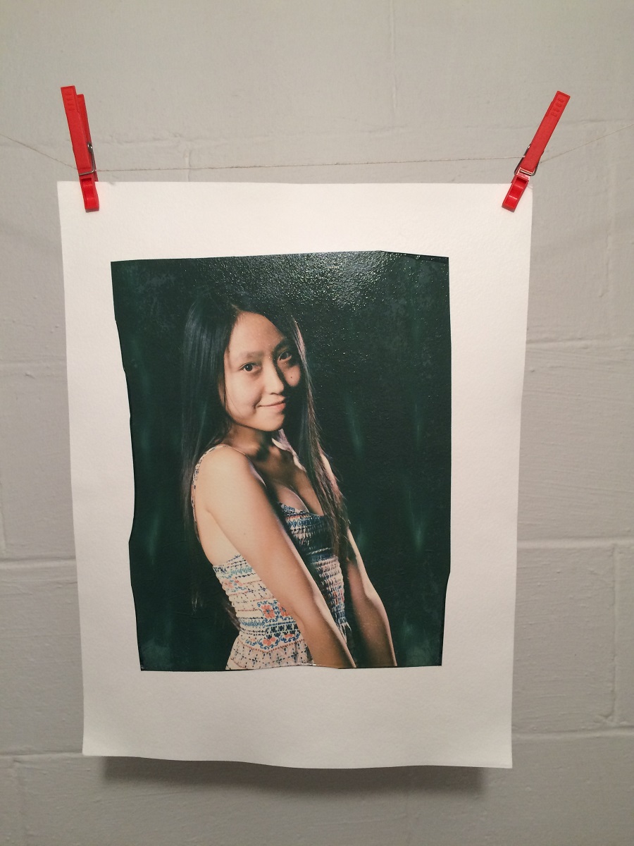

Emulsion lifts from instant film are pretty nice. This is 8x10 but it works with smaller formats too.
Any idea what films that works with? I currently have a packfilm camera (with FP-3000B and FP-100C), and I have a 600 series Polaroid with no film.
This only works with integral type instant films, currently made my Impossible Project/Polaroid Originals. They sell film for your 600 camera.
Ok cool, at least I don't have to buy more cameras! hah.
