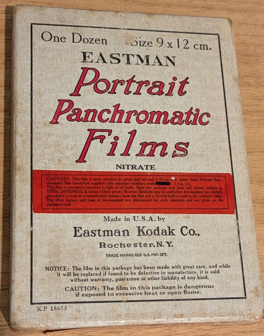

I got some really really old 9x12 sheet film: Eastman Portrait Panchromatic Film. Still in its original sealed packaging. .
Its stamps says "develop before 1933". Haha, that was a while ago.
So my questions are:
- Do you think it is still worth taking photos and develop it? Or just keep it as museum display?
- If it is worth using, what kind of ISO would it be to expose the film? And which developer would you recommend to start with?
- And is Nitrate film easily inflammable? Any precaution in handling this?

Cellulose nitrate is extremely flammable, like gun powder. Even static can ignite. It's no use as film.

It's flammable but it's really not that bad. My dad has a set of knives with cellulose nitrate handles that have been in use in the kitchen for 30+ years, just don't forget and leave one in the oven when you turn it on. Other than maybe not smoking around the film just shoot them as you would anything else.
At a guess start at ISO 25 and work down from there. I'd try progressively exposing one and using a dark slide to do a test strip across the exposure and seeing which, if any, gives you a non-fogged result. Probably try something like rodinal 1:100 stand developing and good luck!

I wouldn't be able to resist trying it. Try at 1/2 the recommended ISO and develop in D76 1+1 for 10 minutes. Nitrate film is flammable but is OK until it has a moderate vinegar smell. If so, keep in a closed container in the freezer.

If it was me, I would keep it as a museum piece. I have no idea what you will actually do.

I had a box of 4X5 Trix from the 50s and later a partial box of a othro trix maybe from the late 60s. I developed a sheet of each in D76 and fixed them to see how much fog. Both were almost black and the TriX emulsion was peeling off the base. Do you have a 6X9 sheet film holder?

Thanks for all the suggestions so far. Indeed I have 9x12 sheet film holders and camera to test this film on, if I wish to do so.
I will weight and pros and cons and decide what to do next.

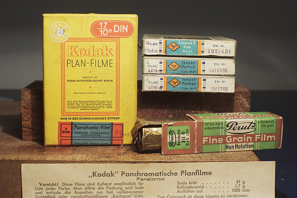

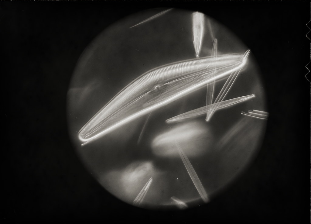

Recently I could develope some vintage nitro films.
Best results came from Kodak Panatomic (german made edition by Kodak Berlin) expired in 1943. It's a 6.5 cm x 9 cm sheet film:
MGBM_142_Cymbella by Jens H, auf Flickr
Here all the nitro films I have used so far:
Panatomic_et_al_nitrofilms by Jens H, auf Flickr
All these sheets are well usable, only the 120 roll Perutz fine grain film came out completely black.
For that old film Rodinal, HC110 or other developer's without carbonate prevent emulsion lift off... Pyrocat with NaOH works great, too.
Best
Jens
I guess my mistake was using D76, should have used HC 110, seems to be recommended by most for expired films.
JensH
May 30, 2017
538
Schaumburg, Germany
Yes, made this mistake, too. Using the usual acidic stop bath made things worse... ;-)

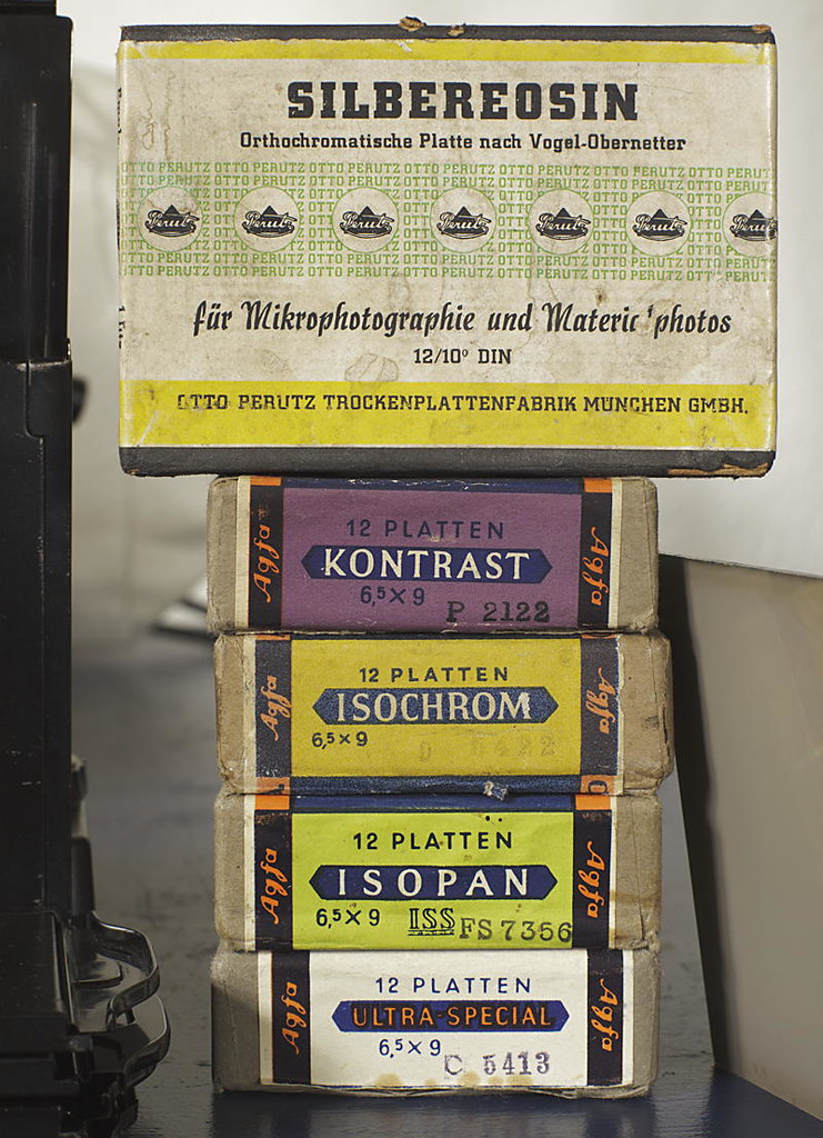

Question, if these are glass plates and not film stock is there any cellulose nitrate? Or does Platten mean film not glass?

Correct, Platten are on glass. Usually no cellulose nitrat on them, exept they are collodion plates...
Sheet film can be cellulose nitrate (Celluloid) or (later, "Safety Film") cellulose acetate or polyester.

nice article on the plates and the company.
Indeed a very good summery.
The Silbereosin plates showed even after 85 years, what a fantastic film this was. Like an ortho version of Kodak's Panatomic, maybe with thicker layers...
If I ever will try to make my own plates, something like this would be the goal.

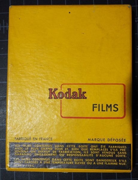

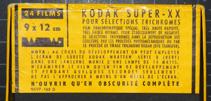

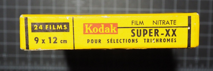

I have some Kodak Super XX nitrate 9X12 sheets. Not as old as the others posted here. These were made in France. I know they stopped making it for consumer use in the U.S. in the early 1950's, not sure when they stopped in France. Heck, I didn't even know Kodak made film in France until I got this box. This film was for Tri-Color Photography. I developed it in Kodak HC-110 Dilution B for 5 minutes with some Benzotriazole to help reduce fog. Next time I may try Rodinal.
