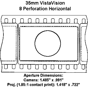

the one that still folks might relate to is VistaVison (tm) Motion Picture High Fidelity.. https://en.wikipedia.org/wiki/VistaVision
the format transports the film Horizontally like IMAX, with a Pull down of 8 Perfs, the same as our still cameras. While only a few full movies were released in VistaVision, it is relevant in Special effects like the early Star wars Movies.

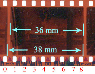

at the other end of the film format scale, the wikipedia article on 16mm film still shows this picture of three of my dogs who have sadly passed on https://en.wikipedia.org/wiki/16_mm_film#/media/File:16mmBWrevDP.png

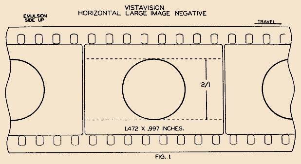

I have always thought VistaVision interesting for this reason, as it is a very similar film area to that used by our 35mm still photography cameras. Some movies recorded on VistaVision are White Christmas, To Catch a Thief, High Society, and North by Northwest.

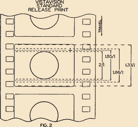

But it was very rarely projected in the original recording format, because very few places had the capability to project the horizontal "pulldown" film. It was usually made to a 35mm release print that used the standard vertical pulldown in the same format as the Academy "Wide Screen" 1.85:1 aspect ratio.
View attachment 386011View attachment 386012
Paramount suggested 2.00:1 as the largest aspect ratio that should be used, but 1.85:1 was the most used, as it made good use of the original film area and also matched a standard format on the release print. The 1.33:1 ratio was only used for television. The recording was always done with spherical lenses, but it was also possible to make an anamorphic "squeeze" print for projection with anamorphic lenses -- but a normal release print was more common.
View attachment 386014View attachment 386027
