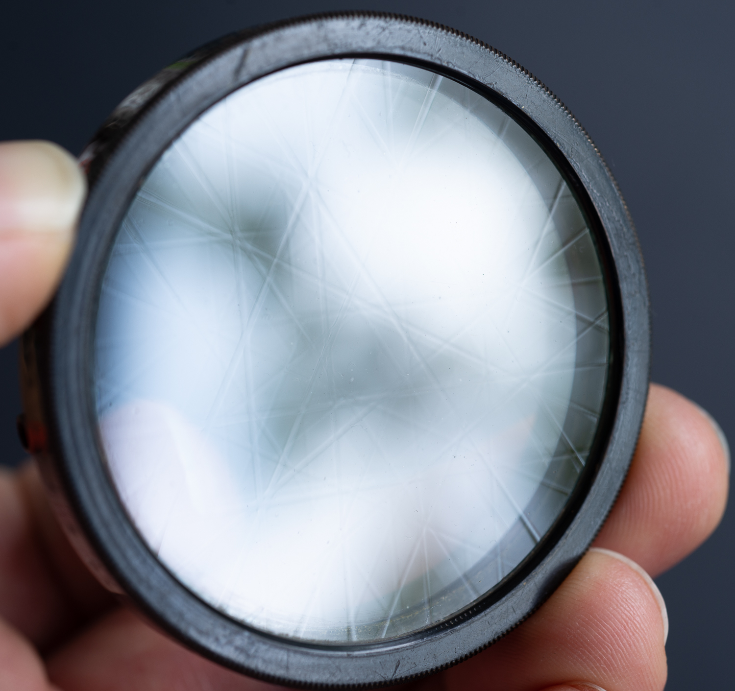

Question for people familiar with Kodak LF lenses and accessories.
Is this disc marked: No2, F4.5 for the taking lens?
Was it Kodak answer to Dutto soft filters.
Many years ago I used it to soften prints in darkroom and it produced very nice effect used for 10-20% of total exposure time. I did not keep it stationary, always with small circular motion under the lens.

Those lines (or circles on the Duto (Dulovits-Toth) one) produce one or more weak out of focus images on top of the sharp image, and that gives the softening effect. I haven't used the Kodak Diffusion Disc, but the Duto is meant to be used with large apertures, as the weak out of focus image sharpens up when you stop down. At small apertures you might even see rings on the photos...

I have one as well, a #2...
Now I have to try it out in-camera. 🤨
I too have a number two and perhaps a three in a box somewhere. Mine has a small knurled knob-screw to secure it to the enlarging lens.
The higher the number, the greater the diffusion.
