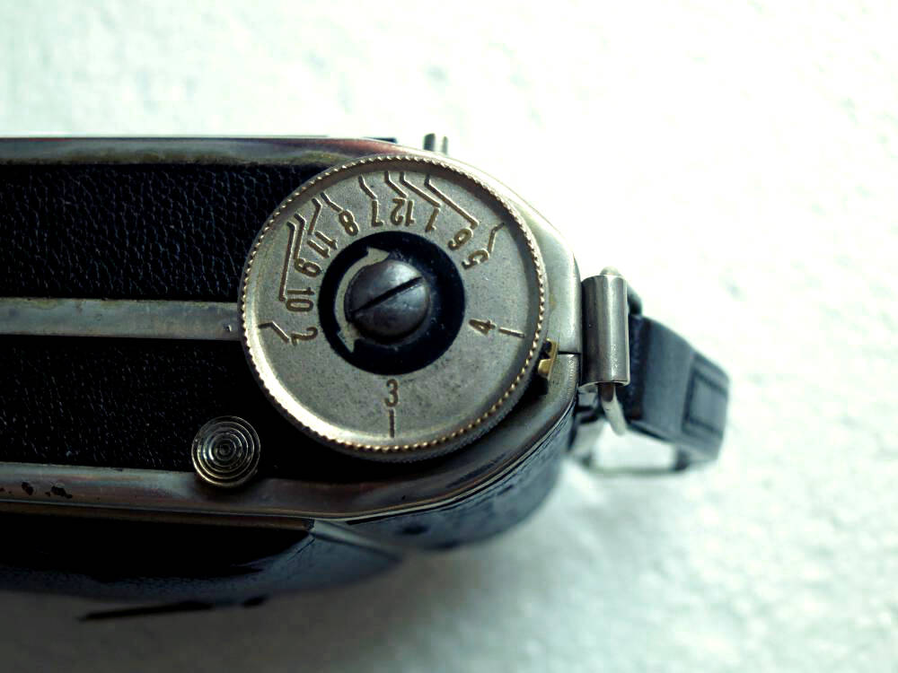

There is a better solution:
Copy the patern and transfer it to your camera. After each photo you make one full term plus the way to the next number (except 11 and 12, where it's less than a full term, the roll being thicker). Works like a charm.
See https://www.120folder.com/certo_ssd.htm
