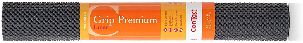

I buy rolls of rubber shelf liners at the dollar store - they are like this:
https://www.amazon.ca/Tact-Brand-No...+liner&qid=1612734275&sr=8-44&tag=googcana-20
You can use them for your paper cutter and timer as well.
No need to use any sort of adhesive.
