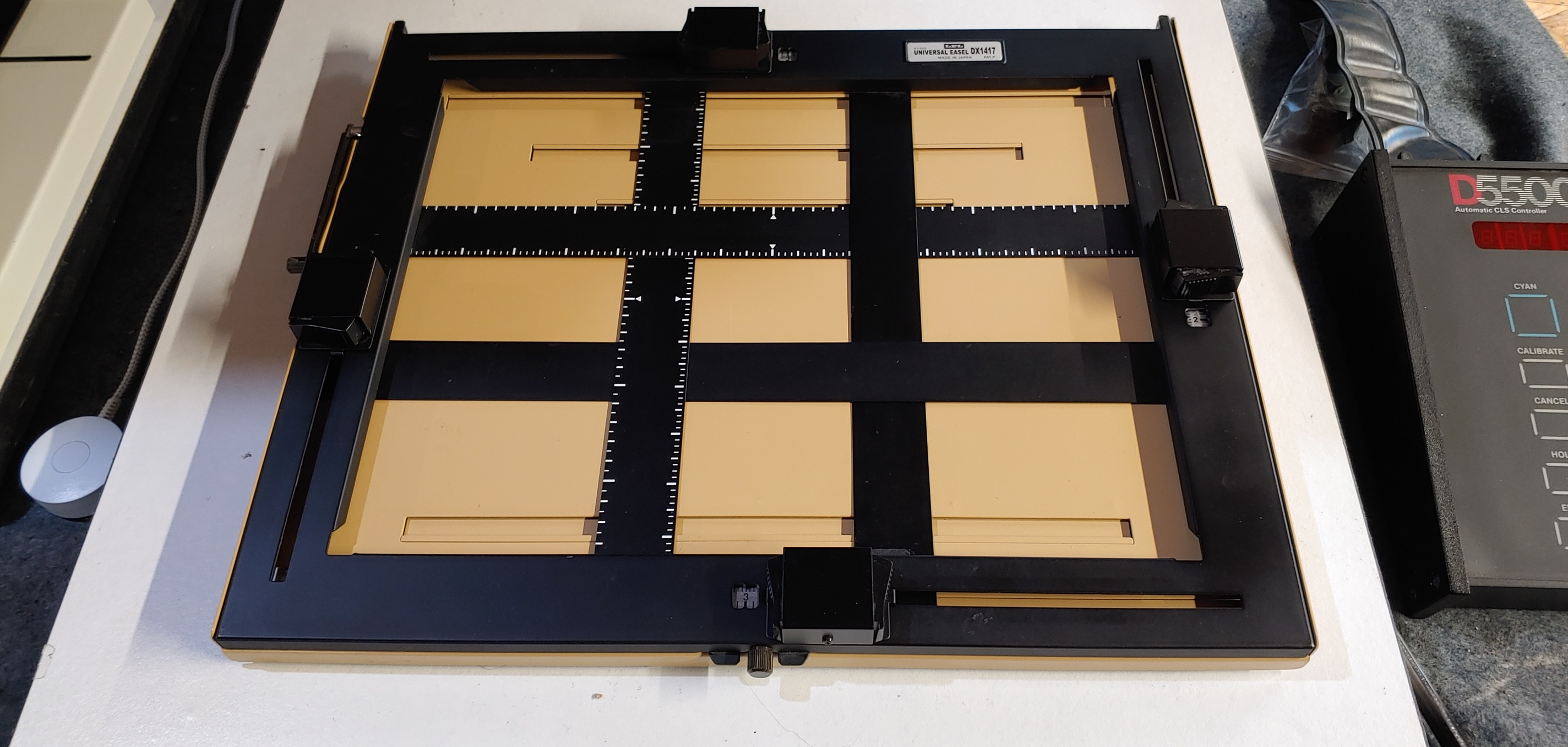

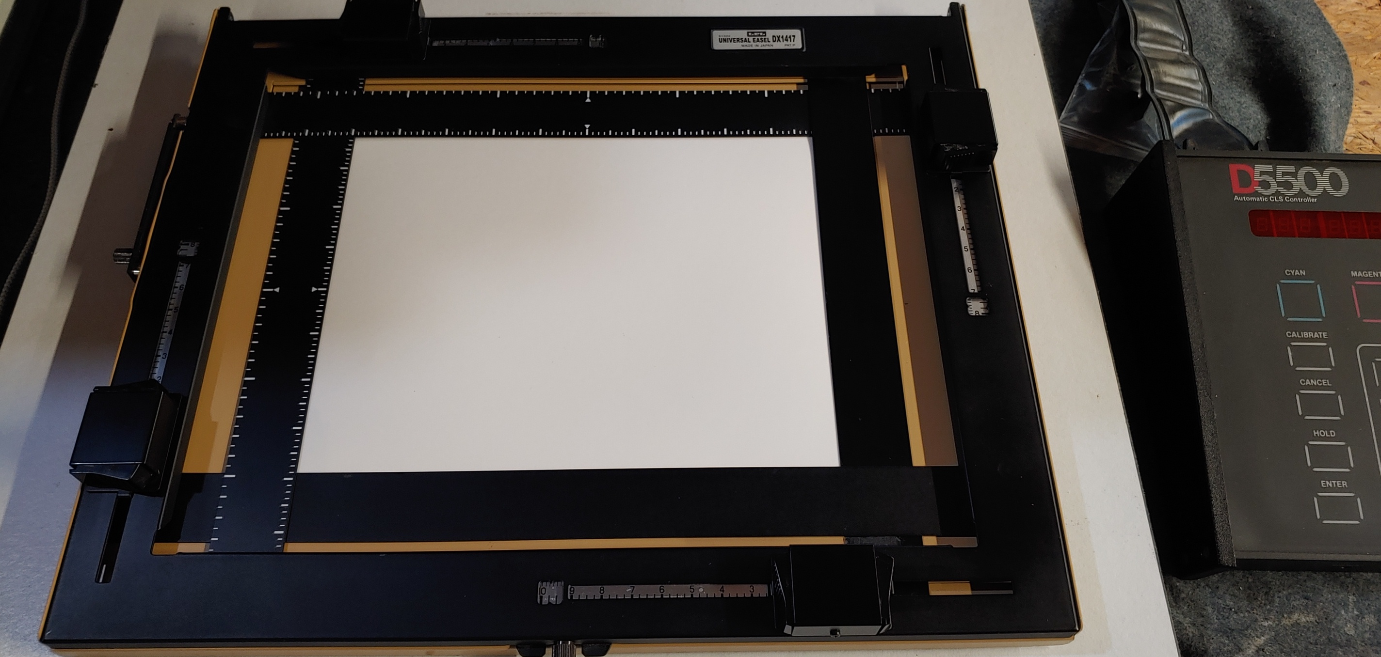

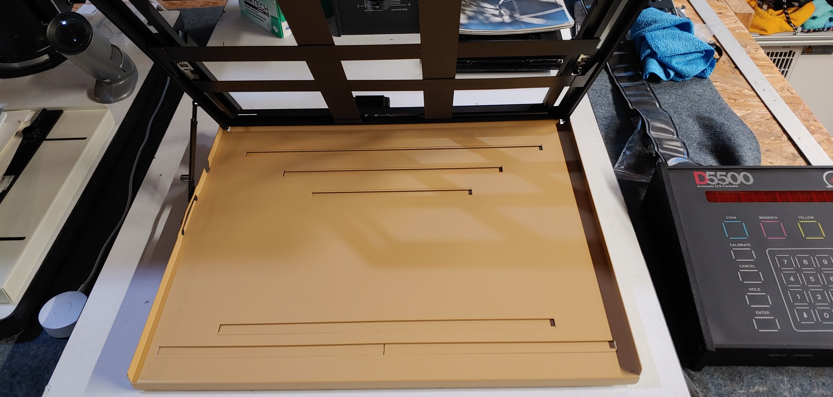

My LPL easel showed up, in near new condition. Seems to use the same method as the Saunders for doing 14x17, lift the blades and blade frame from in inner frame that is used for 14x17. Pleased with it.
View attachment 324411View attachment 324412View attachment 324413
Cool easel! A few more paper slots than my 14x17 Saunders and scales on the blades as well as the sides. I like how you can print the exact proportions and size you want almost anywhere on the sheet.
