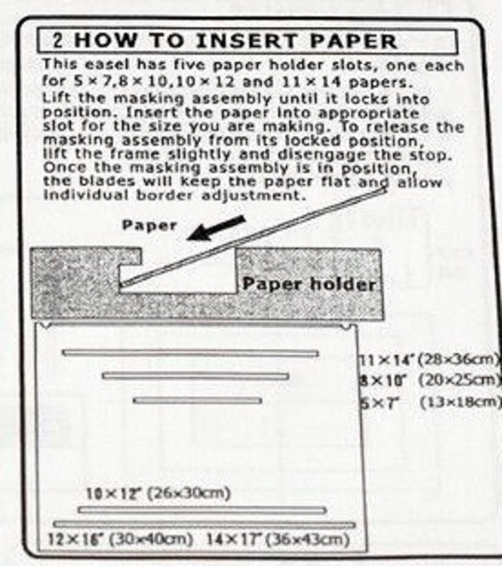

I picked up the LPL DX-1417, I think it does say 14x17 is a fixed border size, very similar to the Saunders but has a couple more paper slots.

If it has 12x16, that is a real advantage - I really like that size.
Looks like it does have a slot for 12x16.
