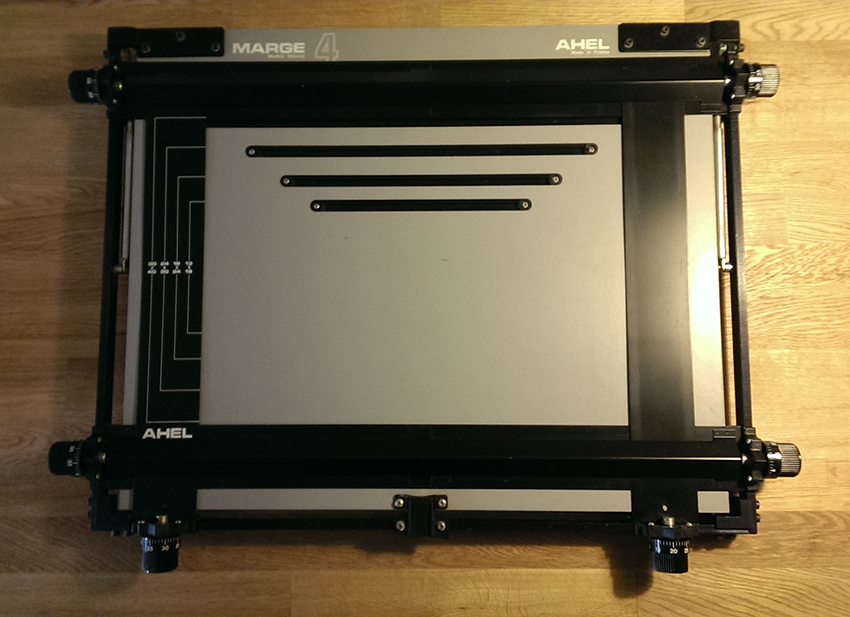

Hm, the plot thickens, I've been offered an Ahel Marge 4 for a reasonable price, it looks like this:
Has anyone got experience with this type of easel? I've been unable to find any relevant information on the internet, but it looks to be of high quality. I am unable to see any scales for setting print borders however.
It certainly looks impressive.
I would assume that the markings on the knobs would serve as scales.
Beard easels are the leicas of easels.
Never heard of Beard before this thread. Do or did they make a four blade? Shame not to have adjustable borders in two sides.
But my VT is awfully nice.
