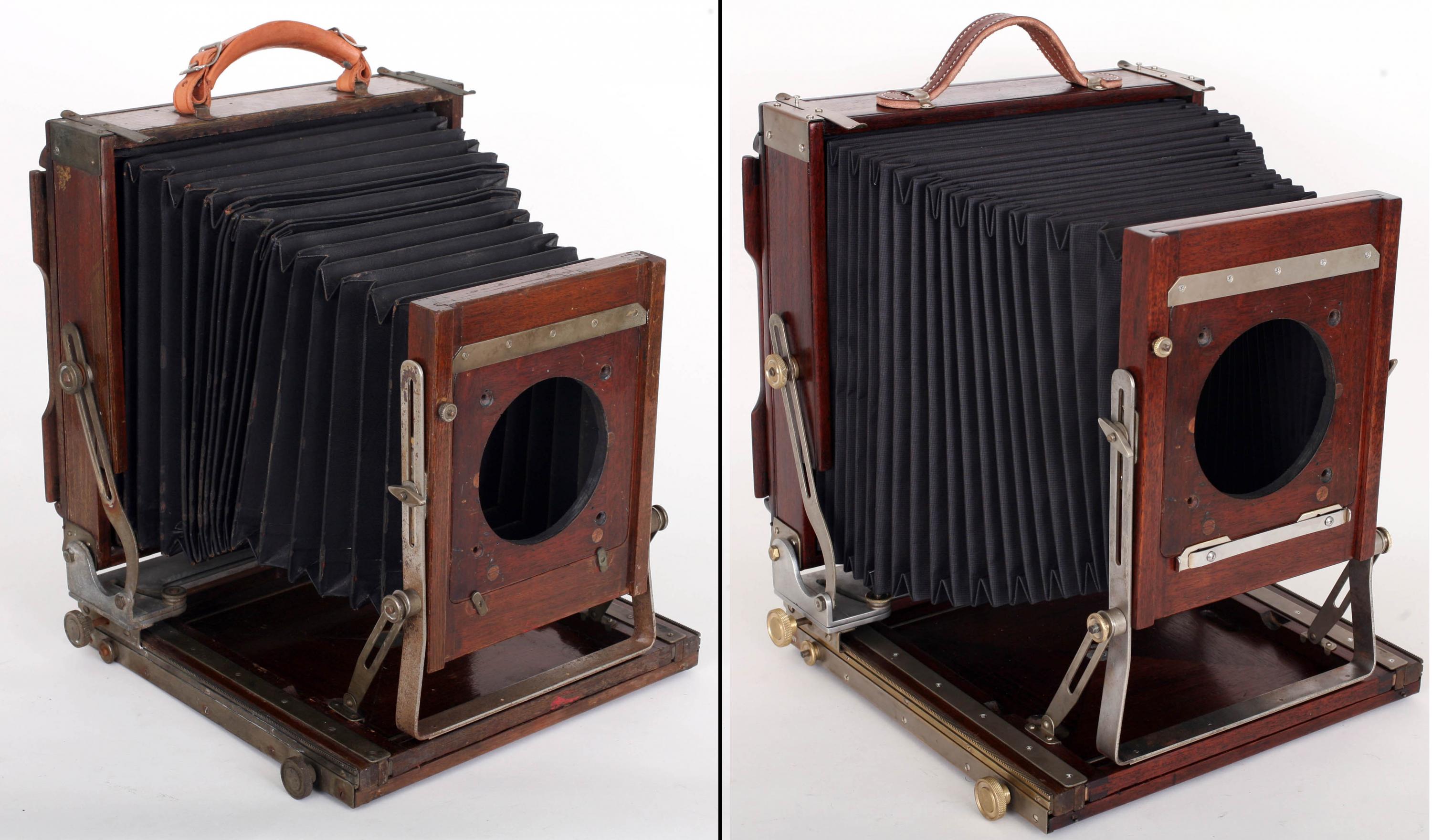

Just finished working on this early V8 dorff.
Check out the results:
Lots of photos of the whole process here:

Some of what happened:
I just finished restoring this beautiful Deardorff V8 8X10 field camera. It was a grueling process, but it was also so much fun discovering the inner workings of this beast of a camera, and finally looking at the finished camera, shiny and gleaming, ready to make some great photos once again.
The camera got to us after having spent about 30 years in a barn in Rhode Island, exposed to the elements, it had rust and corrosion everywhere, flaking off finish, and some pretty ugly bellows. Luckily, the bones were in good shape, and the amazing cherry wood this camera is made of survived quite nicely under all those coats of lacquer even after all those years of abuse.
I started by taking it all apart, which was really the hardest part, as so many of the screws were rotted through the wood, and were seized. Why would anyone use slotted screws on anything? Especially when it has to do with wood??? I used every trick in the book, but eventually got all the parts separated with zero damage.
All the wood got sanded down to its core by hand, stained, and coated with MANY layers of stain and protective coating. The original Deardorff cameras had more then 20 layers applied at the factory.
all metal parts were broken down, cleaned, soaked, brushed and polished.
With the help of a brand new bellows (made of fully waterproof and ultralight material), complete set of new screws, a new leather handle, and some other new bits, the camera was ready t be put back together. At first it seemed that taking it apart would be easier then putting it back together, but this camera is so simple, and the design is so intuitive, it went much faster then it took to break it down.
I decided to leave some of the patina this camera had, and left most of the metal hardware with their blemishes (as long as they did not interfere with using the camera). The result speaks for itself - a restored camera with a feel and look of a well cared for and age hardened piece of history.
The final result is phenomenal. It is really a thing of beauty, and such a joy to open and close. The movements are buttery smooth as Deardorffs usually are and the shiny knobs and and finish are a pleasure to use.
Nice job, it looks fantastic! I'd be proud too.
Back then they used standard slotted screws for everything. I've dealt with them myself plenty of times so I feel your pain. :smile:
Beautiful job!.

Nice camera, and good work getting buttery smooth movements. That is not a given, or always an easy thing to fix, with a camera in rough condition.
I understand your point about the screws, but like the slotted screws in such an old fashioned looking camera. Fred Picker bad mouthed them no end for using wood screws at all and ranted about the numerous problems that resulted, none of which ever bothered me.

The gold is actually the brass hardware, which was originally nickel plated. The plating on those parts had either completely eroded, or was so badly oxidized it just came off with the lightest brushing... I figured it would be nicer to have a shiny clean look where i can. Replating the whole thing would have been nicer, but that would also be totally out of my league...
BTW - camera was just sold.
