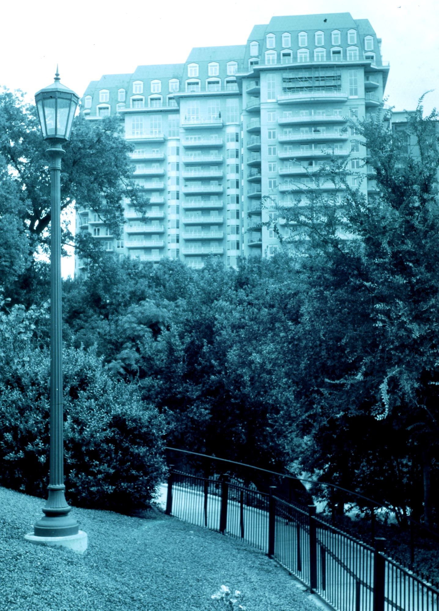

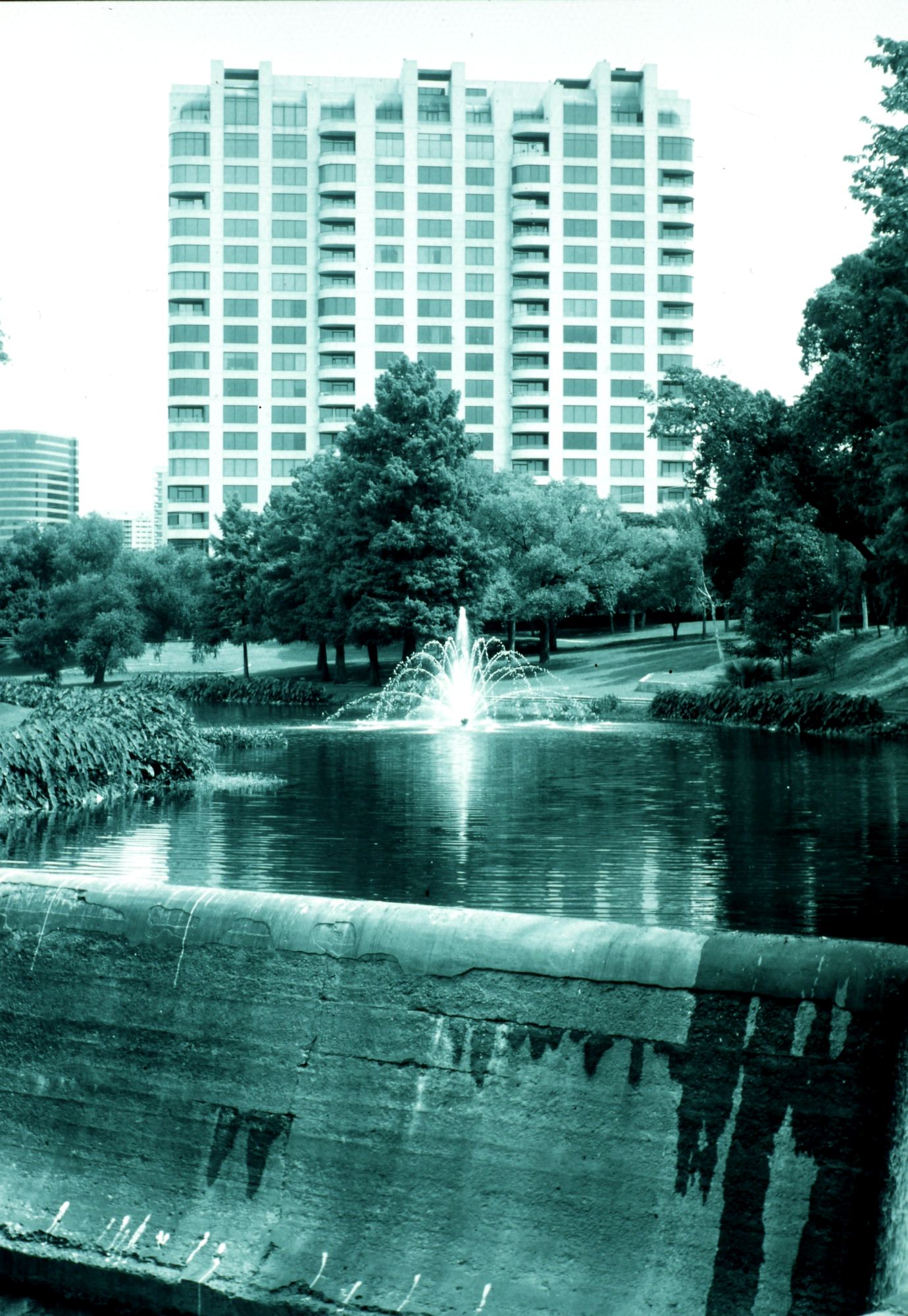

I've had XP2 cross processed in E-6. It was back in the 90s, but the (pro) lab didn't blink at it. The slides had a greenish tint, were a bit contrasty, but OK. These days if I wanted B/W slides, I would probably go either the DR5 route or home processing.
I just tried this with a roll of XP2 that was lying around and the Tetenal kit. The result definitely has a green tint, but it is actually kind of nice. It is reminiscent of when they would put a color filter over a B&W film to make it more "lively".
The roll was shot with my OM-4T to make sure the exposure was dead on. But the resulting positives were quite dark. More than one stop, closer to two. One reason is probably the first developer, as this was the tenth roll in this mix. The development time was extended but probably not enough. It may be necessary to adjust the exposure also. Anyway, I ordered a few more rolls and will try again with a new batch of chemicals.

Having tried several times now, the solution with XP2 appears to be both overexpose and overdevelop. Overexposing by one stop and overdeveloping by 25% (first developer) gives excellent results. A slight greenish blue cast, but actually quite nice.
I'll post some samples when I get a chance, but right now all the cameras are on tripods mounted with telescopic lenses with solar filters. Praying for a clear day for the eclipse.
Here ya go. As with everything reproduced d!&!+@||y, the originals have a lot more "punch".
