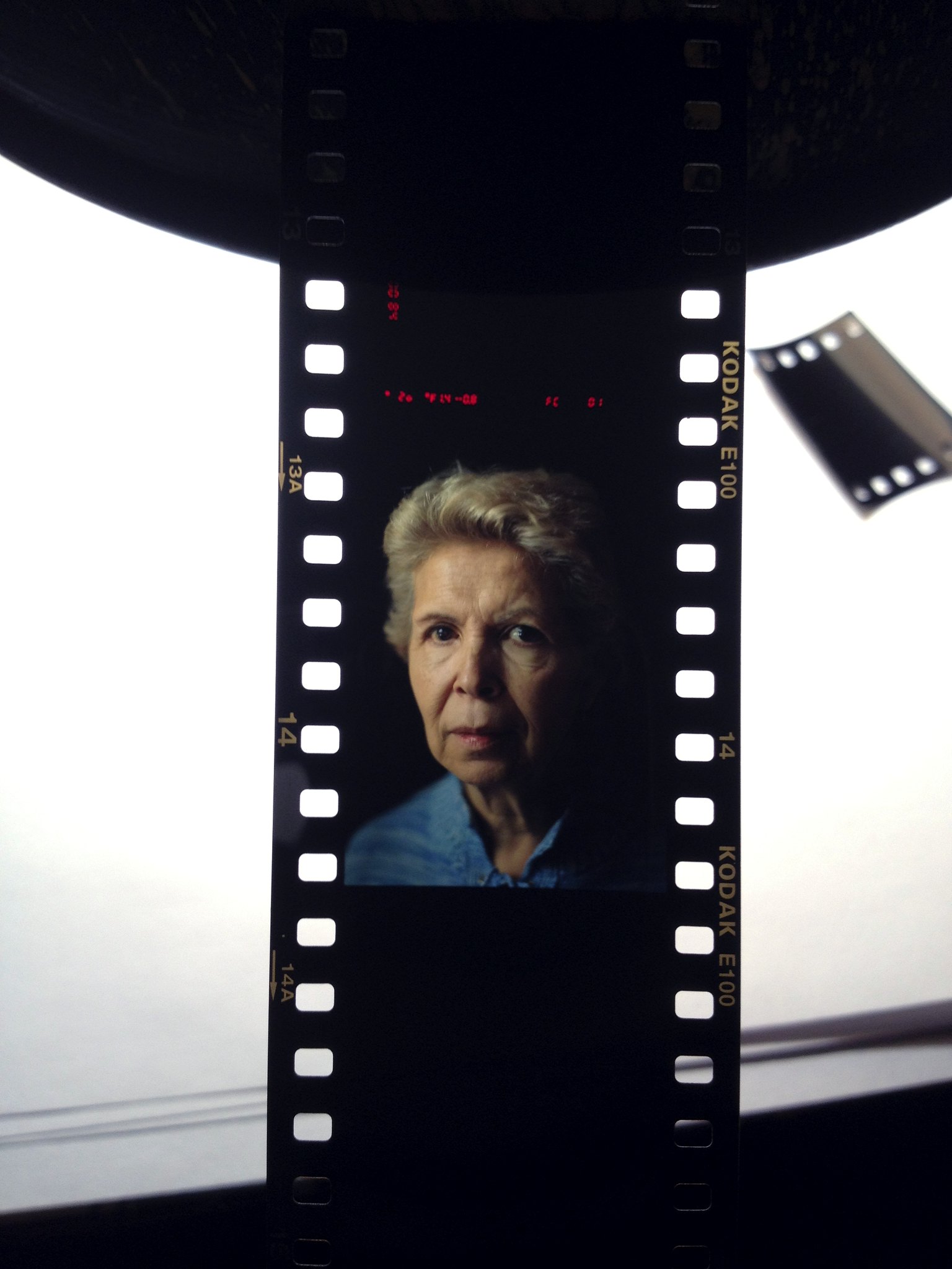

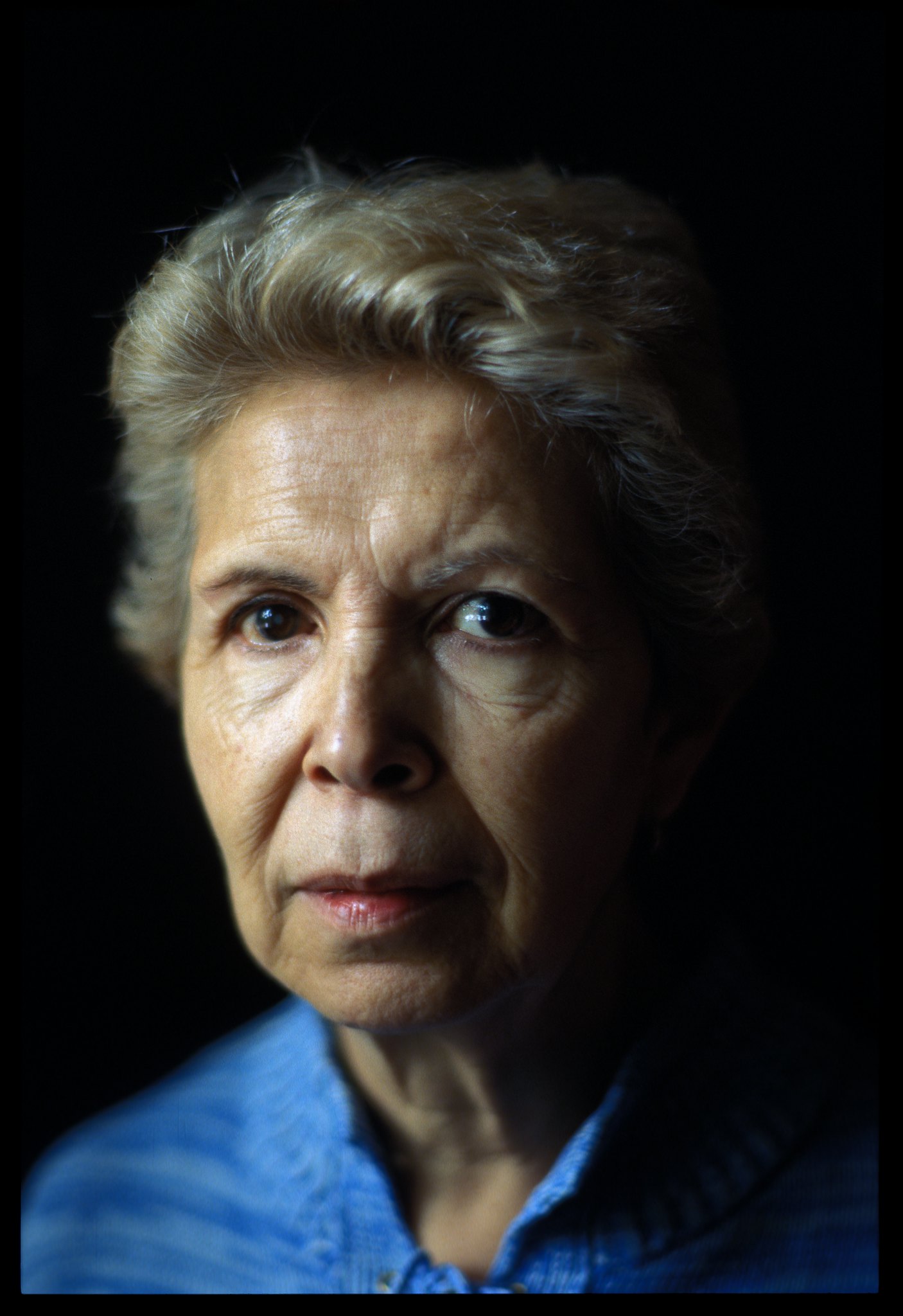

I found this example on Flickr (2 pix below), and something like this is my goal. So, to have to do almost nothing in post pro after development.
(I don't know how this pic was developed by the way, i sent the guy a message, hoping for a reply.)

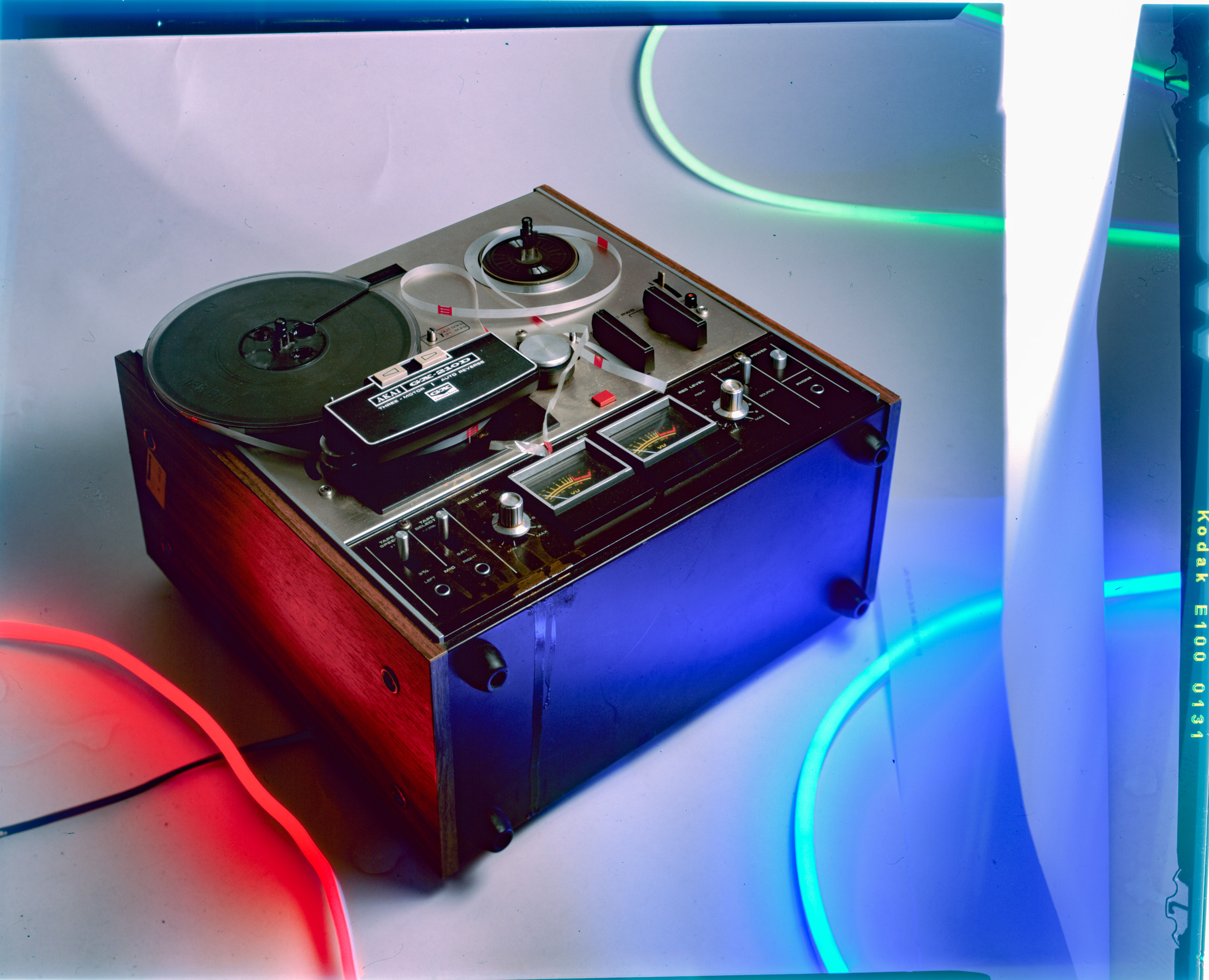

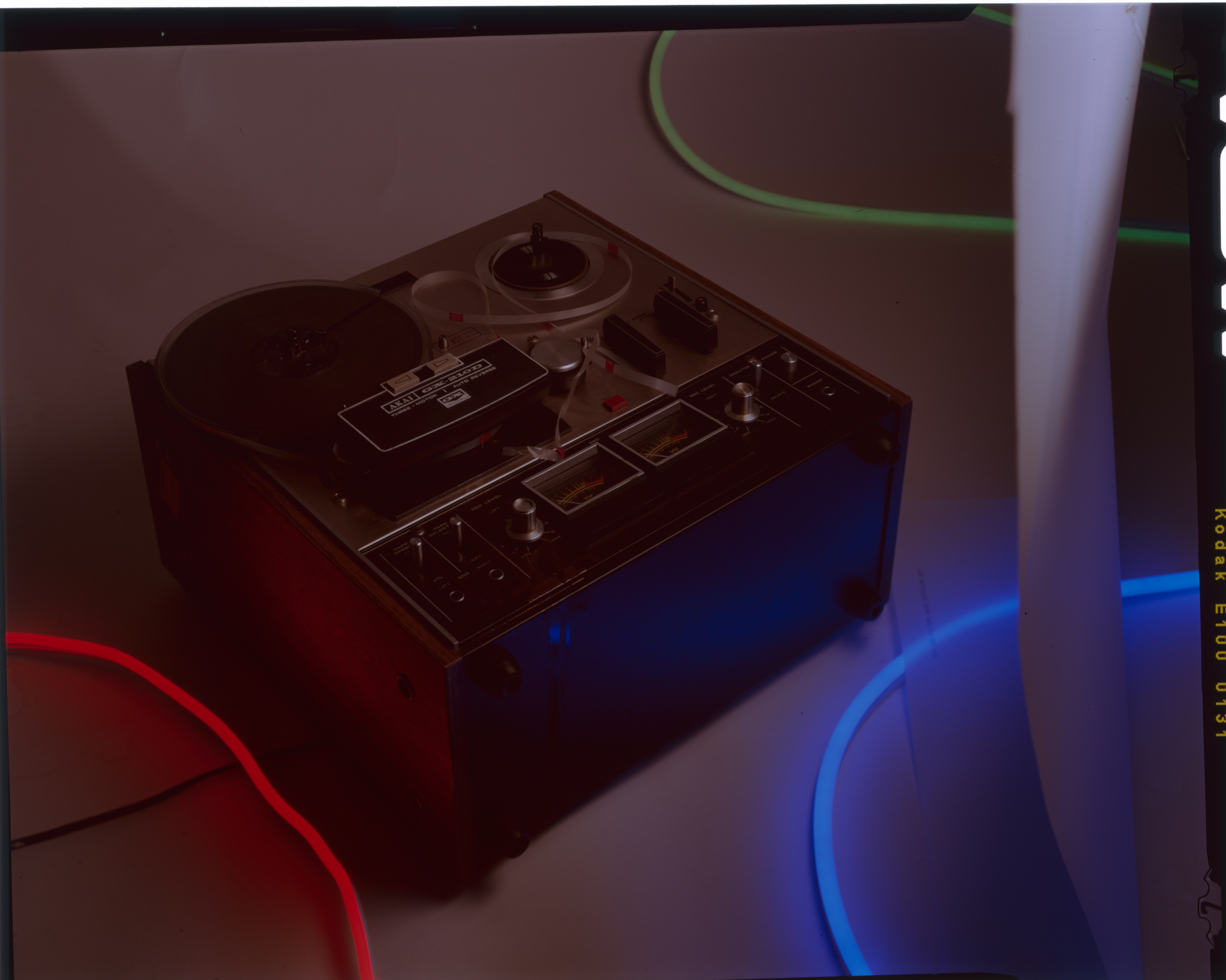

Here below are my before and after pix. This is just a test shot, it's not supposed to be something special. The first pic is the straight scan and that's pretty much what the pic looks like on the light box, perhaps a bit darker. Obviously it's underexposed, but it also has a pretty extreme color cast.
Doesn't look too bad to be honest. The lighting is of course a little eccentric, so I'm not surprised you end up with something not entirely neutral. It seems mostly underexposed, which may be actual underexposure or it may be insufficient development in the first developer. If this is expired film, a color cast (you seem to have a magenta cast mostly) can also result from this. If it's fresh film, then I'd suggest that something didn't work out as intended in the first developer step.
PS: how did you process these? Trays? Jobo processor? Stearman press tank? Something else? How did you control temperature? What kind of agitation did you use? Especially the first developer is a critical step in all this.

Yes, i chose tricky / weird lighting on purpose, with the idea that if i can nail this shot, most other studio shots should be possible.

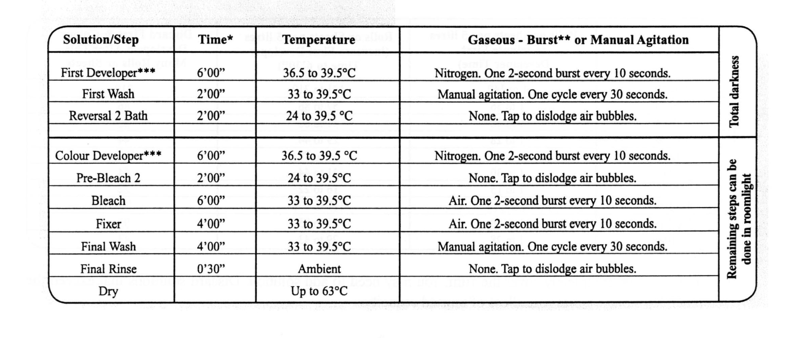

Here is a screenshot of the temperatures (below).
I'm curious why there is temperature latitude listed. Why don't they just (or at least also) quote the optimal temperature? I mention this because if you can just do every step at say 38°, then even though it's 9 steps, it's not too bad as you can keep everything at the same temperature.
Cinestill requires some different temperatures, which makes it tricky in terms of pre-heating chemicals and preparing water.
Cinestill is 3 steps, one has to conclude their cutting corners somewhere?!
The price isn't too bad, in fact i think it's cheaper than using Cinestill!
If i understand the list below, nitrogen agitation is mandatory in two of the steps?
I don't know either. Like I said, I wouldn't rely on that old document. The more recent one I linked to above is more specific.
You're starting to catch on why I'm a bit hesitant to recommend their E6 kit. Btw, in C41 they also cut corners in ways that aren't guaranteed to give optimal results in the long run.
Not really, but that's how big labs do it n dip & dunk and continuous transport machines. Other modes of agitation are OK too, such as a Jobo rotary processor.
The table you dug up is an odd mixture of instructions for big labs and small tank processing. It's just plain weird to be honest.

Your image looks underexposed and (possibly) underdeveloped in the first developer. The underdevelopment may be the result of insufficient rotation. I suggest constantly rotating the film during all steps. Also, distilled water for developers is to the resque. Tetenal and Bellini are two E-6 kits of choice for myself. One absolutely must wash the film in running water in between processing steps. I hope, this helps, but, when you decide to undertake transparencies, you'll need to either invest into best flashmeters, or to have an OTF (off the film) measurement in you camera. My first experience with transparencies gave me some 20-25 correctly exposed frames out of 6 (!) 36-exposure films. Since that time, I never rely on myself, when shooting slides.

As you can see with my second shot, it's possible to get passable results using Cinestill, but you need to jump through some hoops afterwards. I guess it makes sense. Why does commercial E6 processing need 7 steps, and Cinestill only 3? There must be a compromise somewhere.
