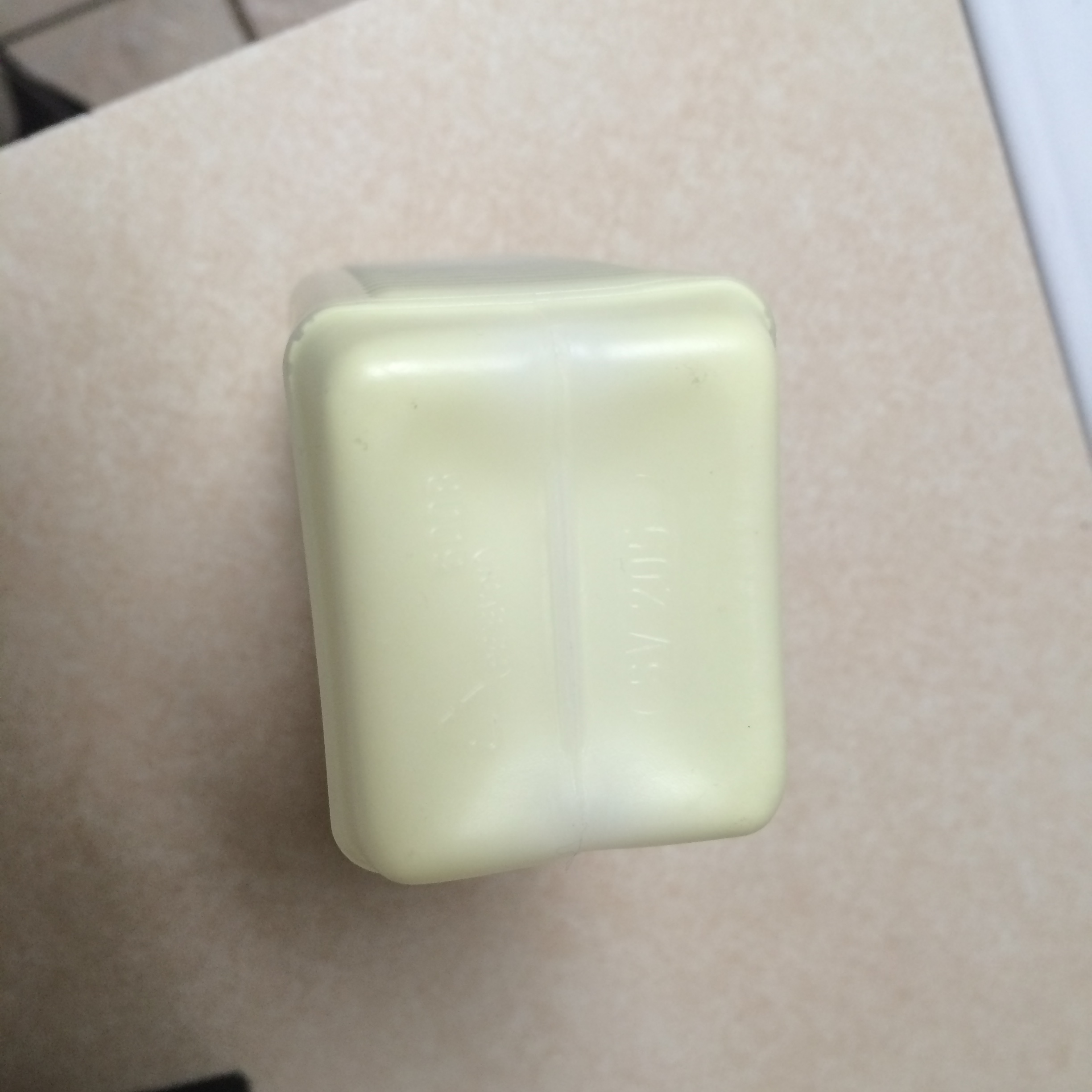

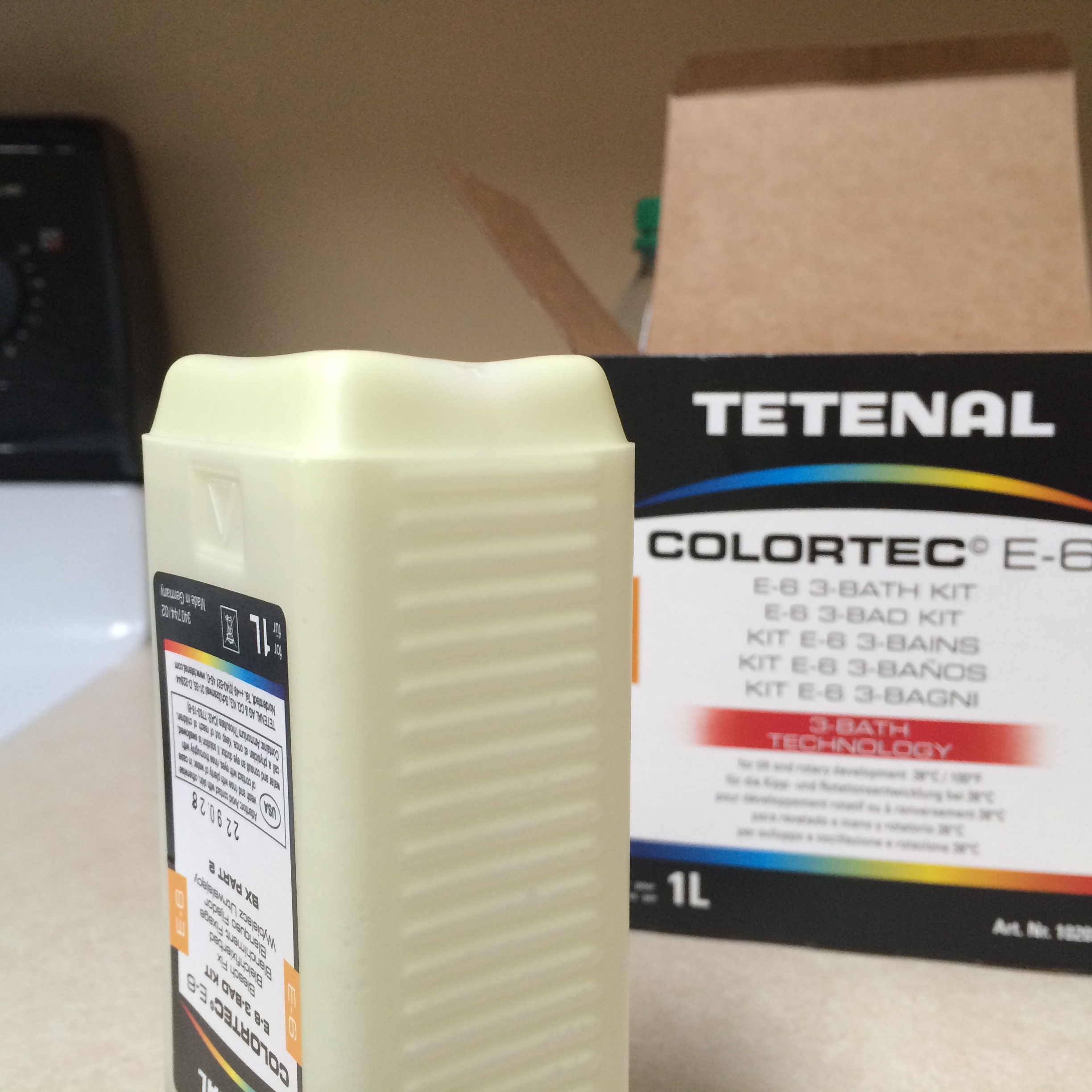

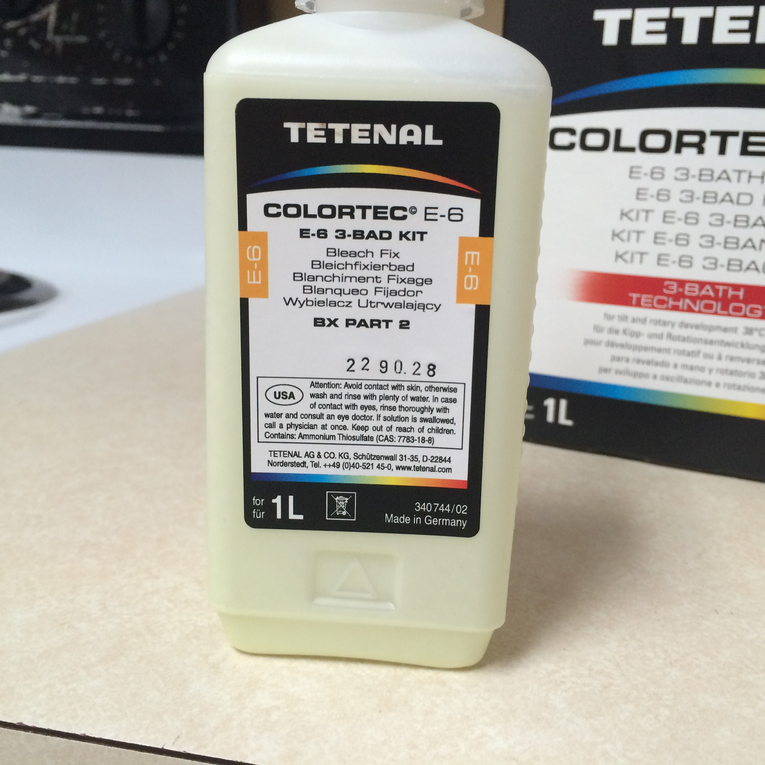

I bought a 1 ltr. E-6 Tetenal Kit from Freestyle a few months ago. I finally opened it tonight because I am ready to process my 12 rolls. But when I looked at the Blix-Fix Part 2 , (fixer) of the kit, it seemes to me like there is yellowish-greenish deposit on the bottom or around the bottle. This is my first time processing E-6 so I don't know if this is normal or I have a bad bottle of fixer. I hope the whole kit is not bad . How do I know this is good, or bad ? I am going to try attach pictures but I don't know if you can really tell by the pictures. I am worried that I wasted $80 if I cannot use this fixer ?
if it is in fact bad. ? what do I do ? can I do something about it to make this work correctly ? I do have C-41 fixer or even RA-4 fixer but now I am talking crazy.

From the MSDS for part 2 this concentrate contains an acidified solution of ammonium thiosulfate. This potion of the blix is responsible for fixing the film. The yellow color is from sulfur deposition. The solution has gone bad and can no longer be used. Acid solutions of thiosulfates are unstable. When you purchase a kit of this type it should be done just before use. The longer the concentrate stands the greater chance of this problem occurring. Contact the seller to see if you can return the kit and get a fresh one. The kit should be stored in a cool but not cold place. Heat only hastens the decomposition.
