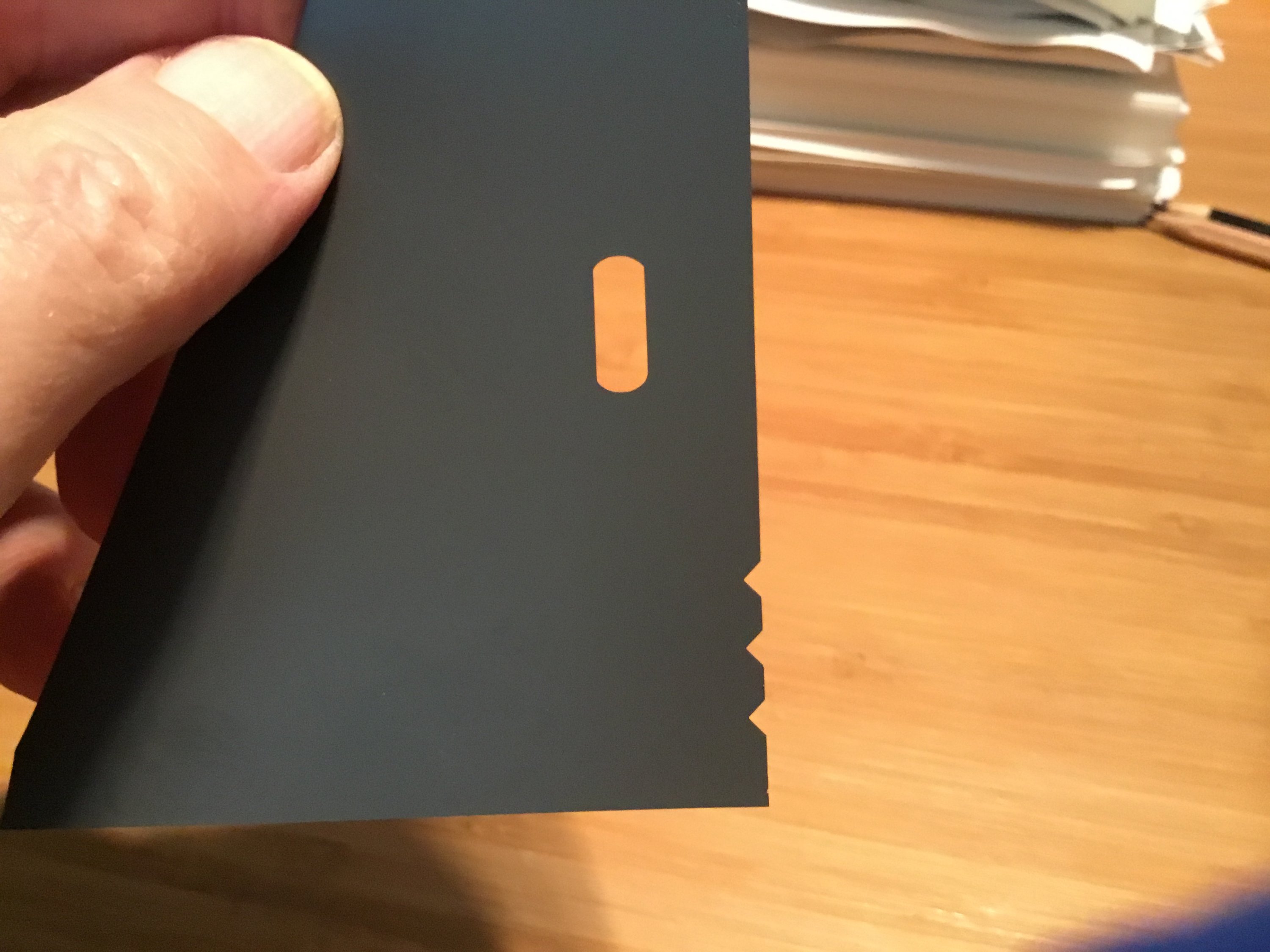

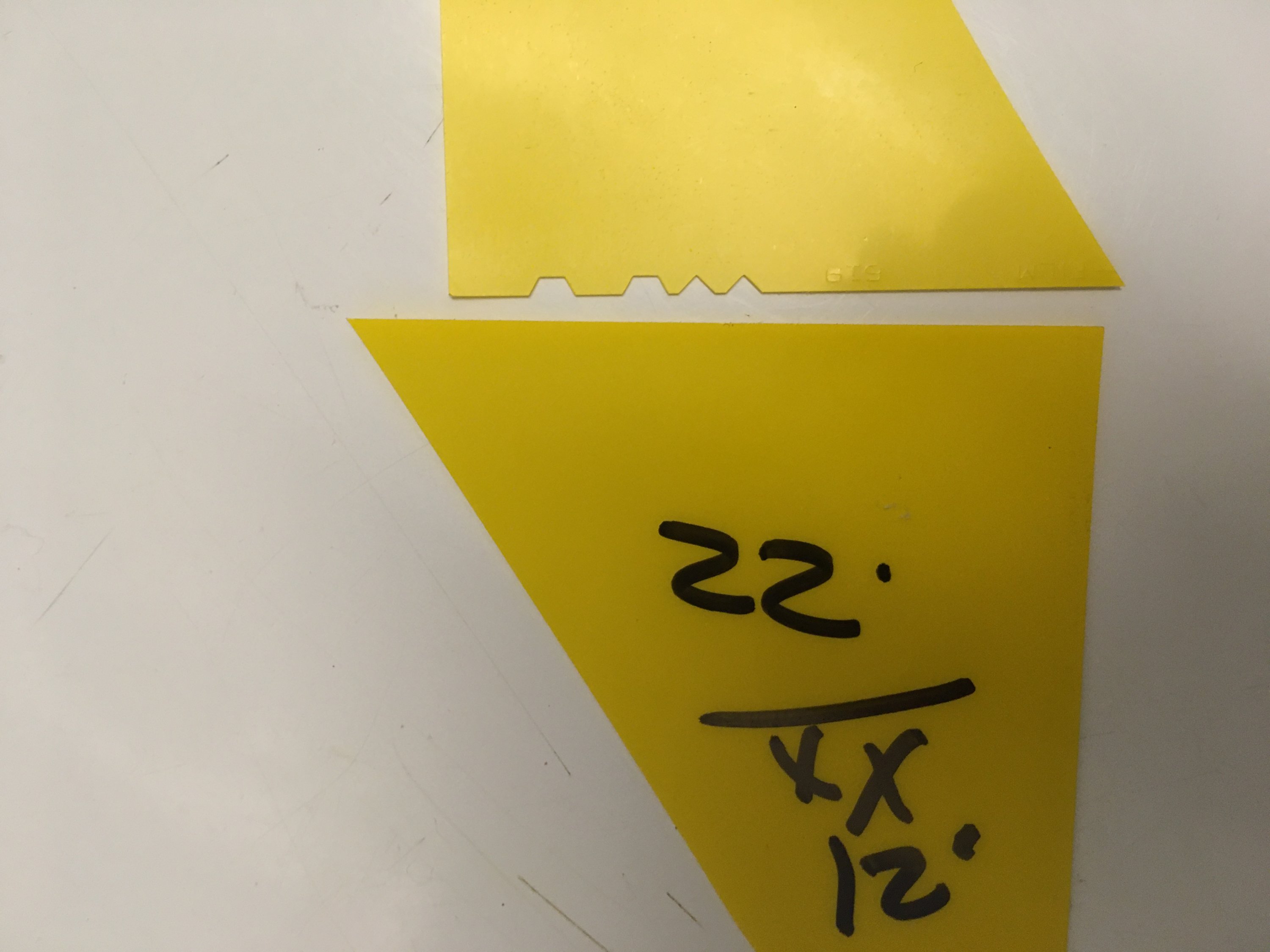

Kodak ortho matrix in condenser enlargers was often exposed using W35 filters. the 34A is a narrower 35. @lachlan, you mention two distinct filters: 38a, 34a. One was used in drop filter shutters.
View attachment 284063 View attachment 284064
If by 'drop shutter' you mean the Harris shutter effect, yes that seems to have been the main use for the #38a outside of scientific work. The use of the #29/#34a was suggested for making Pan-Matrix sets with 1950s cold cathodes (likely somewhere in the 6000-10000K range from those I've encountered) - though there was a story I encountered of someone (Bob Pace?) who had apparently had an RGB additive cold cathode set of lamps (for sequential exposure I think, though I'd need to look up the reference) made.

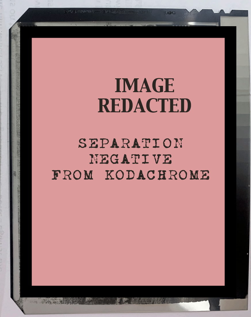

for those curious without experience; this is a redacted separation negative. If you read the edges closely, you will know much about the actual neg. Note what is on the edges AND more importantly, what ISN't there.
it was rare that this person used the step scale you see; everything else is common over many years.

@sasah zib If SOP's were followed, that looks like a blue sep on Royal Ortho (if the context of the text on the film defines the era correctly - I've seen the notch code for 4135 Gravure Positive reused on 100TMX, so I'm always wary about notch codes), looks like punched for register with small pins. Did Royal Ortho offer advantages in terms of contrast/ curve behaviour when processed to the needed CI - or was it more for compatibility with something like Tri-X when used to make separations? Either way, if it did the job & got things close enough to be easily adjusted at the assembly step, that's all that really matters with any of the colour assembly processes, be they ink, dye or whatever.
The transparency also looks like it hasn't been frisketed into a bigger piece of film, nor masked down in outline with anything other than the metalwork of the carrier used (fluid mount carrier? looks like there is further pin-reg within that carrier too).

-lachlan : this worker followed Kodak precisely. it is a blue sep; not ortho film .. code notch tells age as well .
NO pins. (cips on hangars for souping) He used the same marking for his mats so seps and mats matched during work. Used standard Omega D equipment. I prefer to use 'notch' side for seps/masks . if you follow strict enough solo practice you can get by with 'location' notch to ID films.
-- aside note: there was a time when GLASS plates were used. there was a time when film would split with small punches;would deform; wouldn't go off and on pins several times; 5 degrees RH change was a problem not readily solved -- the process matured under such circumstances.
